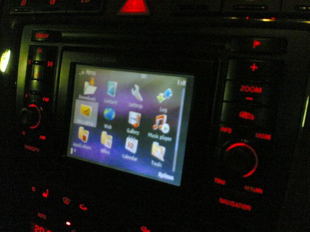

n95 output is pretty good on rns-d,i have it running tom tom from an n95,the otheraux input i have linked to a mini pc
ID:	421   Click image for larger version
What mini pc do you use?
hp e-pc,with a modified version of xp to boot quickly
