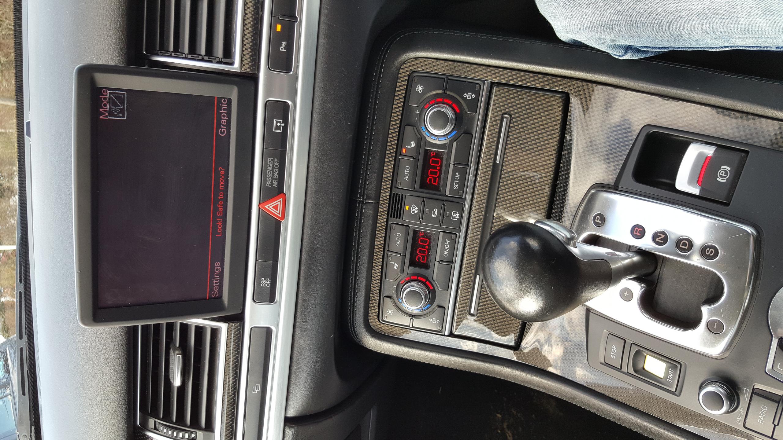

Picture for reference when rear view camera is selected on its own.
Old 10th March 2016, 09:10 AM
Posts: 1,669
You need to get a scan with VCDS.
Have you ever seen it work?
I see there are no guide lines, so it knows it is faulty.
The module is behind the left side boot trim just behind the rear seat but I don't think it's worth checking connectors as they lock in.
