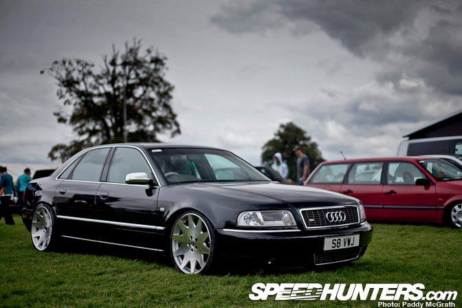

Old 12th May 2016, 10:25 AM
Staggered wheels have a deeper dish at the rear which often looks more visually appealing
