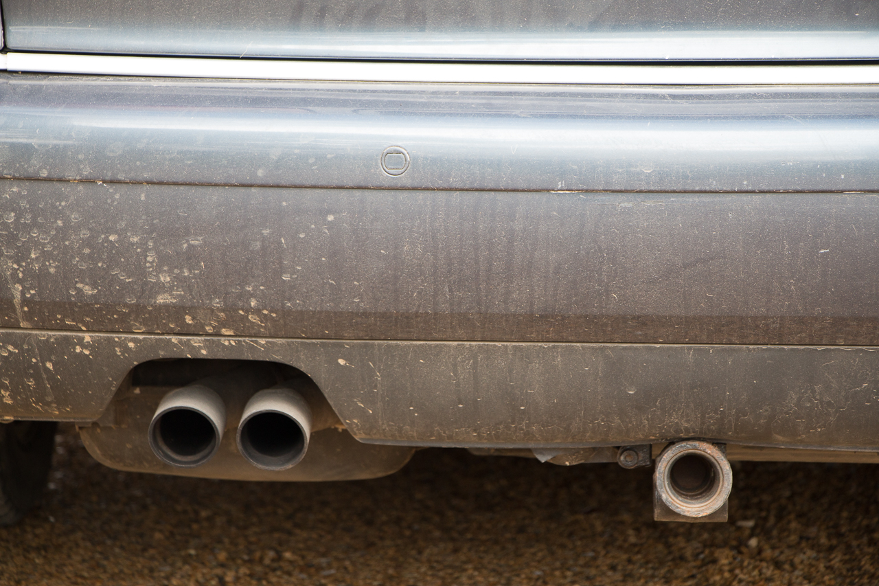

Do you have any pictures of it fitted please? Can you see the hardware when the swan-neck is removed?
Could take one for you when the rain stops. It sits roughly three inches below the base of the bumper, so it's pretty low. I just have to go slowly up the up ramp in my local multi-story, so it doesn't scrape.
Edit: Photos attached. Please excuse the dirt. Getting rid of 7 tons of concrete and bricks three weeks ago plus tearing a ligament in my back means no washing the car... and the muddy lane doesn't help

frankly I wouldn't buy anything as low as the one shown by steamship, the audi bar is at a height that requires a bumper cut out is not just because of the fitting on the bar he shows scraping with the ball removed but because even with the audi bumper cut out one my trailer touches quite easily

Curious as to why you consider it low, when the exhaust is obviously lower.
I've also read the rest of your statement, but can't figure out what you're trying to say with regards to my bumper and an Audi bumper.
