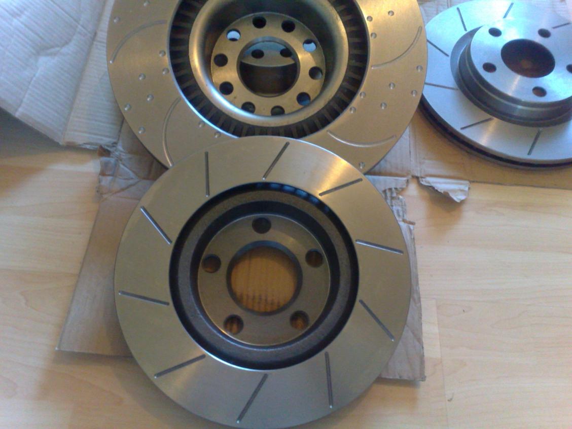

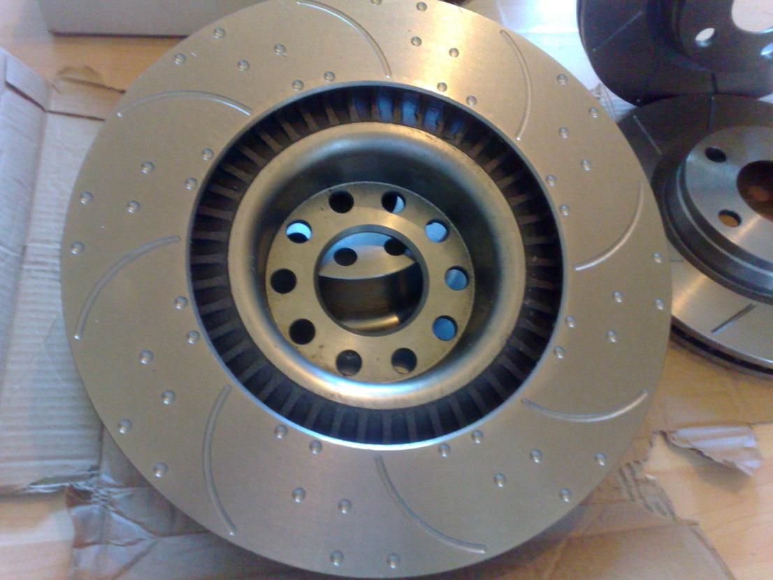

on recent trip to germany it became apparent that my brakes were not as good as they should be. during the trip and on a few occasions since then the car has had some bad brake fade. so i have now decided to get some new disks. on the front i have gone for ebc vented grooved and dimpled with ebc yellowstuff pads. on the rear i have gone for vented and grooved discs with yellowstuff pads. also a new fluid change with brembo lcf600 brake fluid. hopefully this will cure the problem of brake fade or i will just have to drive a bit slower

Nice - bet not cheap though

After speaking with you the other week I have now experienced some brake fade on my A8 with the same set up. It appears that the problems are to do with cooling more than the pads as such, if you get them very hot they can take a while to cool down so next time you brake they can fade a bit. You might want to consider some better ducting if its a real issue for you as we have seen how effective that is on the track car, and what a difference it made when one of the ducts became partly blocked.

the ebc vented discs are supposed to have better cooling so i am hopeing that these do some good. also both front and rear are grooved to allow gas to escape. its got to be better than my standard discs. i will just see how it goes when they are fitted. as for price andy i paid 170 for the front and 65 for the rear delivered.
Thanks for that - are they ones off of Ebay?

the rear ones are off ebay and the fronts i got from a to z motor factors in dewsbury.
