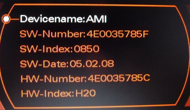

I'm not sure what version my AMI is.
The 'Red Menu' is a useful general diagnostic for the MMI and its attached devices and shows ALL the connected units with their MMI BUS ID and Hardware [HW] and Software [SW] versions (with dates).
With the MMI started, you need to press and hold 'Setup' and while continuing to hold 'Setup' press 'Return' as well. After about 5 secs, the Red menu appears and list all the car's devices. Scroll down to the AMI [see 0 Config-b]and press the big button and you'll get a screen of info [see 8 AMI].

Finally checked the red menu on my AMI and its at 0850 already.
Could be a faulty cable.
