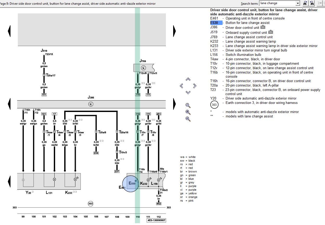

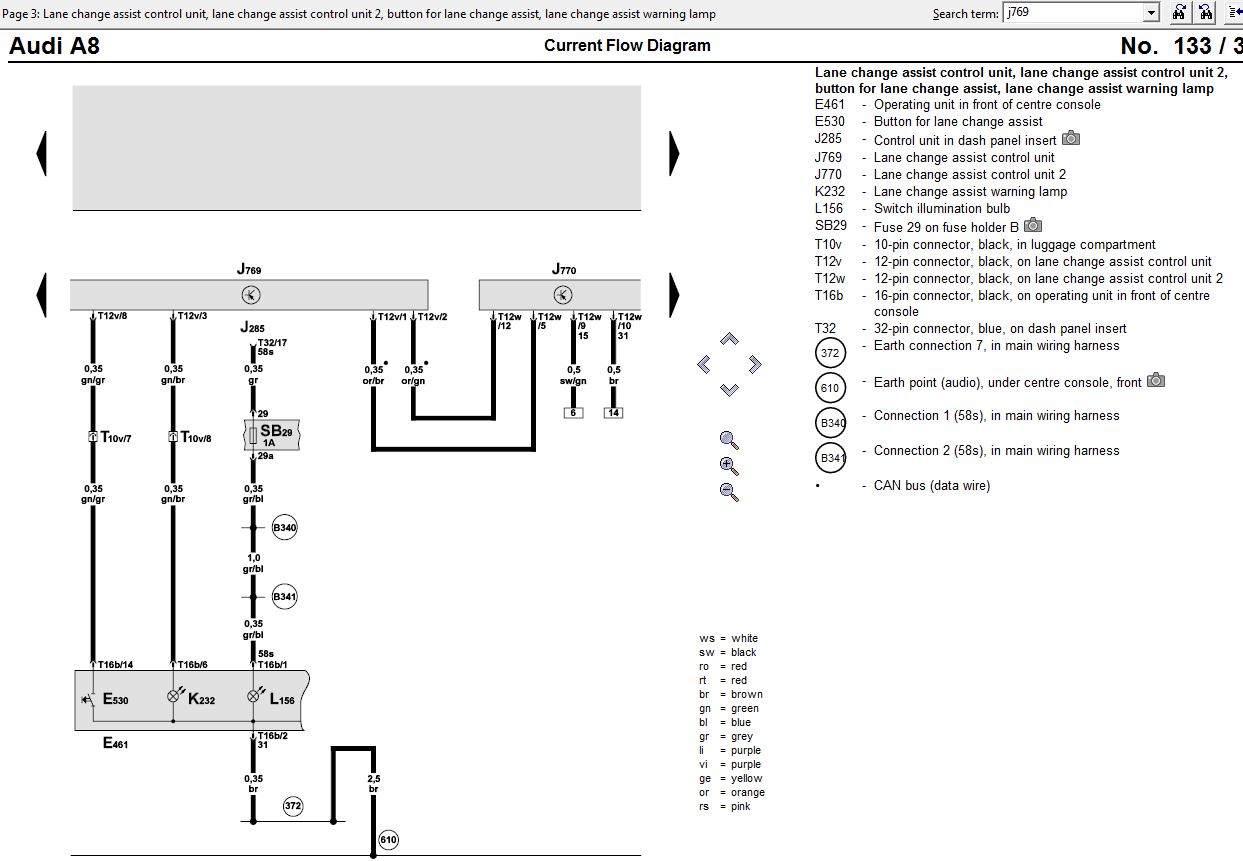

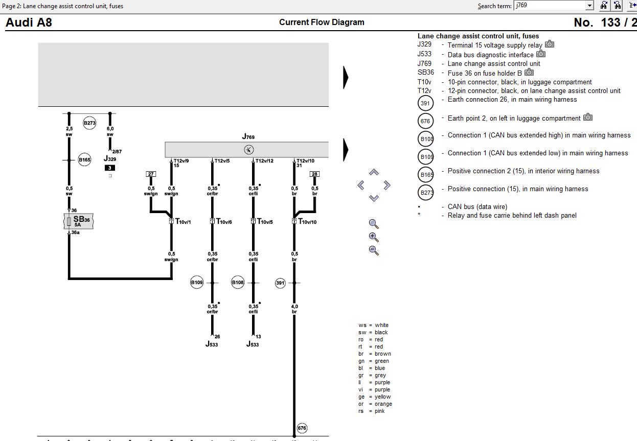

Old 28th February 2017, 05:46 PM
It turns out I'm only allowed to watch so we are in the study, she is playing and I'm back
Will have a look now where the J769 and J770 are.
ID:	15795   Click image for larger version
ID:	15796   Click image for larger version
