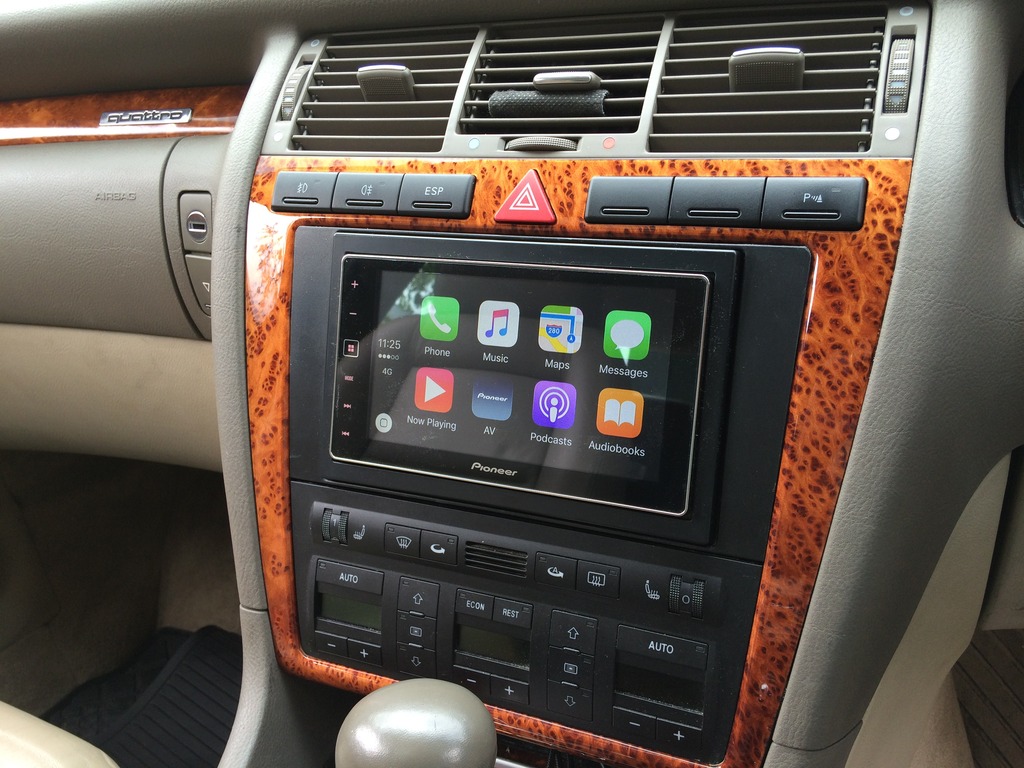

I have a stock set-up at the moment, including Bose sound / 6 disc changer / boot 6 disc changer. Being a facelift model, I appear to have a 'separate' area for audio and heating / AC controls, so I expected it'd be a simple case of taking the standard unit out, finding a fascia, and plumbing in a double-din unit.
Some threads from 2013 and older seem to show successful mountings of double-din units, but appear to gloss over the fact that there isn't an off-the-shelf fascia or fitting kit for a D2 - which seems to be the only conclusion I can make!?
I've attached an example of the kind of thing I'm aiming for (lifted from a different forum) - it's a Pioneer unit and I think it looks wonderfully OEM+, well fitted and modern. Trouble is, I can't figure out how this has been achieved given the seeming non-existence of parts required!
Any ideas folks?

That's my head unit you've got a picture of from the Edition 38 forum. I sent you you a PM but also recognised your user name from here too
Here is a link to the fascia I purchased
http://www.caraudiodirect.co.uk/inst...plate-for-audi
You have to trim down the upper parts of the fascia to allow it to fit properly - most car audio shops should be able to do this.
You will need a Bose harness to get the stereo to work with the built in Bose amp - again, most car audio shops will be able to advise you on this.

David'S8 - thanks but I somewhat prematurely purchased the Pioneer unit you see in the attachment in my first post! It just looks so good, and will suit my needs perfectly.
Ricky D - thanks for picking this one up
Not only am I jealous of your S8, but the head unit you're running encouraged me to do the same - it's factory fresh!
I thought that was the case - since I don't readily have the tools to cleanly trim the fascia, nor did I purchase any of the required patches to make it work, I will be booking in the work with a reputable company near me.
