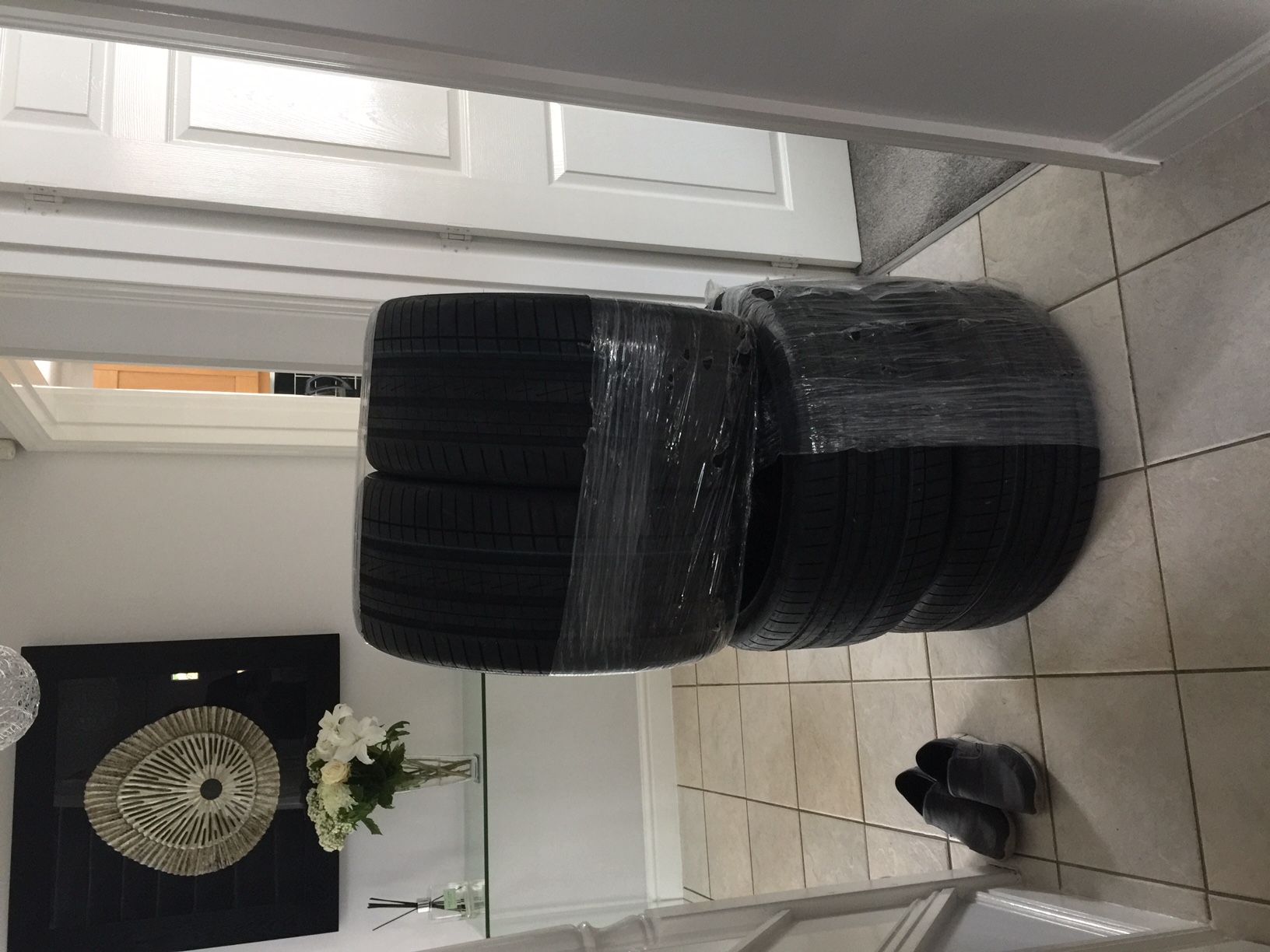

Just to add to this for anyone else...
I just fitted 275/35/20 and they are perfectly fine, attached is a pic of the difference between 265 and 275 running 35 on 20s
ID:	17032   Click image for larger version
