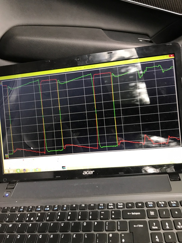

So, if its complaining at the readings, lets see the readings. Here is a good working example from ECU1, reading throttle body 1 using vagcom on turbo mode. You can see when the throttle is blipped the sensor readings invert with perfect precision.

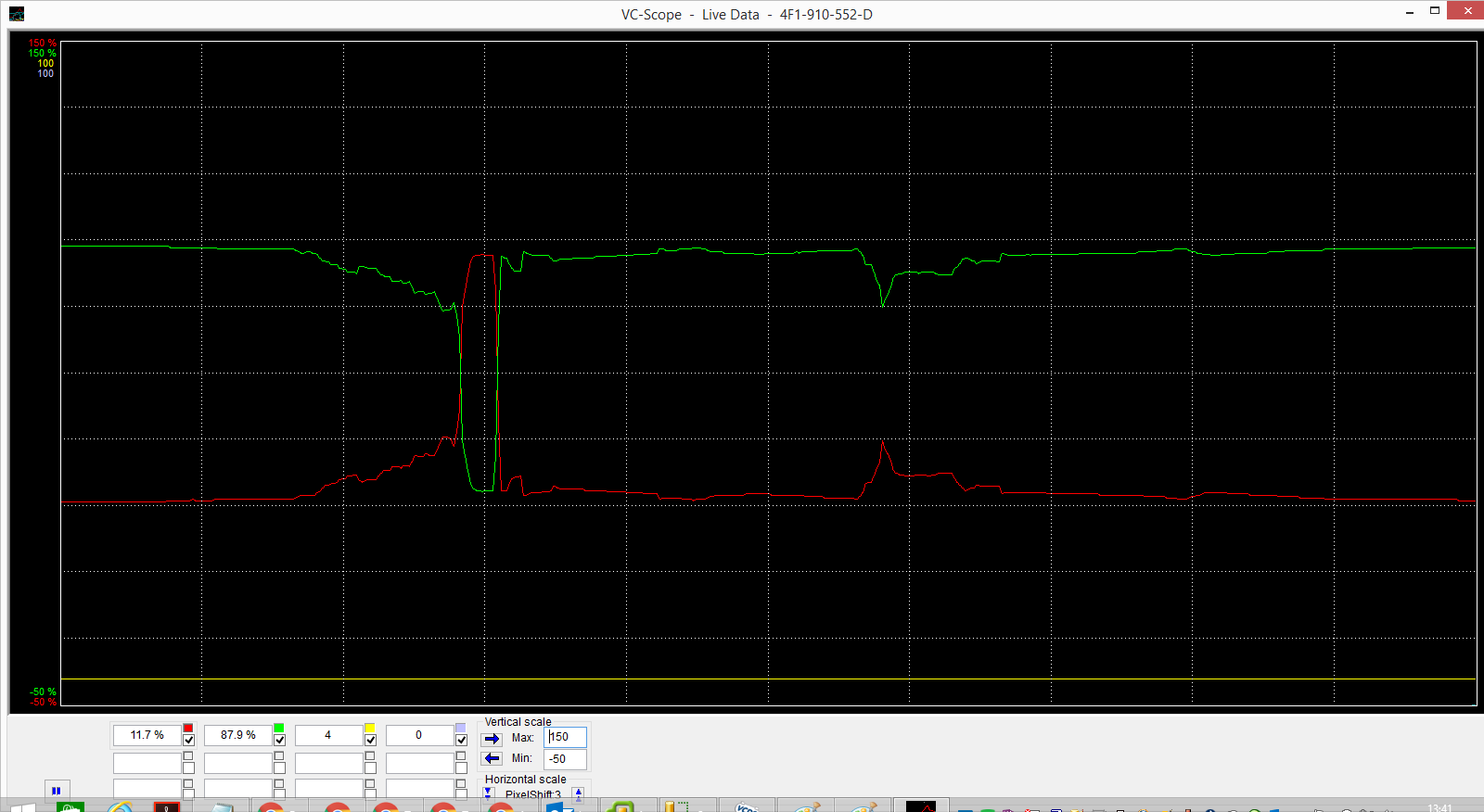

Now, look at the graph for ECU 2:
So, circled in yellow is the problem. They simply don't match. The ECU thinks that the value is considerably different to the other sensor, and freaks out....

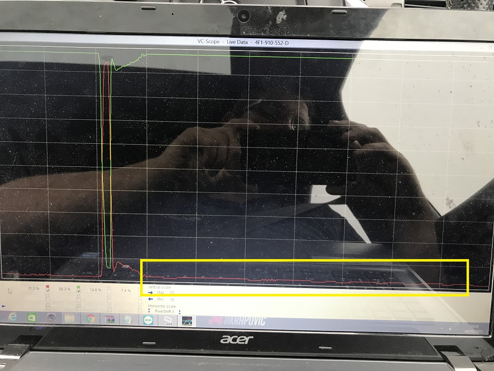

Now, if that wasn't weird enough. Check out this graph. Sorry for the noise, but look at the pink and brown lines.
According the ECU, the value is over 100%... wtf. So its reading more voltage in, than its sending out. huh ?

Before that though, Doug had spotted that the signal on sensor 2 showed irregularities on idle. This was another major breakthrough as no longer did it have to be warmed up and then driven quickly to diagnose. This was the car wobbling a bit on idle at their workshop:
