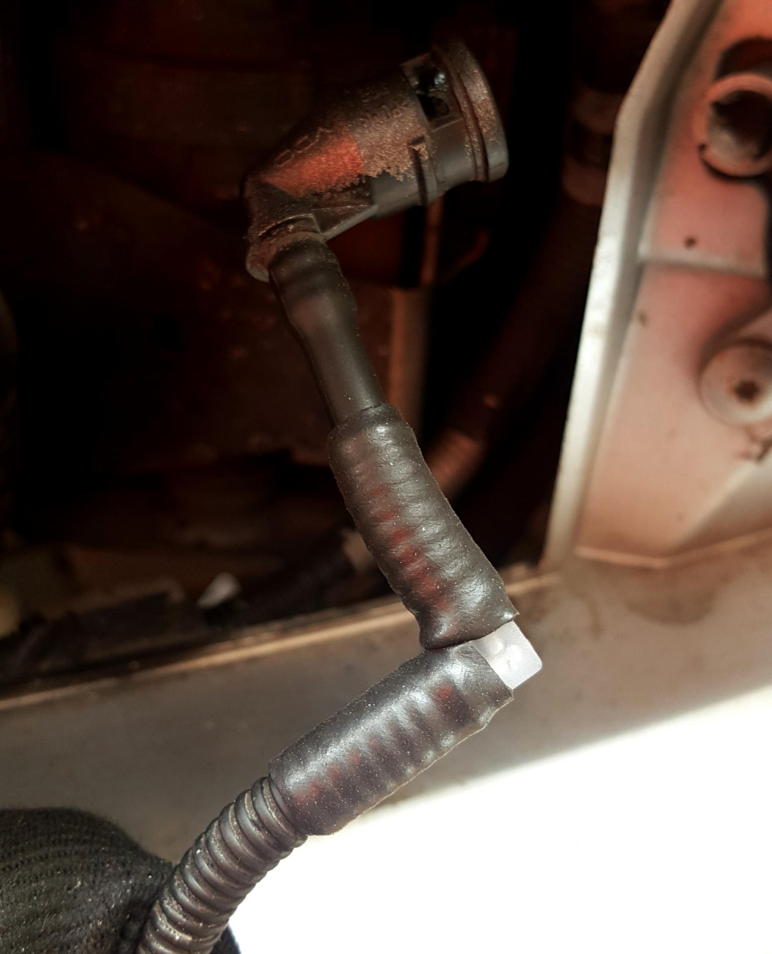

Old 24th April 2018, 01:39 PM
Rick Rick is offline
Join Date: Mar 2016
Location: Ipswich
Posts: 234
Late to this i know but here are pics of mine. Simple split pipe just where it bends to go to the washer jet.. Been leaking for 2 years but just sorted it. Took 10 mins.
ID:	18582   Click image for larger version
