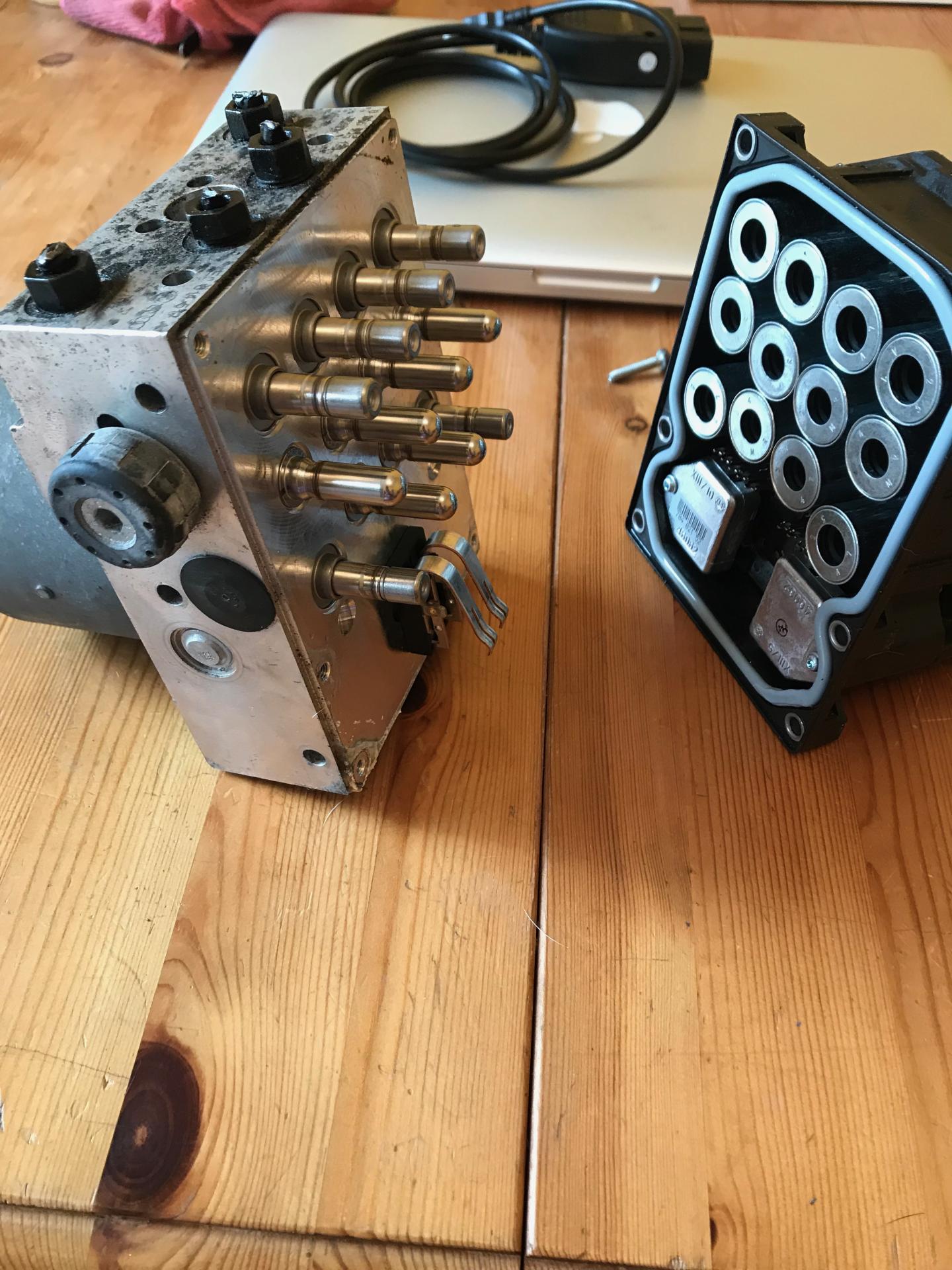

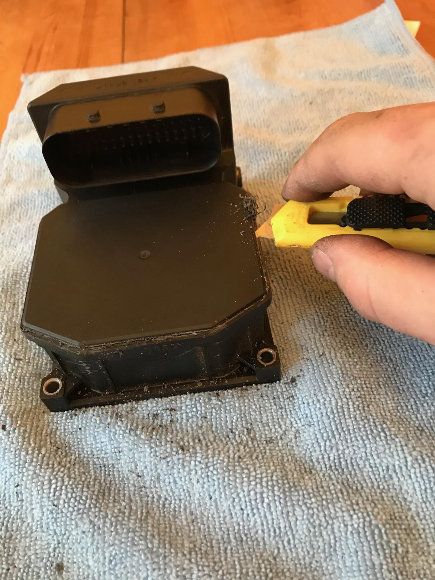

...so I am back with an update. I recently bought the brake light switch which didn't solve the ABS,ESP,speedo problem. It turned out is a controller on the ABS pump, as the A8 permanently had error lights on and VAG pointed out the controller.
I have decided to remove the controller (black plastic box as on picture) and try to fix it. I am telling you is a pain to open the box. resoldered all hair thin connections (they are not even visible in the picture) and also the ticker silver connections (8 approx) tested connections with a multimeter all good. sealed it back and re-installed it back to the car,,, sadly communication with the controller still persist(I guess is one of the chips is faulty), so sourced matching pump+controller from Prestige Motor Services and swapped the controller only.. Connected VAG and read the controller so happy times, ECU is communicating with ABS. however when I try to code the controller(same codes as on the old one) it does go through "Coding accepted" but once I close the controller reopen ABS Brakes the coding is gone. Does anybody have an idea why is that??

The code has bee accepted, I took the car for a spin and in about 4 min dashboard beeped and ESP,ABS light gone...So all good.
Another job done.

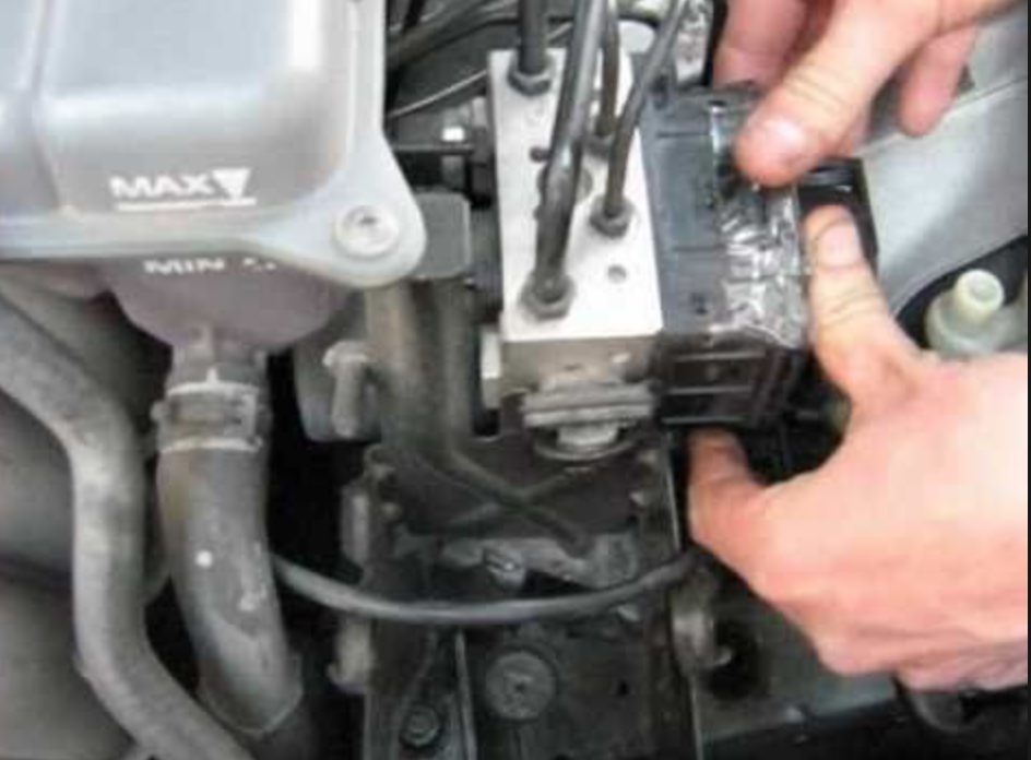

Is on the right hand side in the engine bay(circled in yellow), kinda under the servo reservoir. It has 4 black metal pipes going into the silver aluminium pump body...The controller is the black plastic box screwed on the left hand side of the pump(Audi A8 D3)..
The 2nd picture is for illustration purposes but the controller is the black box which fella is holding on.

Mate thanks for the reply, I originally thought I would have to take covers off etc but when I went and had half a look there it was in plain sight just as you have advised.
I should have had a look before posting, thanks for the time.
