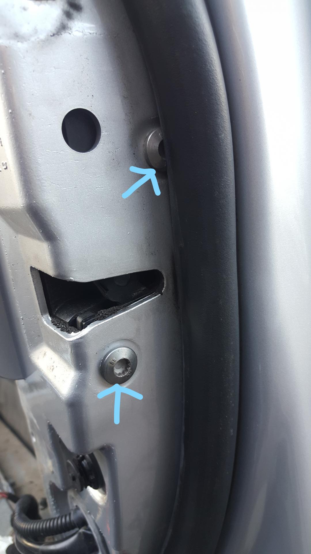

You have 2 x8mm multipoint (NOT TORX) screws you need to remove to get the latch out.

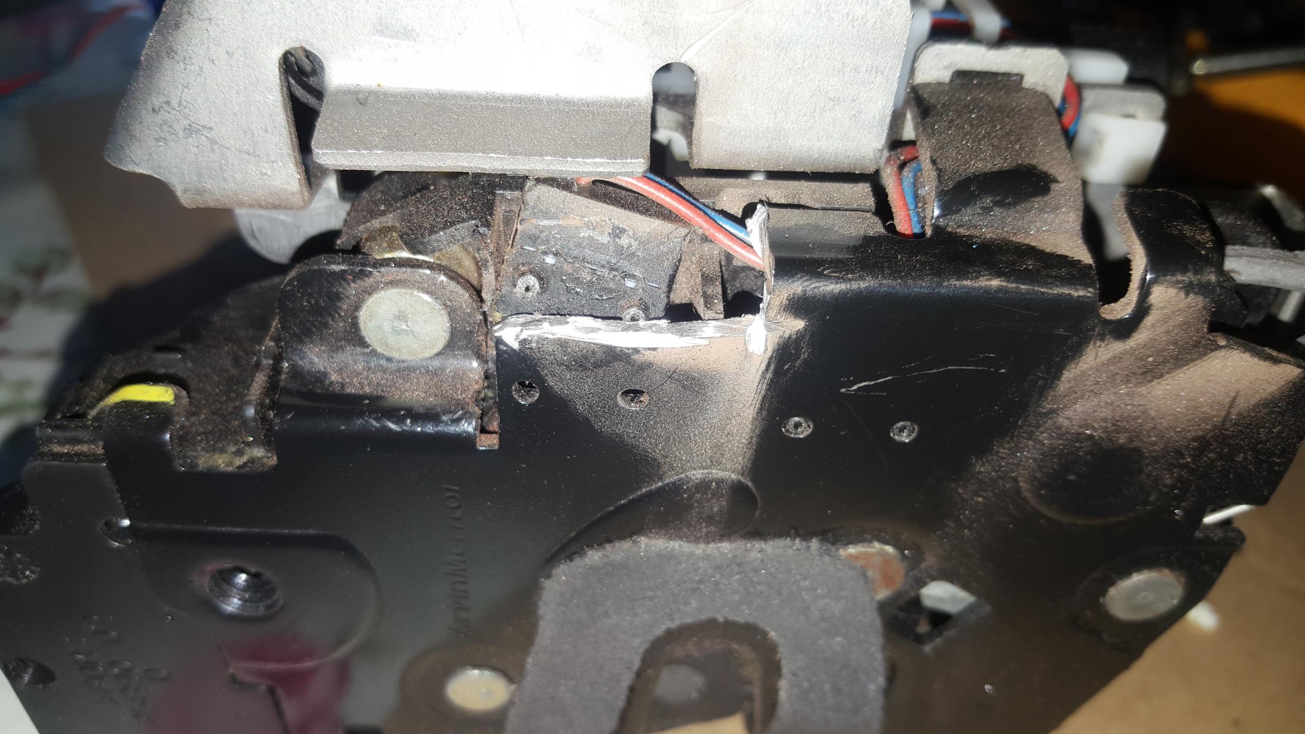

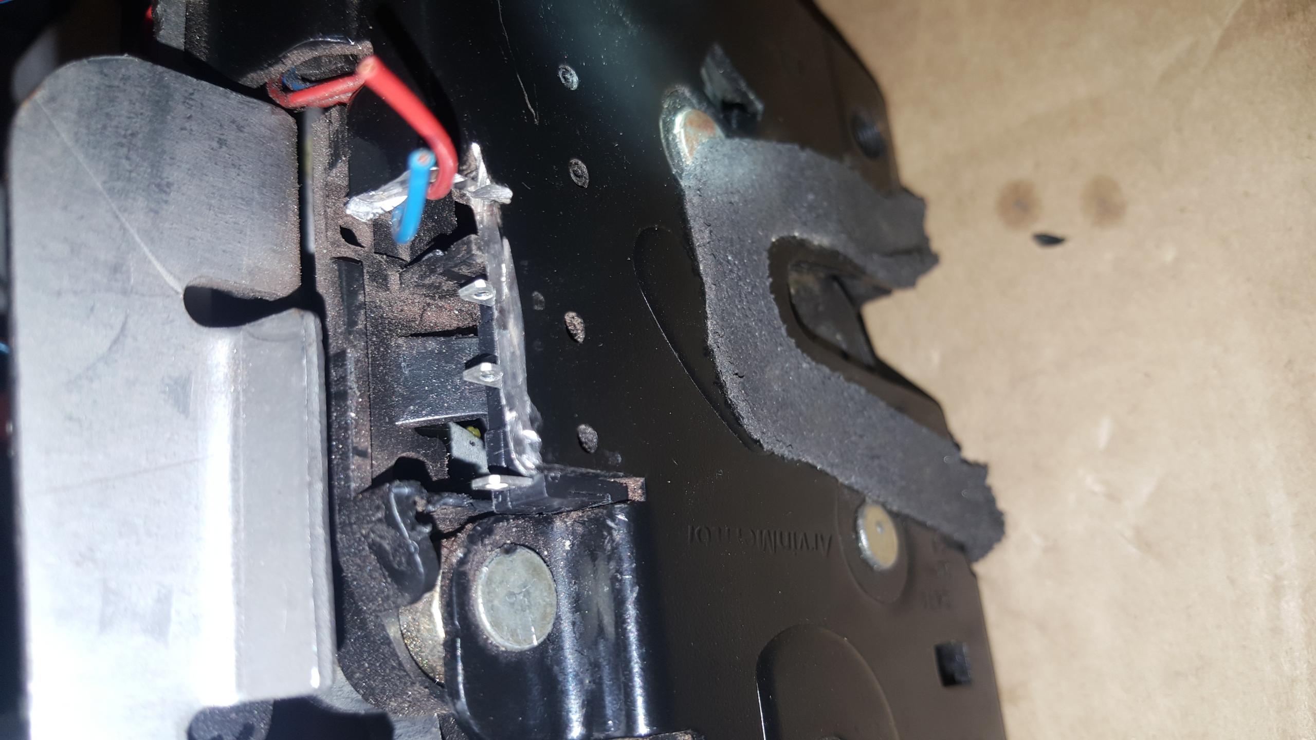

I got the dremel out and cut out the section need for the soft close microswitch, gave it a push where those 2 small holes are and when it was in a position to do so pulled it out, on the other side of the micro switch its held in by a bit of sprung plastic so anything thin enough to wedge it should work ok.
cut the wires, offer up the new switch in same orientation as the old and seat it untill you hear it press/click, for my switch it needs to be pressed when fitted, it is on the release of the switch bar that my motor kicks in, so for me the connections were the right and middle spade.if you put a meter on, you want an open loop when the door lock is fully open, and you want it to make the electrical connection when the lock makes the first click as when the soft close should normally kick in, and it should keep that connection when door lock is fully closed.
so get the switch postion sorted, bit of solder and i used hot glue to hold everything in place. all back on my motor and so far so good. not sure how long these maplin (product code N96AQ) £2.29 micro switchs will last but no issue replacing them again if and when the do go.
