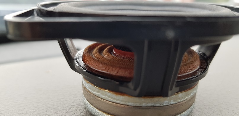

Now, I fixed my door speakers, but failed to take any photos, but when it came to change the center dash speaker it turns out to be exactly the same issue, which I did photograph. Annoying as in the past I've changed it for a new one and thrown the old away, as previously documented:
You see the orange membrane. Well, i strongly suspected that it shouldn't be loose. And in fact, if you tap the speaker, you get an awful metallic tapping sound much like the awful resonance.
So, I decided as I had nothing to lose, I'd superglue the orange membrane back to the metal chassis of the speaker, as I suspect it was supposed to be.
And the superglued result was perfection.... I let it dry then tested it, rather, ah hem, thoroughly, and its spot bloody on. £2.75 I paid for the loctite superglue off ebay, delivered to my doorstep (including VAT and delivery)
Bargain of the century. Now, my £5000 B&O sounds exactly how it should do, and I suspect will last longer than the factory replacement speakers which would have cost me the best part of a grand to replace. <gulp>

I can confirm after ~1500 miles of selfless ear drum bashing in the name of testing and science, that this fix seems to be holding quite nicely....
