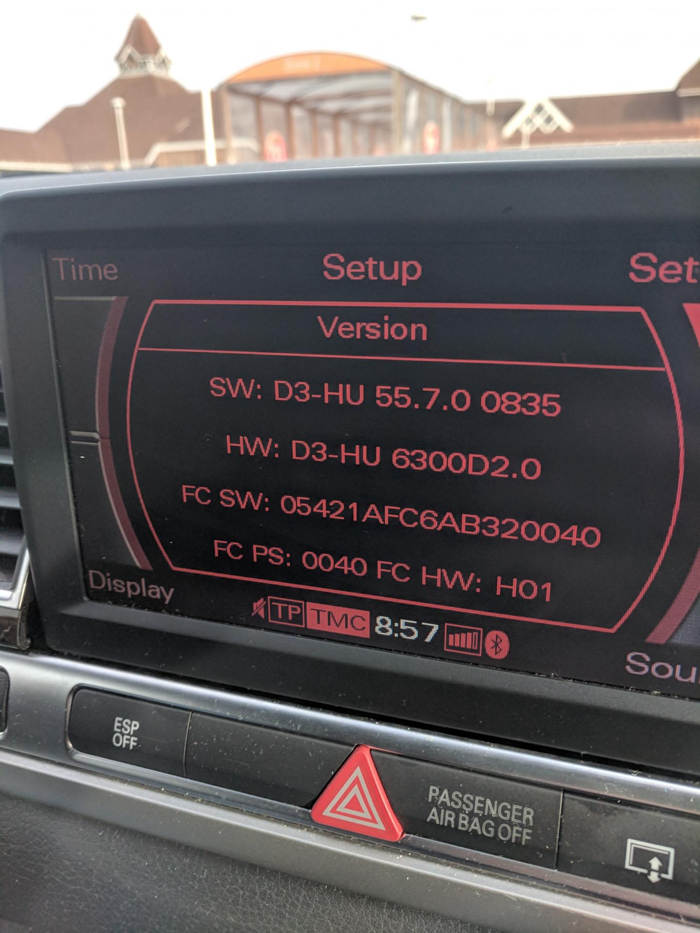

Just a quick question guys - can you take a look and tell me if I am using newest version I can?

Yes 5570 which is the latest I believe

Thank you. I thought that it is, just wanted to be sure. Because there was also a Bluetooth update, right? I understand that somewhere there is also a version of Bluetooth, and it's up to date, right?

Can't tell from your display as it only displays the car's MMI version and the MMI version 5570 was updated with a different CD than the Bluetooth units.
The two different 2G Bluetooth units 'Handyvorb2' and 'BTA' were brought upto their final versions with CD2 of the 3CD 5570 set. Handyvorb2 went to 1130 and BTA went to 1120.
You can check YOUR version by using the 'hidden' red screen that you can get to using the instructions in the attached text file.
