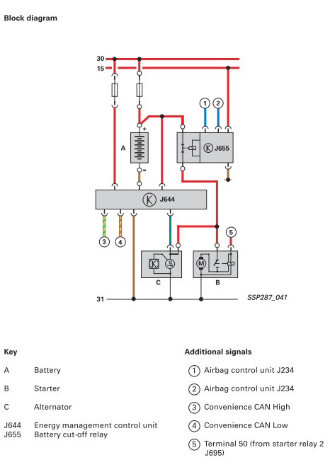

Marty; thanks for your comments but I believe the D3 alternator is more advanced than the D2 one; the D3 one is water cooled and has variable Voltage output based on what the Battery Manager [BEM] asks it to produce.
The attached diagram shows only one connection from the BEM to the alternator [in blue] and that's its 'voltage request line', I believe.
As per my comment to SRG above; I guess it needs a voltage check for the alternator output to see if it's giving the 14.3 it's asked for. If it is, I think I might have 'voltage drop' but I've no idea how that battery current gets to and from the front of the car.
Julian
