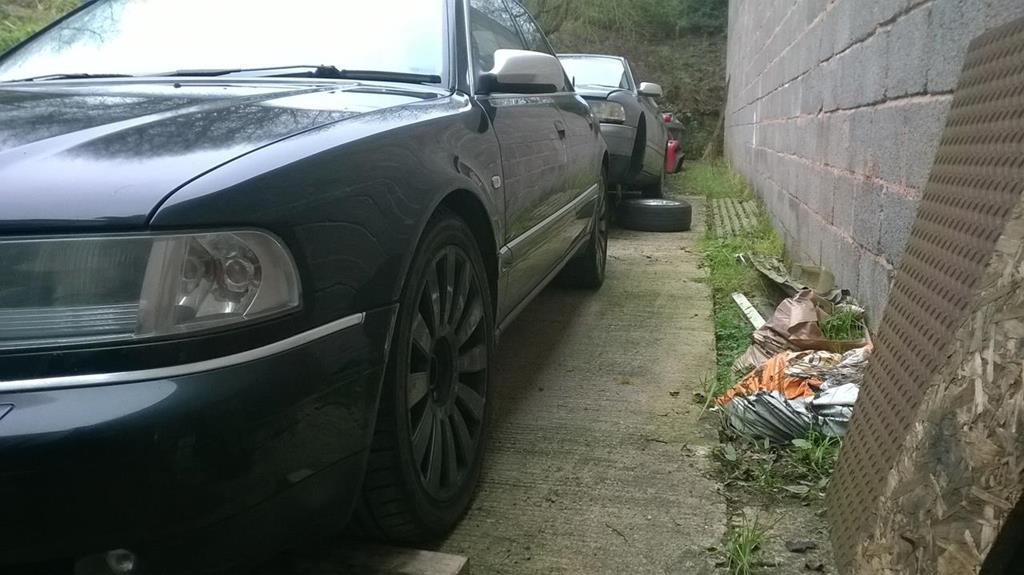

You may also remember this 2.8 FWD with a blown-up gearbox which I bought for its black interior
More of that later.

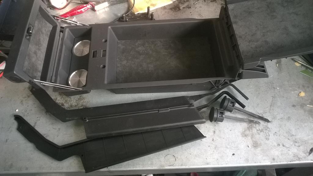

I found the infernal rattle in the centre console - a loose snap nut with no home!

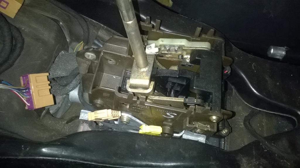

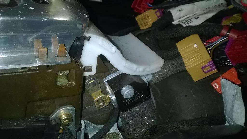

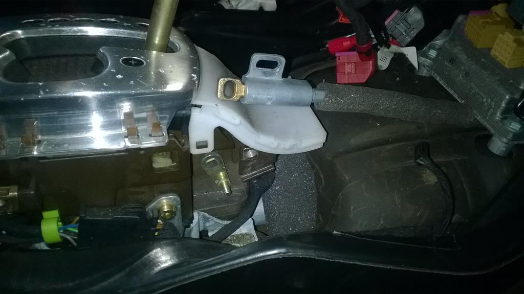

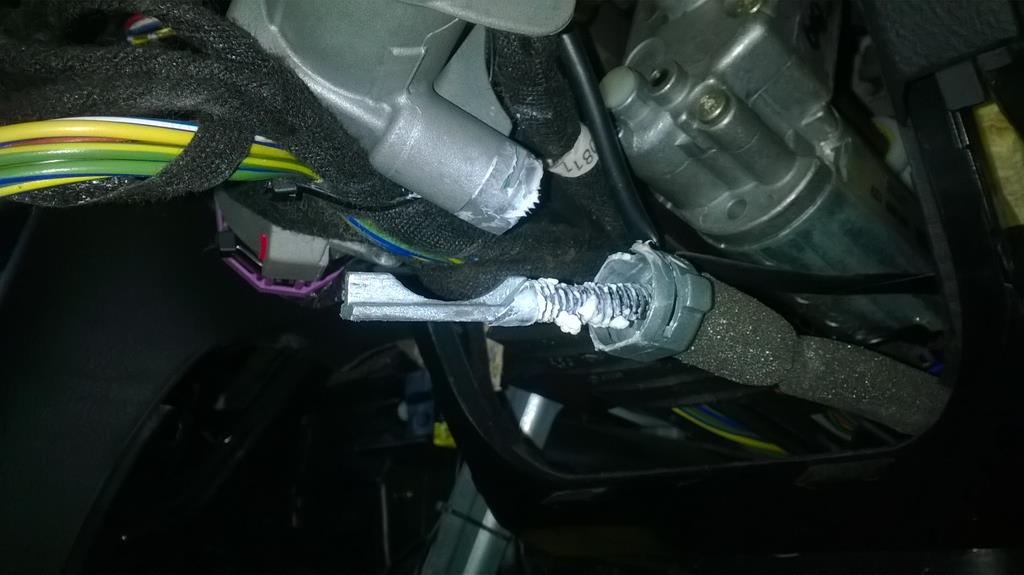

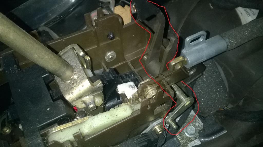

First job - get rid of the damn shifter interlock. This thing drives me nuts when putting a D2 on the lift (which I do a lot!) because it stops you shifting in to neutral without the key. Of course if you leave the key in, the car's electronics stay awake so the battery goes flat after a while. I can't open the doors on the lift so I have to leave the window open, and if I'm working on one for a few weeks it then gets dusty inside. Its all a big pain in the posterior so its getting deleted from mine.
This is the cable to the ignition barrel
and this is where it attaches to the shifter
With the key in, remove the circlip and slide the cable end out
One bolt removes the clamp from the shifter housing
This lever needs to go as without the cable it just flops about. Not sure if it would lock the shifter unintentionally, but it might rattle. I had to cut this up with the dremel and take it out in three bits.
All gone. I replaced the top aluminium cover while it was off since the original was all corroded and nasty.

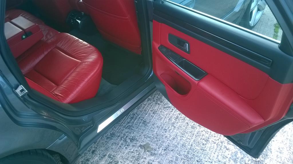

Old 5th June 2018, 08:37 PM

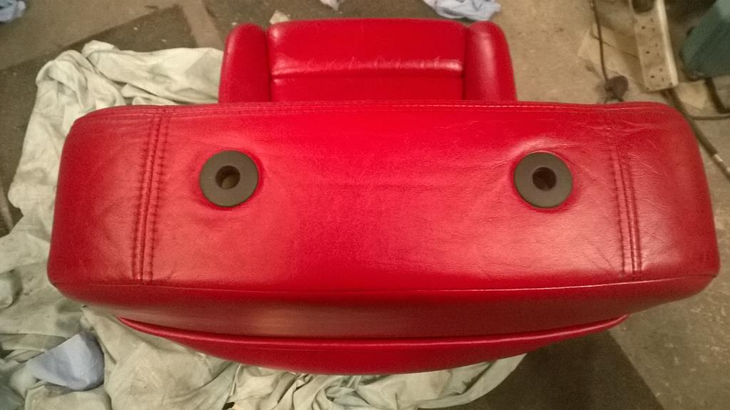

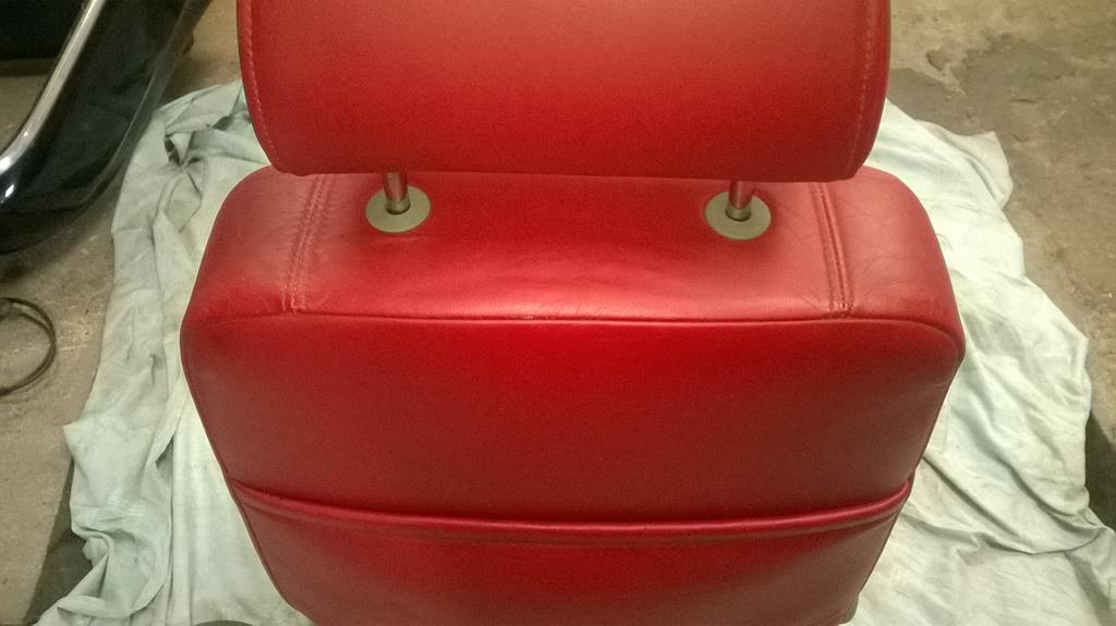

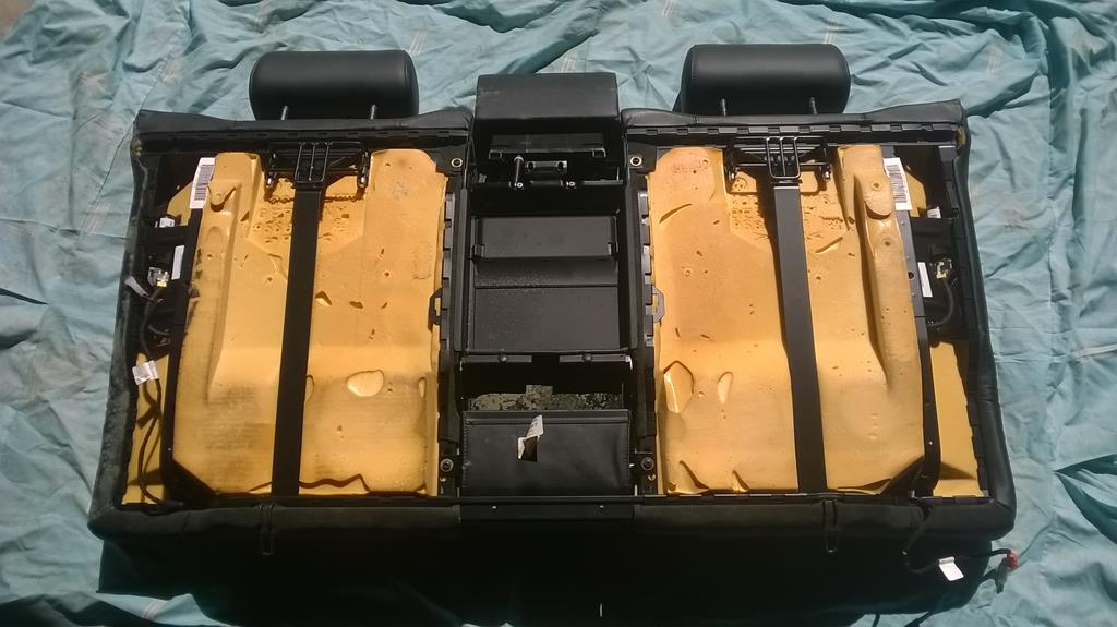

On to the interior. I started with the back seat from the blue car

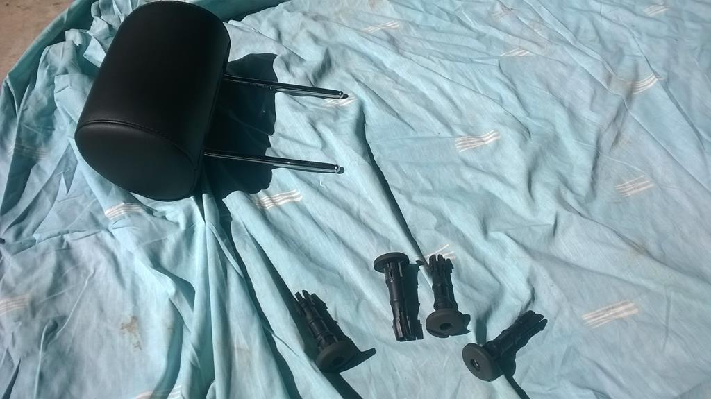

First thing removed was the headrest supports
Then dismantled the armrest.
and the centre headrest
It took quite a while to get all this lot separated
Did the same on the red seat

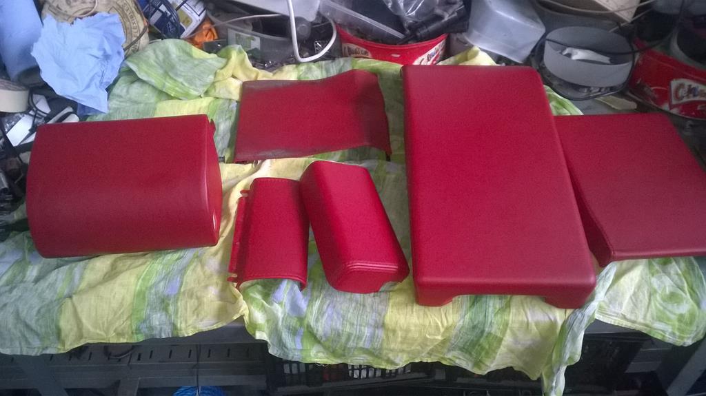

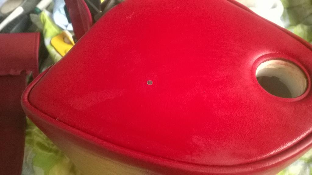

All the red leather removed from the grey plastic

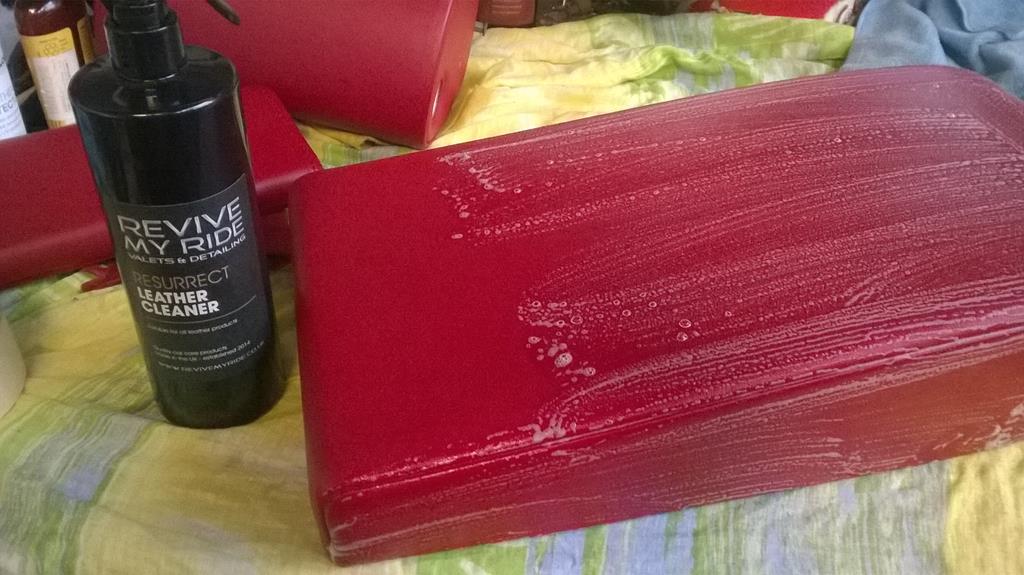

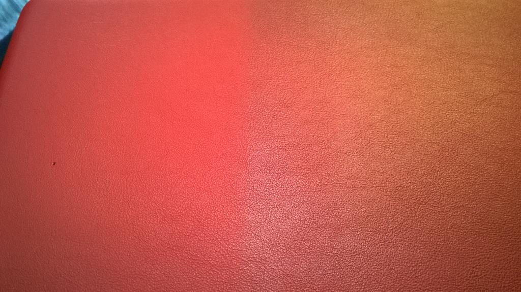

I cleaned everything while it was apart since it was filthy
You can see the contrast to the original colour here
Its very hard to show before / after with the red, but you get the idea. I must have spent 25-30 hours just cleaning the leather!
Now some people have cast aspersions that there is only one, quite specific, market for a big black Audi with red leather seats. Of course I have vigorously defended it's honour in this regard.
Oh look. A sequin stuck on the back seat
And quite a lot of glitter... I may have to concede shenanigans

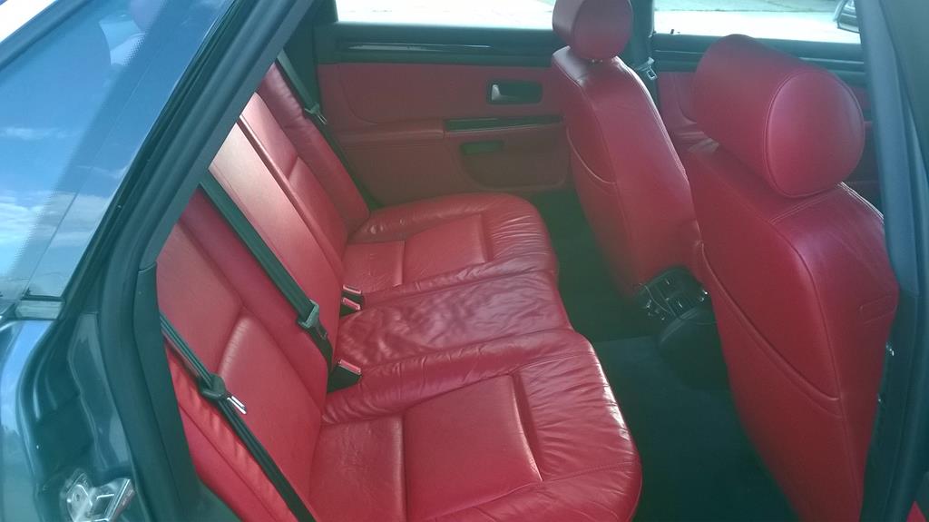

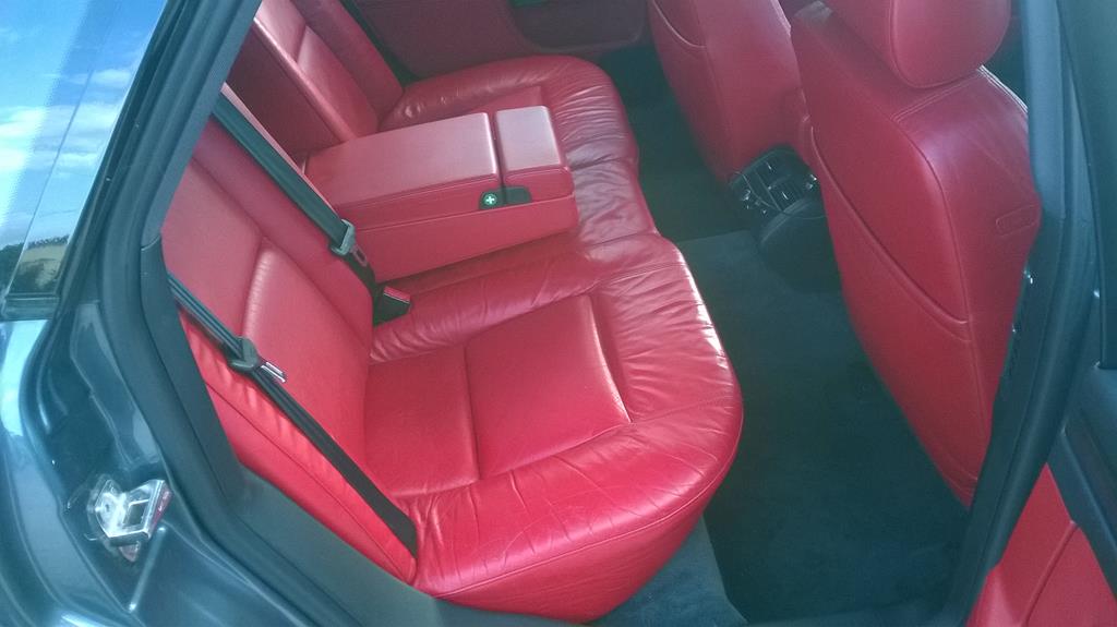

Back seat completed:

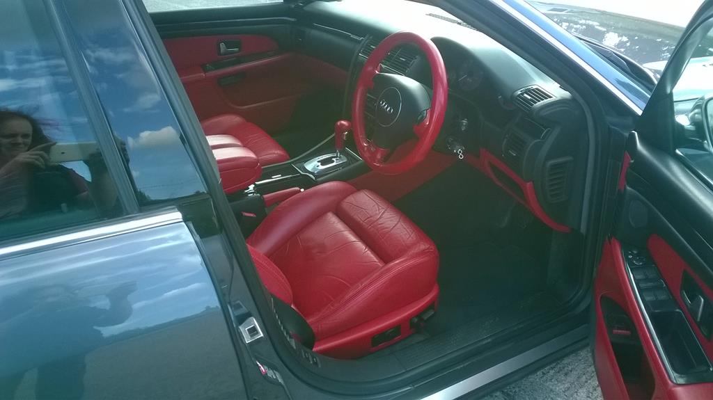

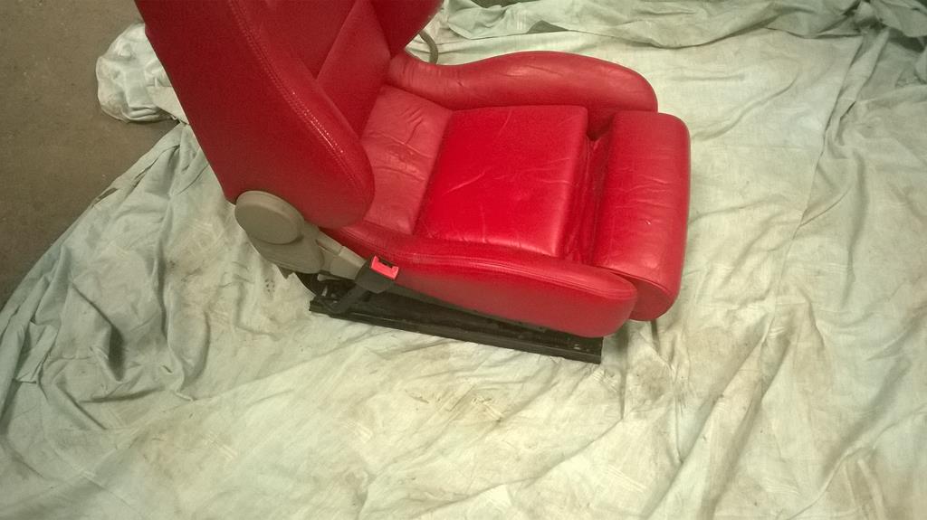

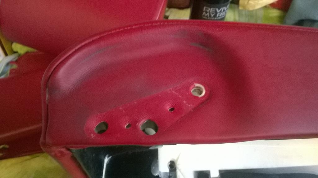

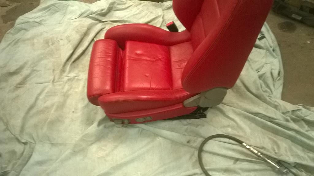

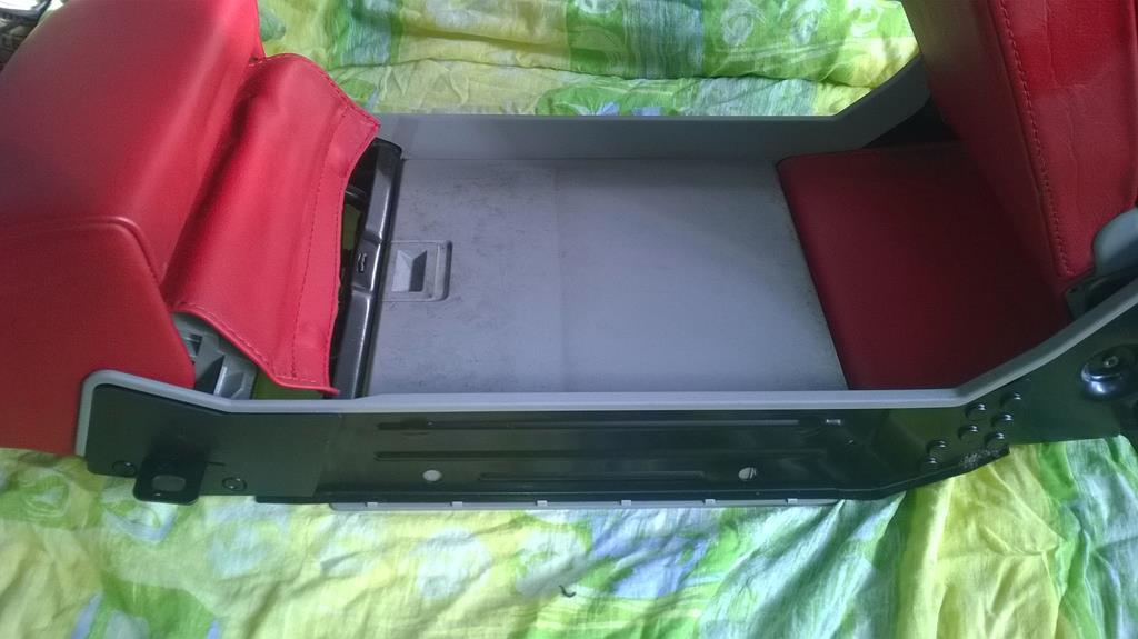

Old 5th June 2018, 08:46 PM
The driver's seat right bolster had collapsed in the FE so I stripped the perfect right bolster from the black donor passenger seat
FE bolster on the bottom here
I forgot to take any pics of swapping it over sorry! Its nice and comfy again though.

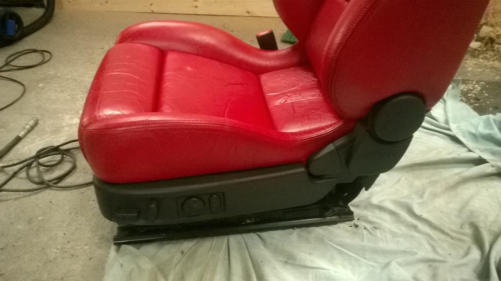

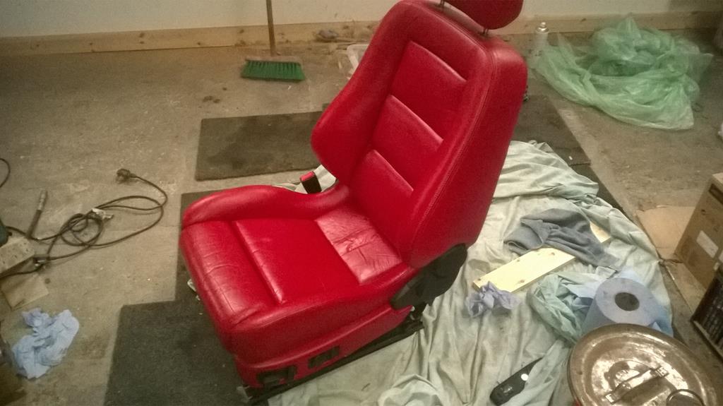

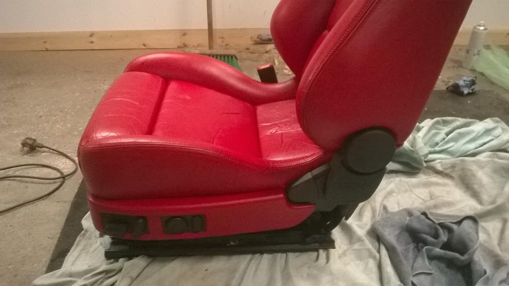

Original red front seat with grey plastic
The black interior donated all its black plastics
I experimented with the black seat controls panel like in Davey Blueeyes' car
I prefer the extended red though, and in hindsight given the rest of the extended red bits this was the right decision
Passenger seat completed

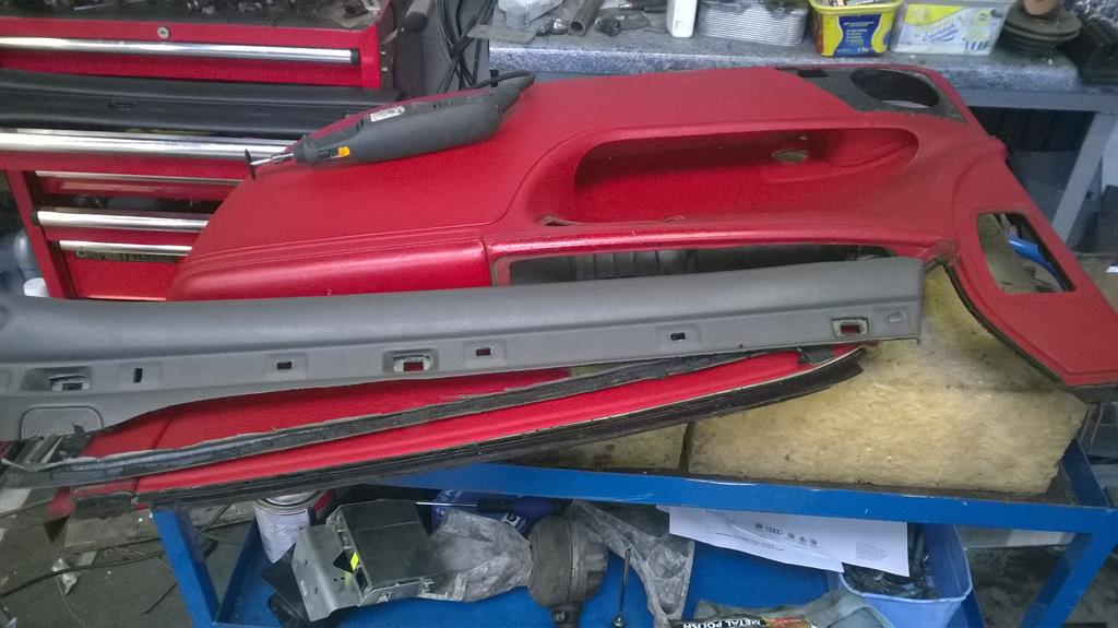

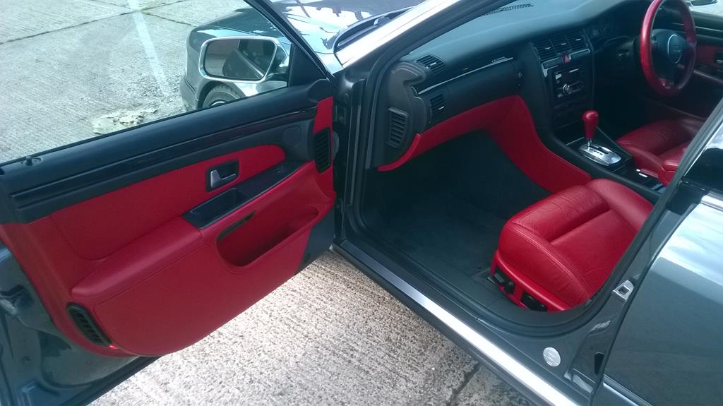

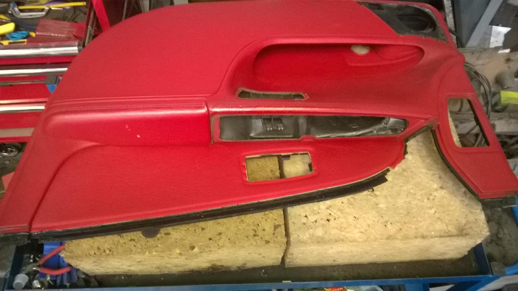

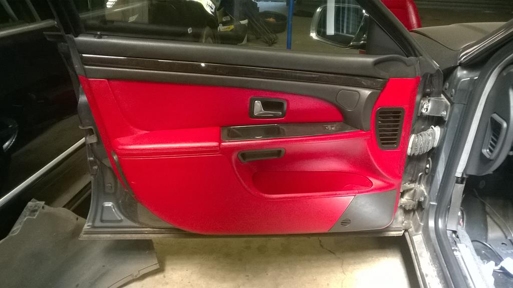

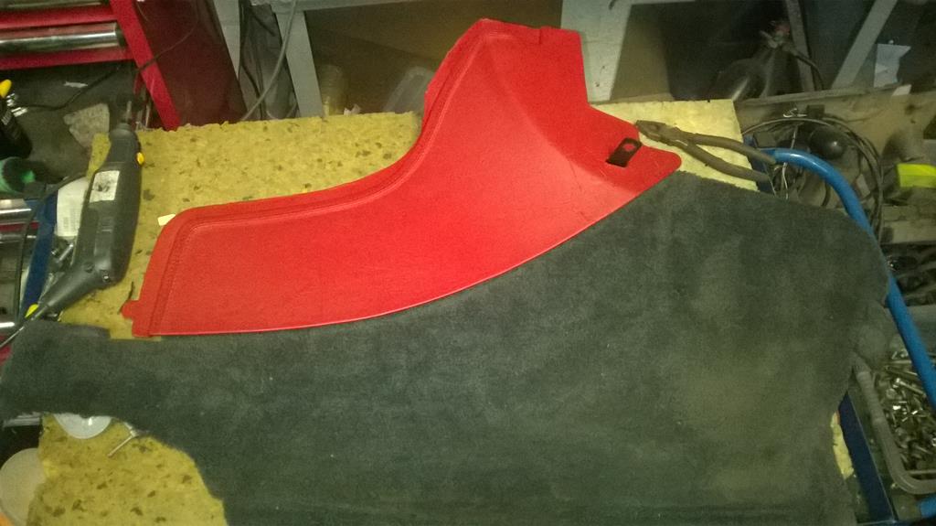

On to the most challenging part - the door cards. Those of a nervous disposition might want to change the channel at this point...
Cut the top off the red FE door card with a sawzall
Cleaned up the edges with the dremel to leave just the bit I wanted

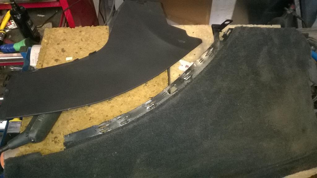

I did the opposite with the black door cards from the donor interior, just keeping the top piece.

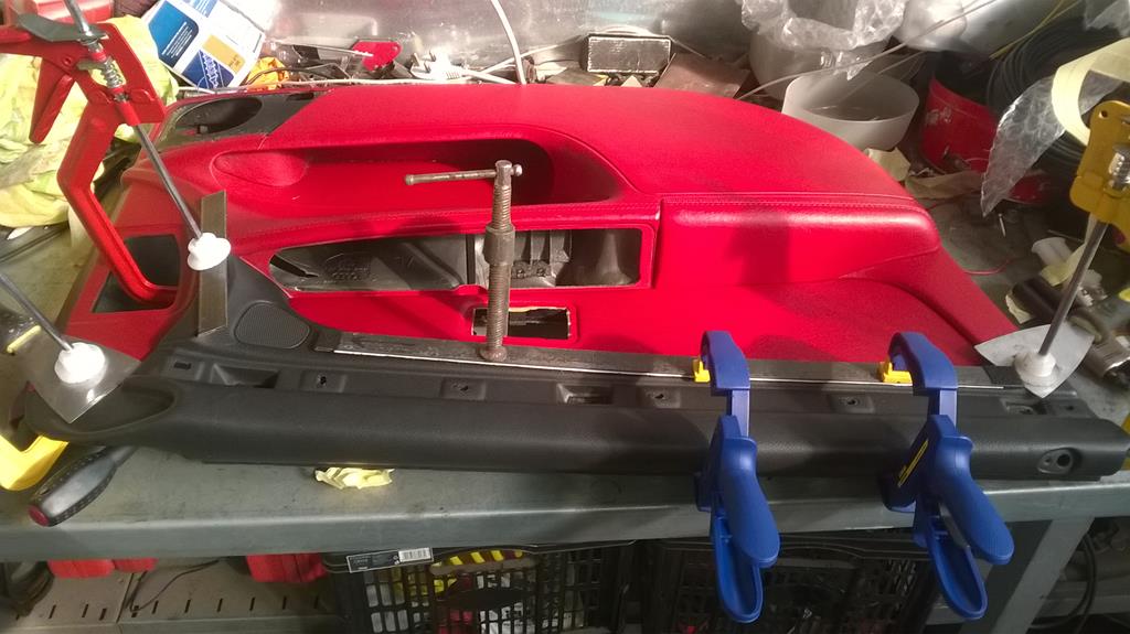

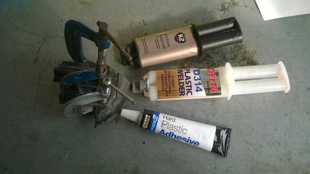

I did some experimenting with different types of adhesive using a scrap bit of the door card ABS plastic. I clamped up three pieces overnight and then measured the force required to break them the following morning
The 2-component Plastic Doctor at the top is by far the strongest - the plastic itself broke before the glue gave way, however with a 2-3 minute max working time it was useless for the task at hand. The airfix glue (remember that?) at the bottom was the weakest of the three but still very strong and also the easiest to work with, since it didn't require mixing and had a 10 minute working time. Given the surface area I was working with I deemed its strength to be acceptable so off I went.

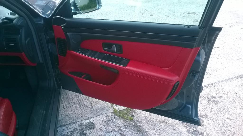

Swapped over the door catch, speaker grille, and vents, and one door card is complete. It took three full days work from the first cut to this picture, for each of the four panels, including cleaning and treating the leather.
Fitted to the car

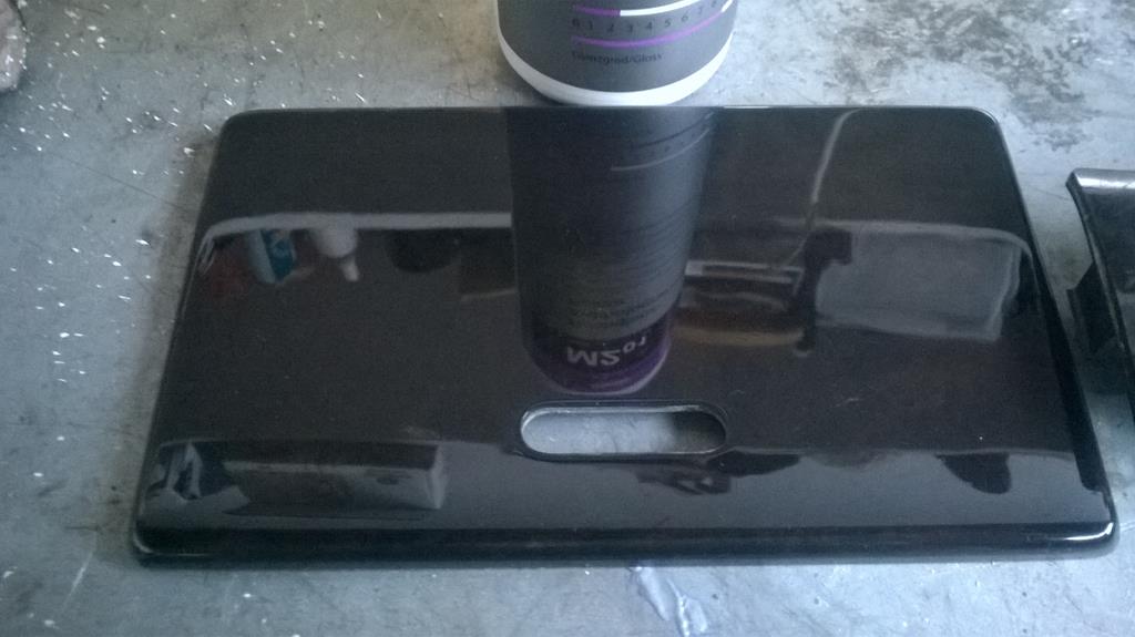

Old 5th June 2018, 09:20 PM
I really wanted to keep the maple wood as I rather like it on the black dash, but it looked terrible against the red so I swapped in the FE Myrtle.

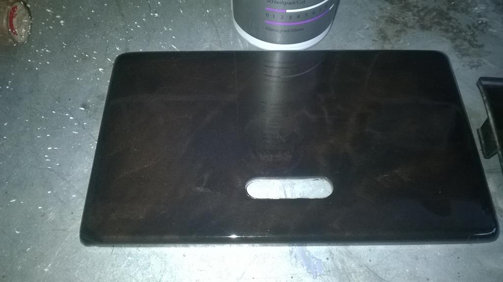

The panels were in a pretty terrible state so I dismantled all the pieces and polished them with some Koch Chemie M.2 ultrafine anti-hologram polish.
Before:
After:
Much better I'm going to experiment with some paint protection film to permanently protect the centre console pieces against scratches. More on that when I get to it.

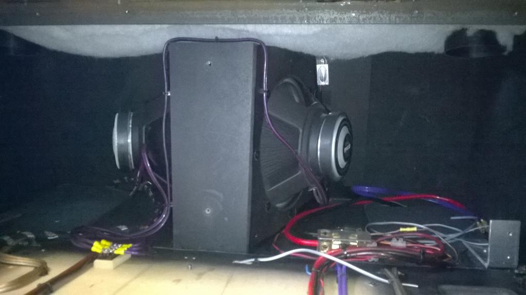

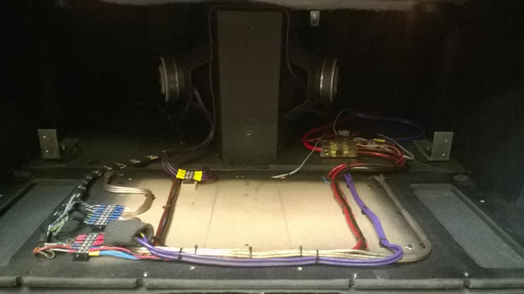

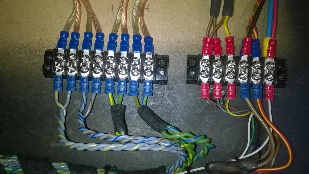

Random pic of my sub setup for those who are interested:
The box is effectively inside-out and uses the boot as a tuned enclosure. I have bell-mouthed tuned ports mounted in the original speaker holes.
The back of the amplifier board
I used terminal strips so the amp board is easily removable for tinkering

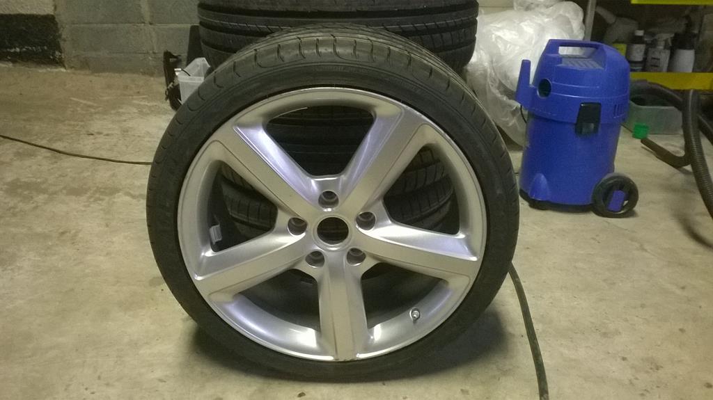

Test-fitted my new wheels to check for clearance.
Discovered what a state the brake discs were in, hence changing them before I drove up to the meet on Friday!
The wheels fitted fine so gave them a good clean. It took six applications of fallout remover before they stopped running purple! The inside barrels were like sandpaper with all the embedded brake dust.

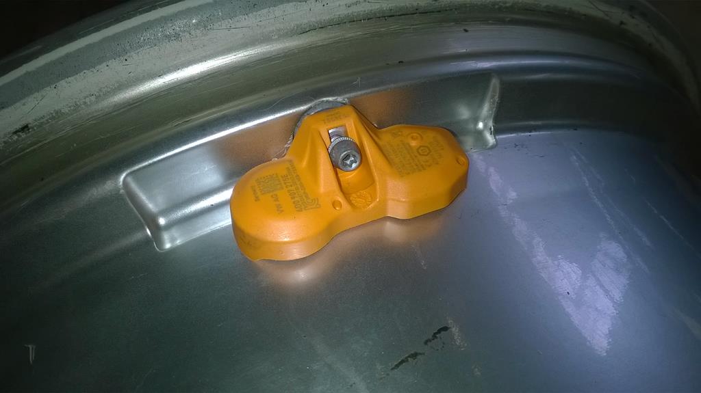

Fitted new TPMS sensors. No, it doesn't have TPMS... yet

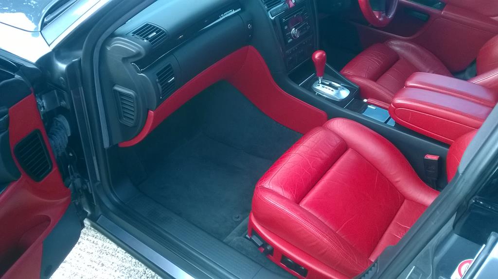

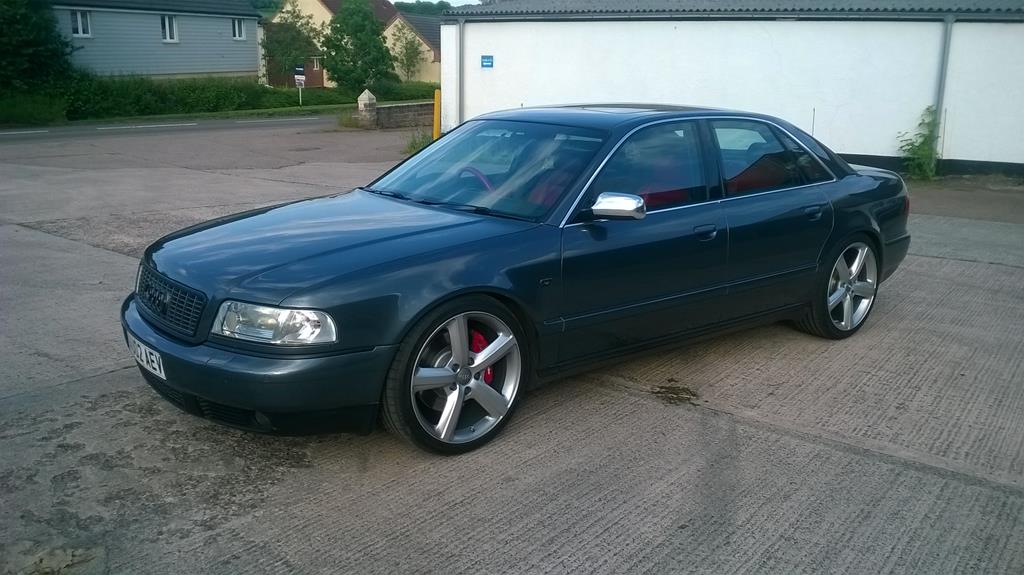

Old 5th June 2018, 09:28 PM
Some pics of the completed interior after I got back from the meet:
I have fallen in love with this car all over again The new wheels and tyres have transformed the handling, the Supersport exhaust has released just the right amount of lovely V8 burble, and the interior has gone from a nice place to be to properly exciting

Bloody hell MJ..had no idea how much work was involved getting it like that, superb work yet again..when you moving to Scotland?
Old 5th June 2018, 09:38 PM
Around 200 hours spent on the interior, but it was totally worth it!
Old 5th June 2018, 10:21 PM
Posts: 2,290
Beautiful. I love that colour combo
Old 5th June 2018, 10:26 PM
pete-p's Avatar
pete-p pete-p is offline
Posts: 668
That's a lot of hours! Well worth it as it looked amazing. Would never have realised you needed to cut the door cards apart like that though.
