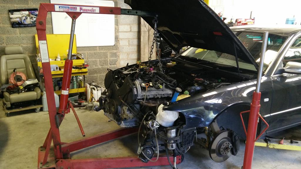

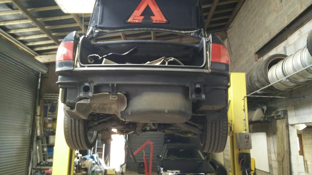

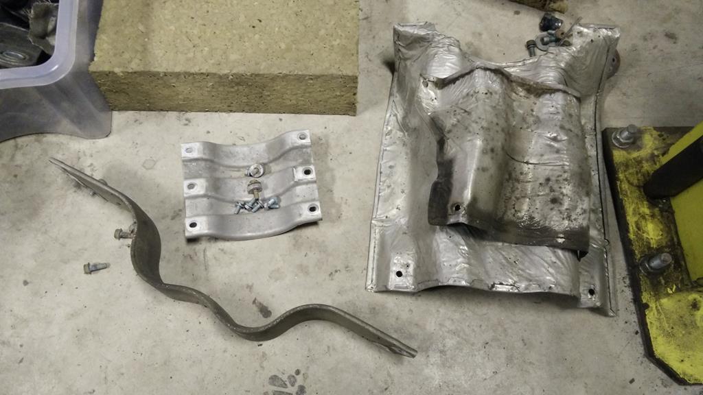

Stripped the console out before I put him on the lift

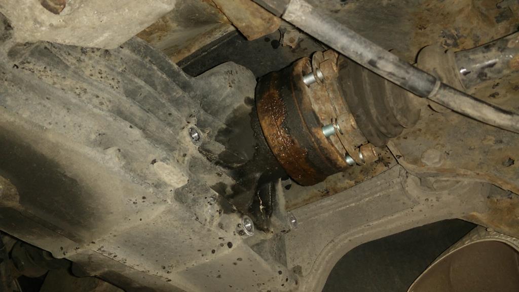

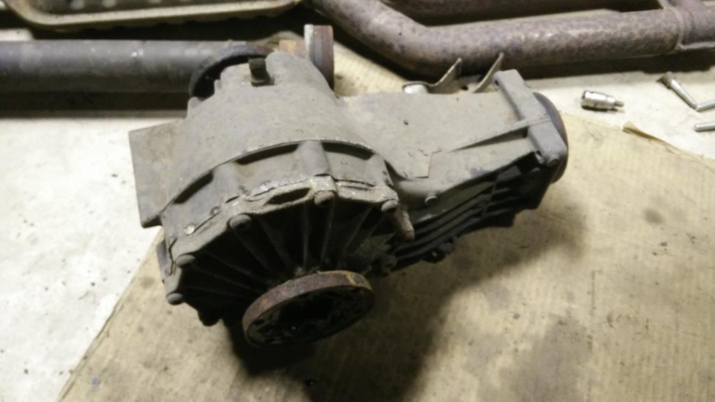

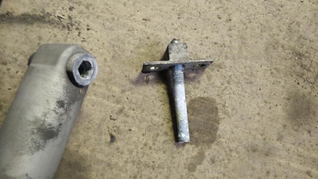

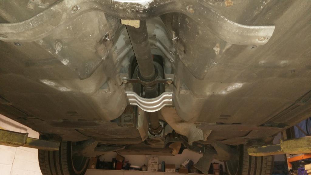

Started on the drivetrain removal:

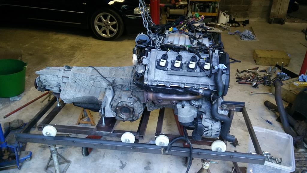

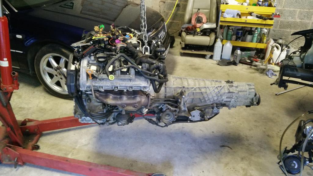

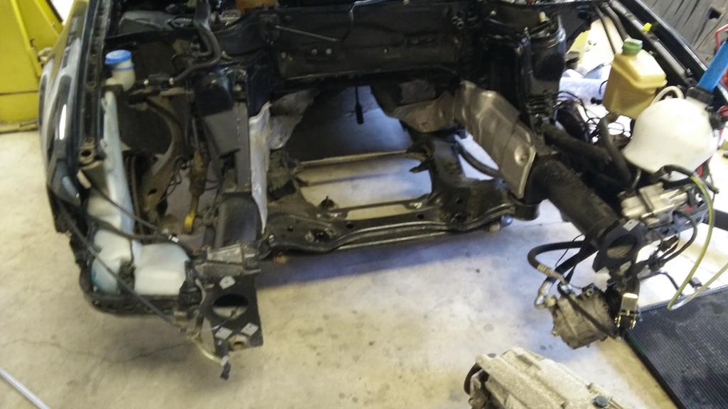

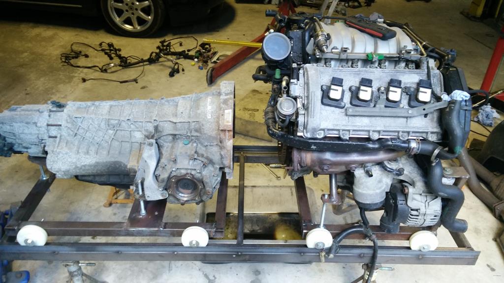

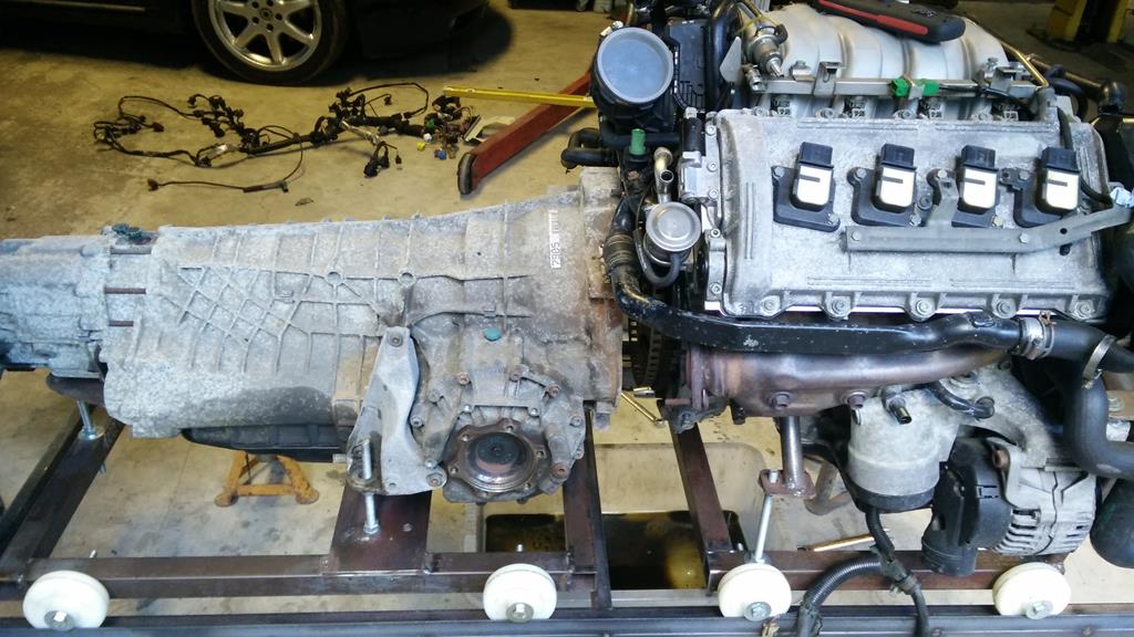

Because I need to get both inside and under the car for this job, I'll need to roll the car off the lift to open the doors. Thats a tad tricky when there's no front subframe, as I discovered with Vera's impromptu clutch hose replacement. On that basis, I decided to remove the engine and gearbox and leave the subframe in place. This was a mistake It would have been far easier to take the engine out the usual way and just put the subframe back on afterwards. Never mind!
So, this is where I got to by bedtime last night (6 hours elapsed, the engine would normally be out in 4-5)

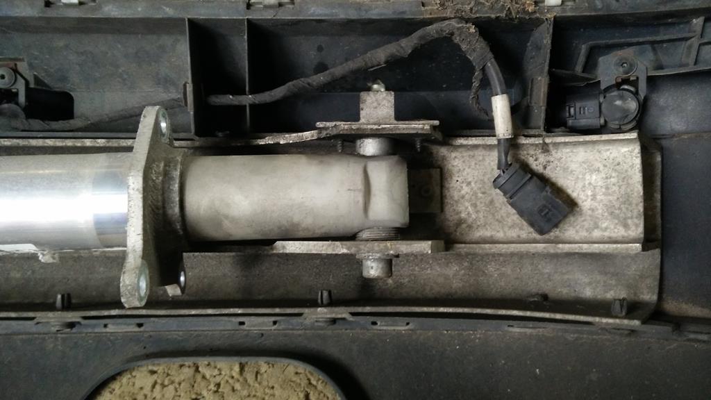

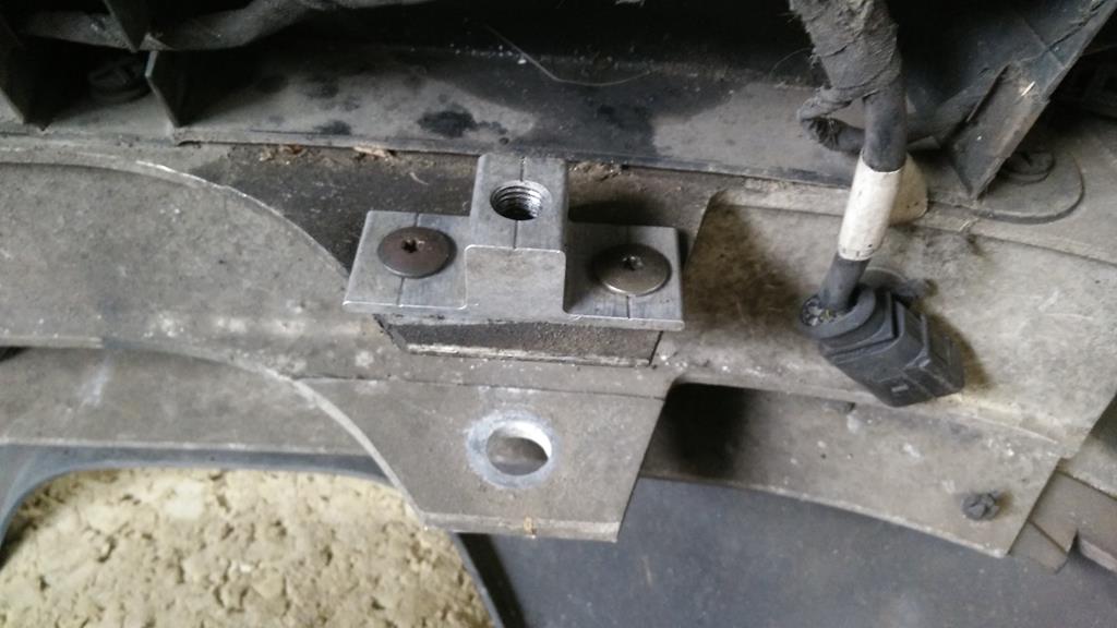

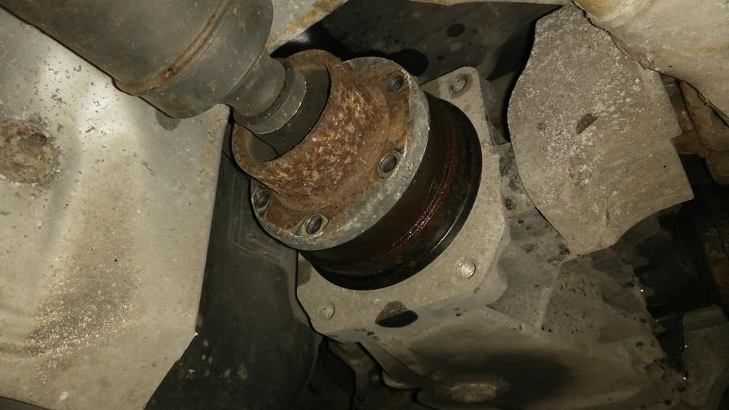

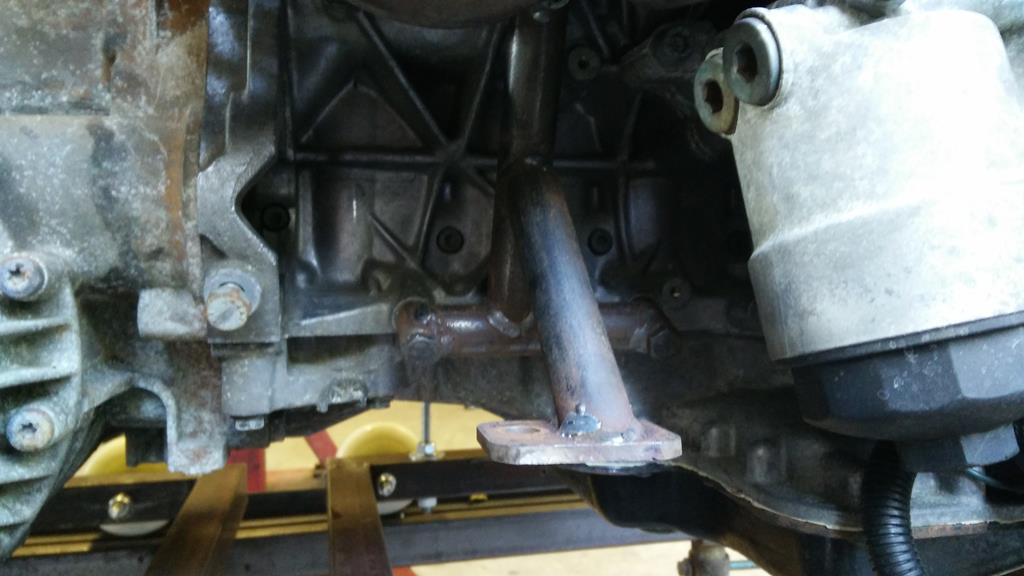

Just the starter junction box, propshaft and engine mounts to remove tonight and the drivetrain will come out.
This is the pile of tools required to get this far:
