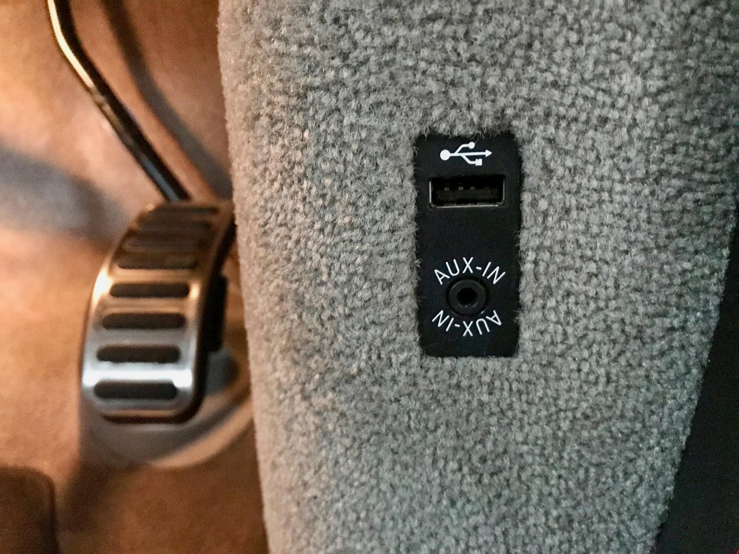

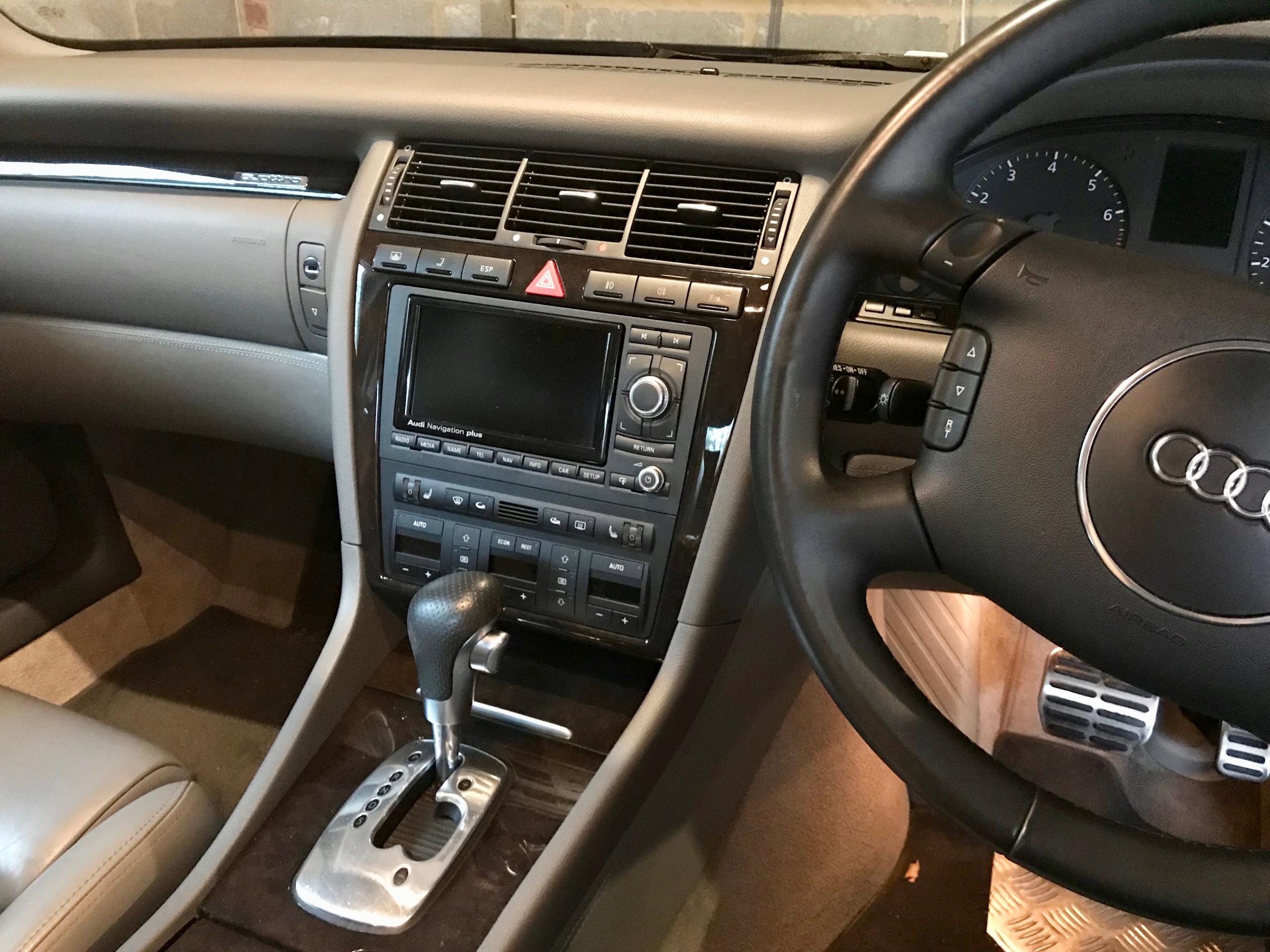

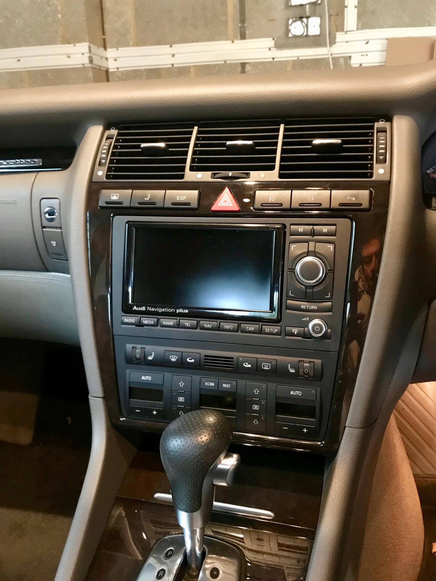

I can recommend installing RNS-E 2010+
With this system you can also have Audi AMI, Audi digital TV tuner, Audi Bluetooth, AUX input, reversing camera
Buttons on your steering wheel with work with it. Voice control will work, activated via Push To Talk button on steering wheel
Installing anything non-genuine will devalue these cars IMHO

Old 30th December 2018, 12:53 PM
Well then. I didn't know you had the mk2 installed! How did you get that working in the D2? I thought there were issues with the firmware / canbus in that version? Presume that's a mk1 A6 surround cut down to suit the D2 dash and fitted on to the mk2 buttons? Odd place to put the aux in though Would't it be easier to put that in the centre console?
While the RNS-e is a nice option to have, I can't see how many people could justify spending four figures on a head unit when better aftermarket units are available for £300. I don't see it devaluing the car to the average punter either since most aftermarket units come with Bluetooth and USB now too, making them actually useful compared to the RNS-d. If the car is sold to an enthusiast who actually wants a useless 20 year old brick in the dash then I have a stack of RNS-ds which I use as bookends Its simple enough to re-fit the original if its important.
Correct. Surround from mk1 A6 cut down and transplanted to A3 unit, which should have hardware version 04 or lower
Another trick is code the unit with A6 coding
Latest software version 220 will work fine with A6 coding, though it will not allow to code itself for A6 initially.
Workaround: Downgrade software to version 150, which will still accept A6 coding and then upgrade software again to 220
Additional useful stuff:
RNS-E 2010+ maximum road speed display feature
http://forum.a8parts.co.uk/showthread.php?t=7127
AMI installation on D2 (only works with RNS-E 2010+)
http://forum.a8parts.co.uk/showthread.php?t=7109
Adding auxiliary input and USB charging socket
http://forum.a8parts.co.uk/showthread.php?t=3148
