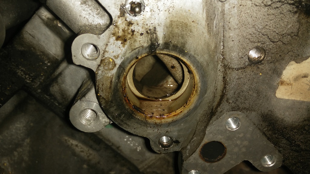

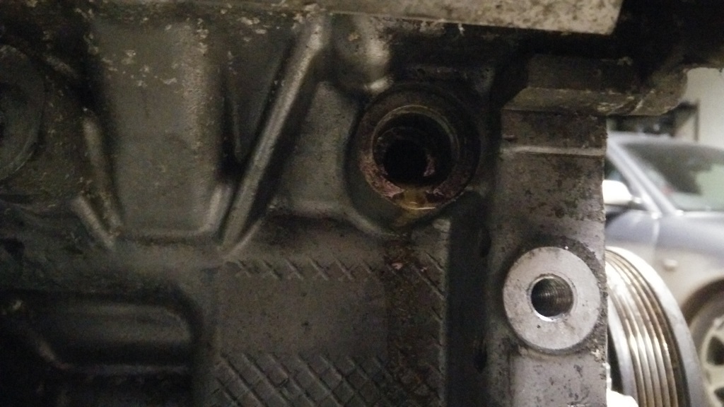

Hi all,
I acquired a V8 engine the other day which had popped its oil cooler and mixed oil with the coolant 🤮
If this was still in the car then I'd just run cleaning solution through it a bunch of times until it was clean, but its on a stand in the workshop so I'm pondering the best approach. Obviously all the external pipework will come off, as will the water pump and stat, but the heads will stay on.
I thought I'd canvas you lot for suggestions how to clean it
Go:

Funny you mention that - I've actually been pondering mounting a crank pulley in the lathe to spin the water pump via a long belt and pump some water-soluble degreaser round it
Jet wash connected to one of the inlets?
Liking that idea too I could put the degreaser in the shampoo bottle...
Oh, and if I make up a plate to go on the back of the heads per the last picture, I can flush each side from back to front exiting via the water pump housing. Hmmm....
