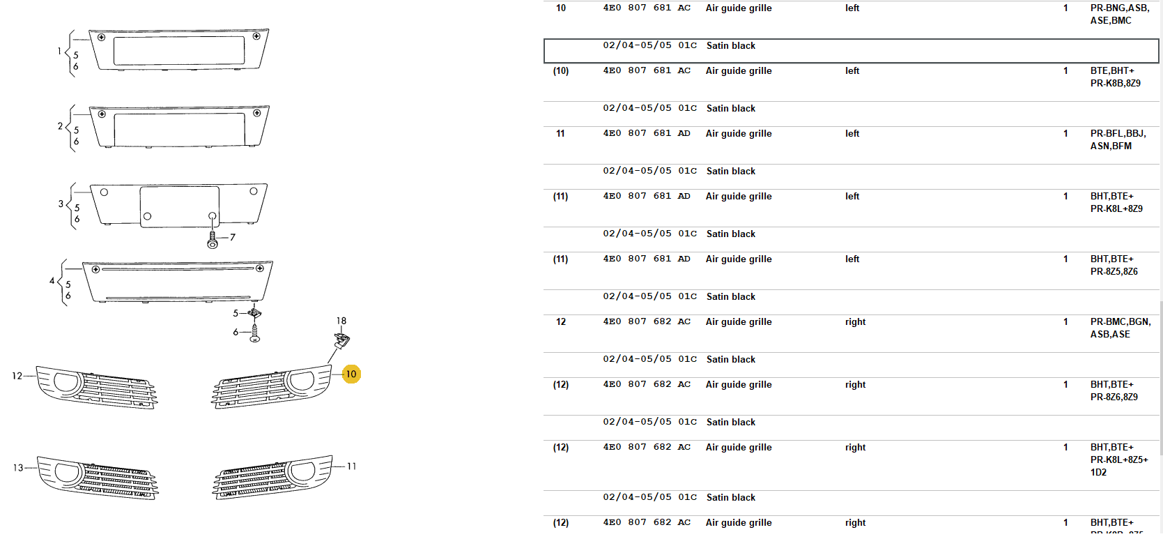

Front under tray (petrol?) - 4E0825235Q - £185.21 (front part only) - doesn't include fittings
Passenger wheel liner - 4E0821171P - £53.22 (front part only) - doesn't include fittings
Passenger fog light grill 4E0807681AC or 4E0807681AD - £75.14 (see image below).

I just popped the drivers side fog light thing off, with rather too much ease - 4E0 807 682 C
Doing an ebay search
Pair for £28 - Slight difference in the external rib around the light but if I replace both....and given there's a clip snapped on the drivers side it may be prudent. Now How bad are Chinese versions???
