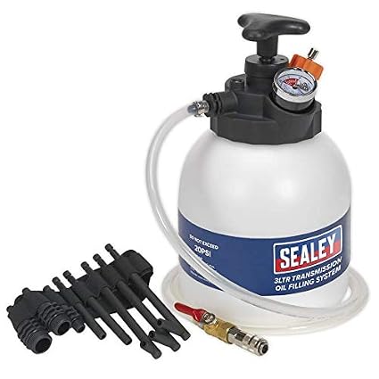

To fill it up again you really need a pump which can push the fluid up through the hole. I believe people have contrived solutions using bottles and long hoses, but really the pump is the way to do it. That's £75-100 depending on which one you get. I may consider lending mine if you don't have access to one. You also need VCDS to monitor the gearbox temperature.

This is the pump I use:
That's a reasonable price as long as they know what they are doing. It's easy to get it wrong.

https://www.ebay.co.uk/itm/HYDRAULIC...xBOh:rk:7:pf:0
