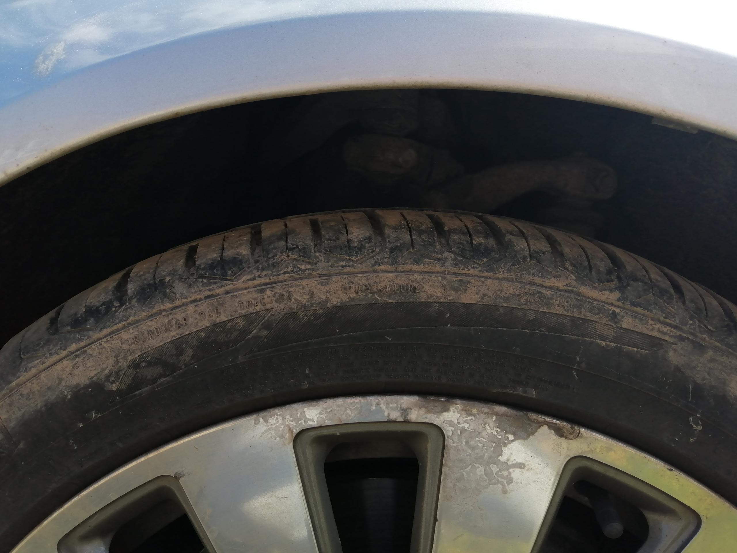

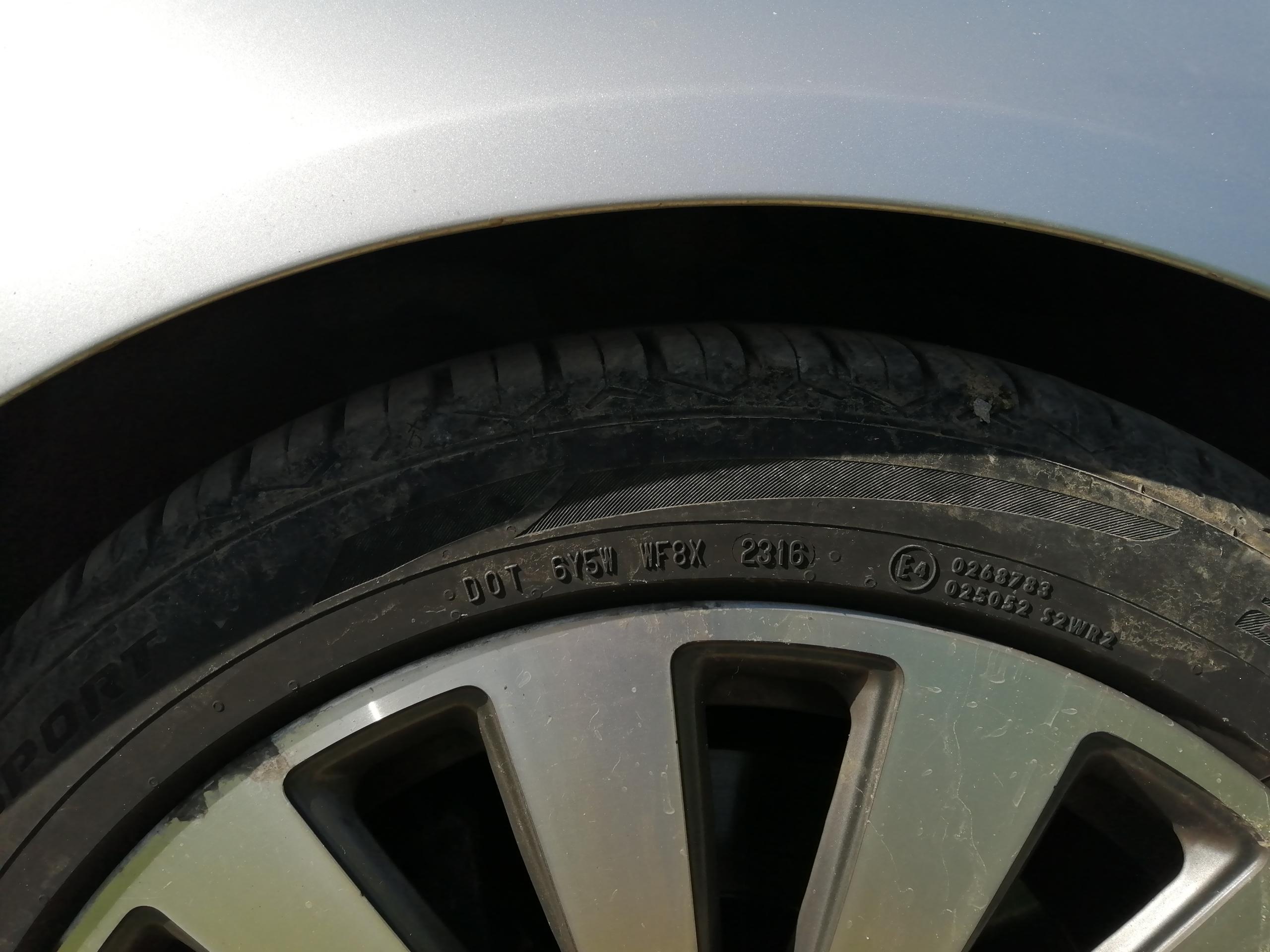

This morning, after sitting overnight the car height has not changed despite sitting there with battery disconnected.
You can see in the pictures what I was talking about, the passenger side rear wheel is has much greater clearance in the arches compared to the other three.
This is either because, I think.
a) there is a sensor problem and the car simply cannot level or,
b) the compressor cannot provide enough output to lift the other three wheels to the same height.

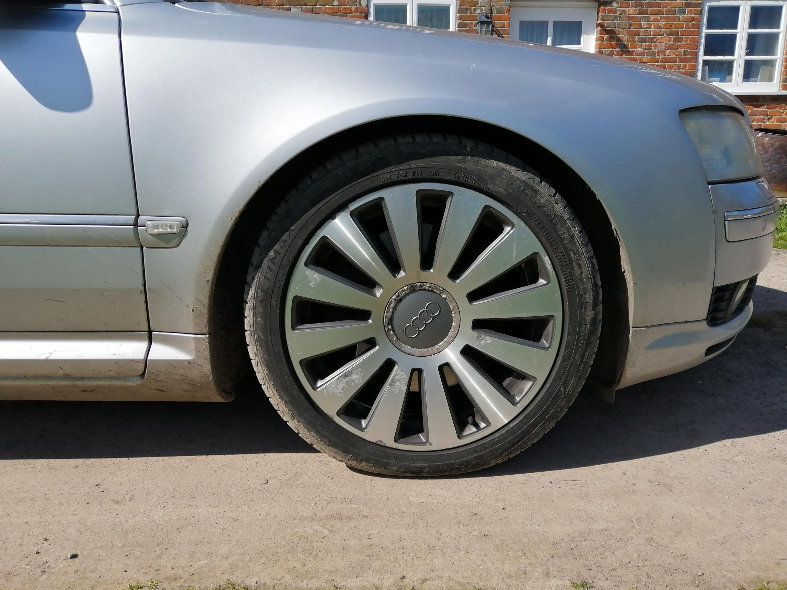

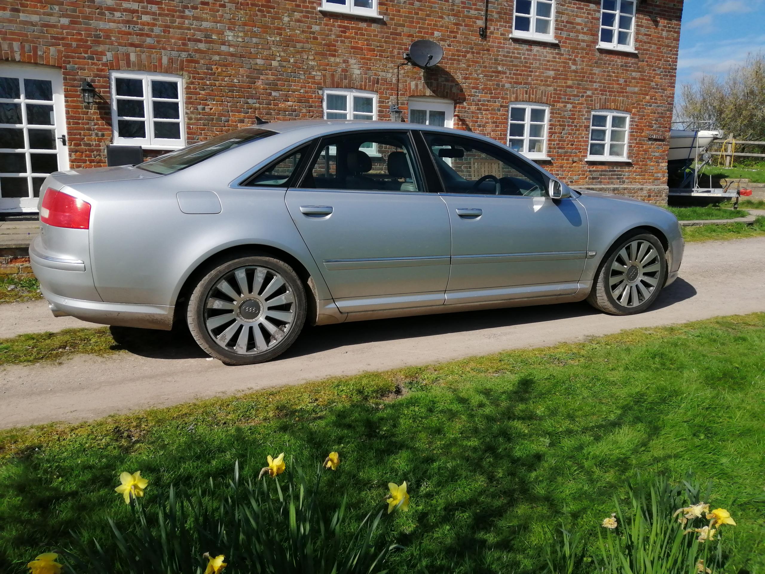

Been looking at this today, I think the drivers front strut has a leak.
I've been away all weekend, and the car was as I left it. However when you start the car the compressor starts and does not stop until the orange light comes on.
I left it a while and then restarted the car, and put the car in dynamic mode, the car appeared level but compressor still running.
I moved the car to flatter ground with Jack mode enabled, when trying to get back to auto mode the rear comes up fine but the front will not rise.
Looking at these pictures I think the front drivers side is low, does it look like it's on the deck. Compared to passenger side.
The first picture is passenger side, second is drivers.

I've done some messing about this afternoon, I have I think confirmed the drivers side front strut is leaking very badly.
I've basically been fooling the system by using a jack under each front corner and raising each front wheel so that the car tries to level the other one and then enabling jack mode and then removing the jack and watching what happens.
I now have air in three of the four struts, but the drivers front drops to the floor every time and I cannot get that one to rise when I place the jack under the passenger front.
Pictures of how the car sits now will follow, obviously as soon as I drive off and jack mode disengages the other front drops to the floor to match the drivers side.
