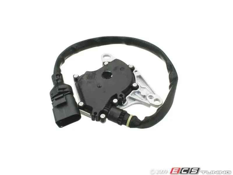

and this is an image I found of the 10-pin switch:

Now, I didn't follow this second cable to its destination (as the car was on the ground with the wheel turned out), but I did disconnect it at the arrow and it matches the image of the 10-pin one above (a flattened D-shape with 10 connectors, although only 9 occupied). That sort of confirms that I need the 10-pin version, but by way of triple checking it, can someone (ahem, MJ) confirm from the VIN and ETKA, that the 10-pin is correct.

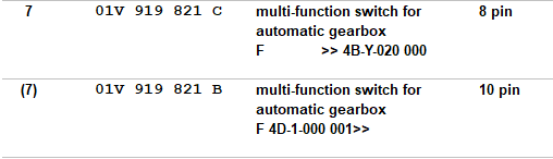

This is what ETKA shows for the F125 switch:
and my VIN number is WAUZZZ4D92N002072.
The VIN descriptions in ETKA have always confused me, but since my car appears to have the 10-pin connector, does the descriptions shown sort of translate to 'if your VIN is greater than 4D-1-000 001 then you need the 10-pin, but if it's less than 4B-Y-020 000 then you need the 8-pin'.
Exactly ^
The 9 and the N in your VIN are the two '-' in Etka's numbers so yours translates to 4D-2-002072 (effectively a 2002 model year) ergo the 10-pin switch
The change to the 10-pin switch is basically the start of the 2001 model year, but since UK registrations don't correlate directly to Audi's model year (which is August when they come back from their summer holidays) it can be a bit confusing.

Exactly ^
Brilliant. Thanks to all who responded and confirmed. Now to beak open the piggy bank.
