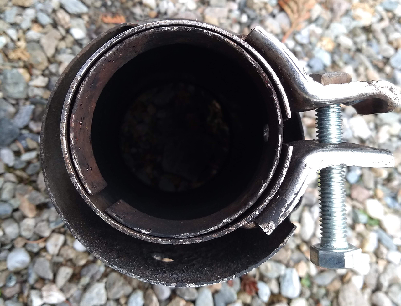

Assuming that they are all fitted the same way, then yes, you can remove them, and WD40 will be very useful.
If you look at this first photo, this is what the exhaust tip looks from the back. First step is to loosen up the bolt (I ended up replacing the old rusted bolt). I then used a large flat bladed screwdriver to wedge open the clamp a bit more.
The large offset ring is the chrome exhaust tip. The next ring with the cut at the three o'clock position is the actual exhaust pipe, and within that is another 'split ring' (not sure of it's proper name) with the cut at the eight o'clock position.
If you look at the second photo, I've moved the inner ring so that you can see how it's constructed, and this is what ultimately holds the exhaust tip in place. Once the bolt is loosened, it's then just a case of twisting and turning the exhaust tip until it comes off, although after faffing about with it what seemed like ages, I can't remember how I finally managed to remove it.

I would think that the inner ring is a support to stop the exhaust from being collapsed by over enthusiastic spanner use on the clamp bolt.
But from those photos I cannot see how the chrome tip is held.
Is it in fact just a push fit?
Old 18th June 2019, 06:02 PM
Posts: 3,227
The chrome tip is welded to the middle ring (one spot at the top back which you can just about see at the 12 o'clock position and one spot at the front inside lip), as are the two parts of the clamp.
From the shape of the inner ring, I was thinking that it was to allow for better alignment of the exhaust tip.

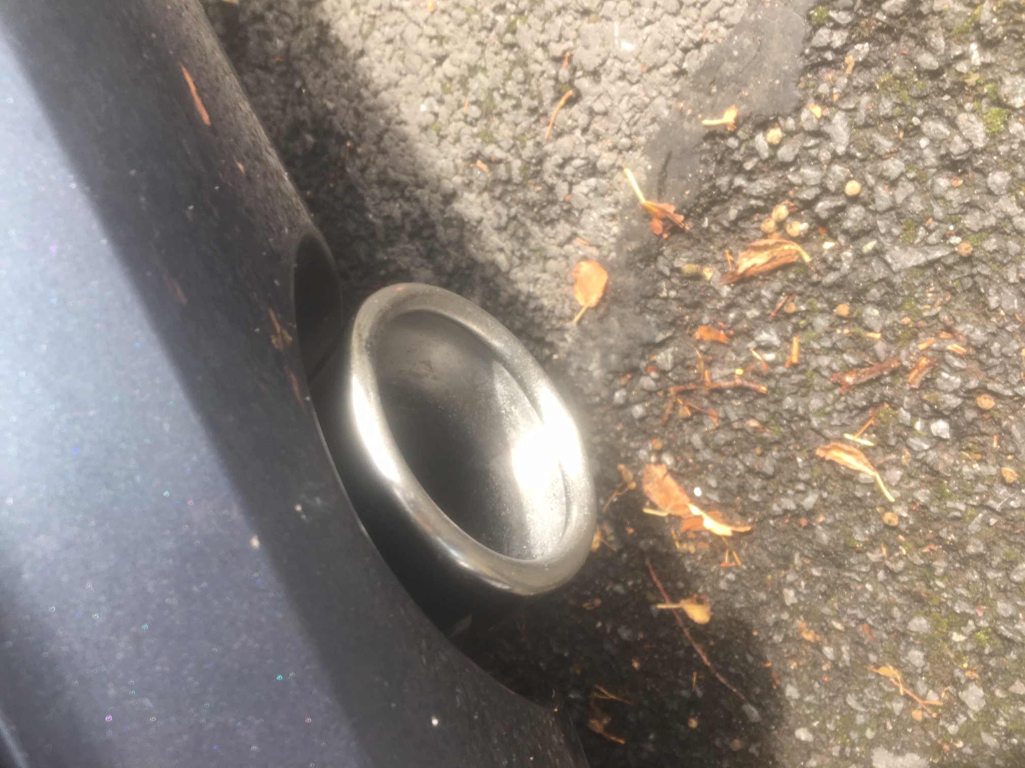

Hat tip to Snap dragon on the oven cleaner tip. I taped off the bumpers and gave a liberal spray of BBQ cleaner, outside and in. Left for about two hours and put newspaper underneath. I bought a bottle scrubber, took off the handle and used a drill to clean the inside of the tips with bucket of hot water to dip the brush in and clean as i went. Then i hit it with t-cut metal polish. Took me less than 10 mins per exhaust tip.
Compared to the hour or so I see detailers using tons of metal polish this was a super hack. The BBQ cleaner literally hoofed the carbon deposits off...
Nice one Snap...
