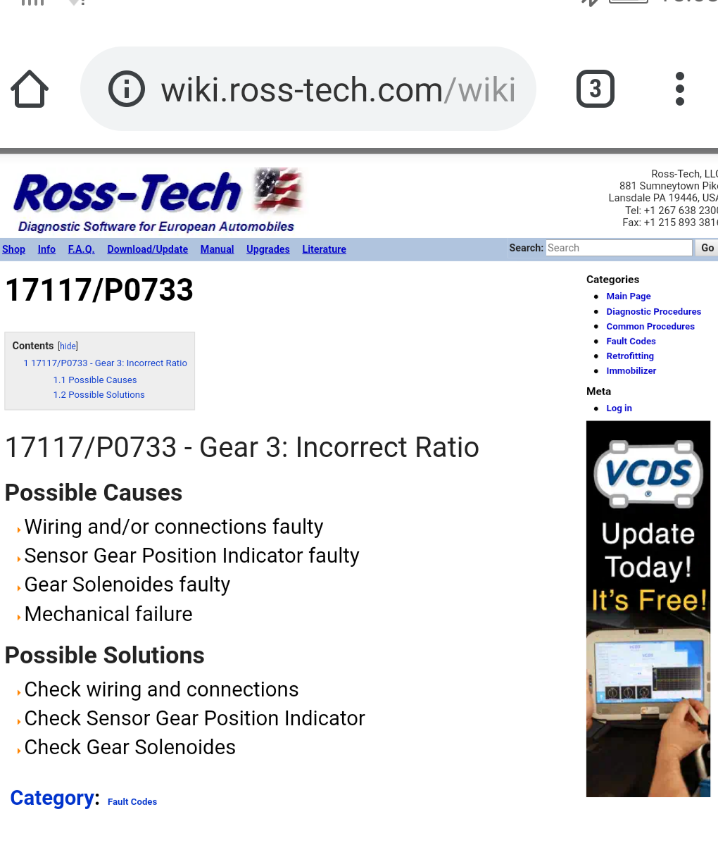

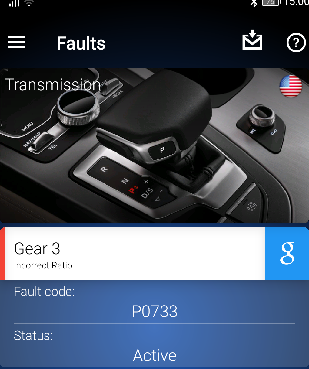

Old 24th August 2019, 02:03 PM
Posts: 3,843

Any idea what the solenoid current should be? Most are 0.144A but one is 0.742A?
Also strange that fault code says Gear 3 but problem seem to be with 1st.

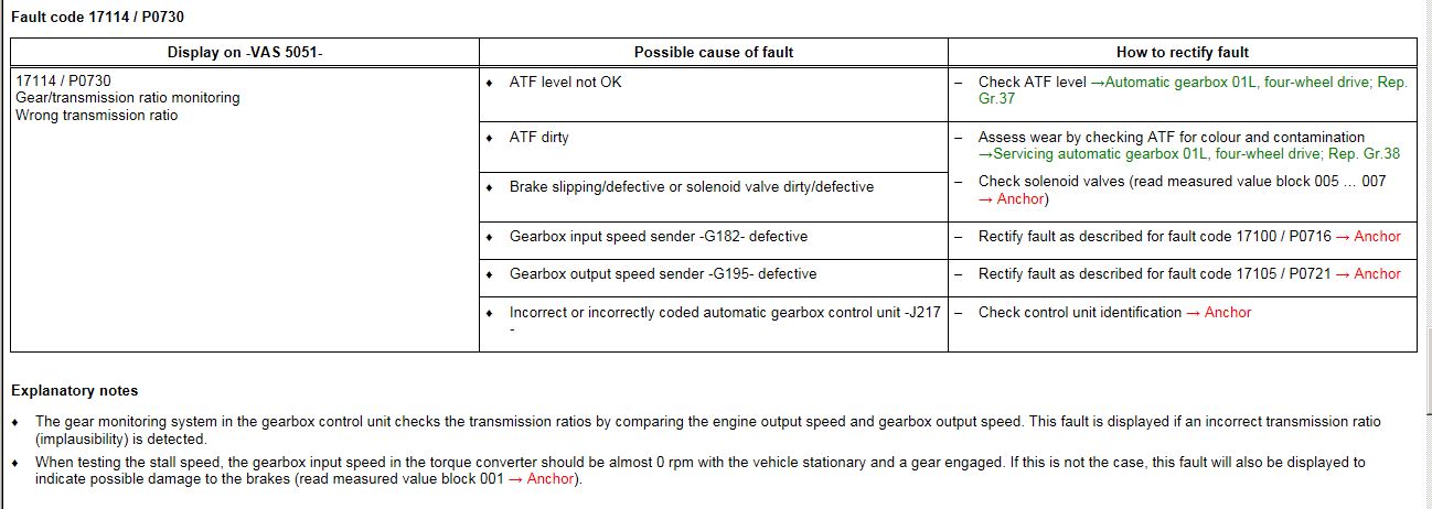

This is what Elsa say
ID:	22099   Click image for larger version

As soon as I move off, jolt and fault code registered for gear 3 when it's only been in 1st, if I manage to get to 2nd all other gears work fine including 3rd until it selects 1st again.
