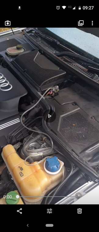

I've had problems on both of my A8s with the classic cowl drains getting blocked with leaf debris. Due to the design of the car and the location of the air blower motor, the drain hole gets blocked and fills the area with water. This can be seen with the aid of a torch if you look downwards to the right of the blower motor. Photo attached showing my syphoning procedure with a length of soft plastic hose/tubing using gravity to decant the surplus water.
I've replaced the blower motor 2-3 years ago so I know what's involved in removing/replacing it but the motor sits in its own little plastic cubbyhole so that would have to be removed as well. Far too much hassle in my view so I invested in an endoscope camera that attaches via USB/OTG to your phone or tablet. The camera was inserted where the plastic tubing was located in my first photo. There are a couple of short videos attached, showing the swimming pool of water in the first clip where you can just about make out where the hole is on the left-hand side. The second video shows me using the camera to poke around a bit to clear the debris and then flushing some water to clear it. I hope this proves useful to others to visualise exactly where this hole/drain is.

I purchased something called 'PiAEK Endoscope Inspection HD Camera 3 in 1 Endoscope Android USB/Micro USB/Type-C 2.0 Megapixels Waterproof Camera Semi-rigid Cable Borescope' for about 20 quid from that well-known rainforest company. The smart phone/tablet app suggested by the manufacturer was completely useless and didn't work at all, which was surprising as [1] they made the camera and [2] they'd gone to the trouble of displaying a QR code on the instructions/marketing blurb.
In the end, I downloaded some generic endoscope app which works fine (apart from a somewhat clunky interface with dodgy spelling). I'll be honest here and say it's probably one of my best purchases. Before I even got to work on the A8, I was sticking the endoscope down plug holes and inside the waste pipes on the washing machine at home.
Whilst the majority of the length of the supplied camera cable is fairly rigid, I added some strength to it by supporting it/taping it to some stiff metal wire so that I could direct the angle of attack. The first 20 cm or so is normal softer USB cable so care needs to be taken in supporting the USB/OTG adapter where it fits in to your phone or tablet. Despite the camera being about 7mm, it has an LED ring of 6 separate lights which is controllable via a potentiometer alongside a push button, which I assume is for taking pictures. I obviously didn't read the instructions 'cos I'm a bloke.
