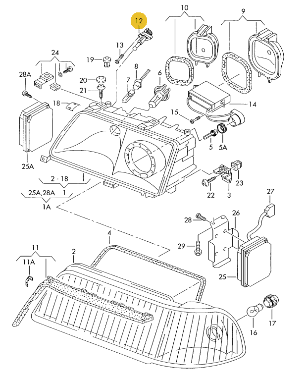

Not sure what sort your headlights are, but here's an illustration showing the control motor (#12).

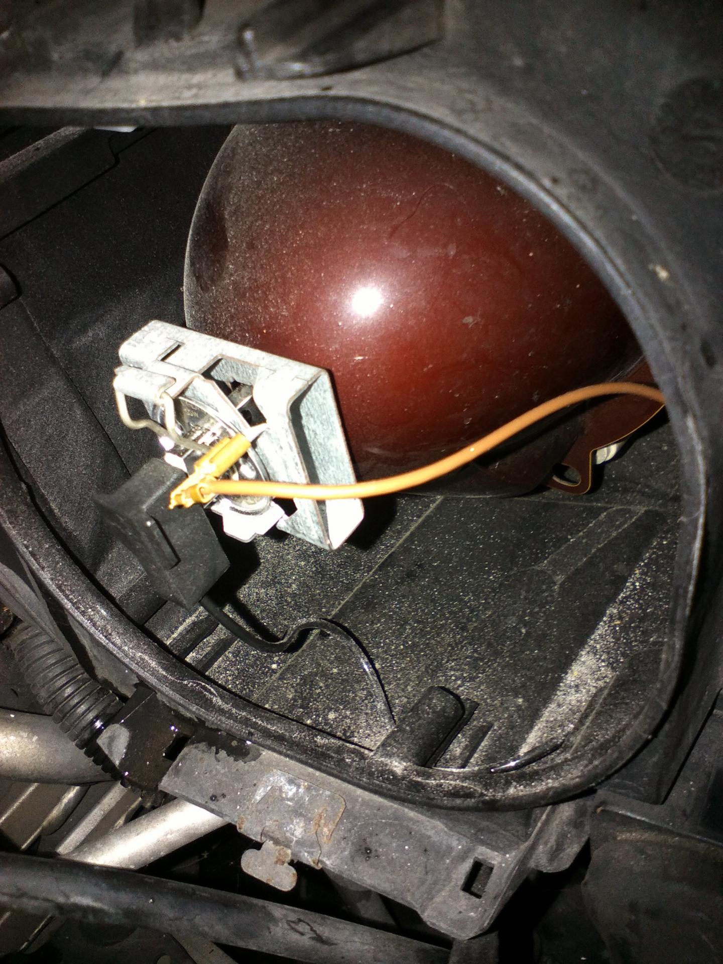

well, I got out and got under and the problem is the circular dipped beam light which has a peculiar connector at the back , just a wire bracket or similar
any idea what exactly this is ?

That just looks like the wiring to the bulb, the height adjustment will be elsewhere on the body of the reflector mounting.
Is it an H1 bulb, or similar? They just have a single blade connector, the return circuit being via the body/base which in your case goes to the yellow cable.

Just went out and checked mine, and it's the same. The following photo of mine shows the actuator in situ (highlighted in red). It is located inside the headlight unit in the corner closest to the radiator, behind the other back cover.

I've just had a look at the spare headlight unit that I have, and can confirm that it is attached by a single screw (from inside the unit). If you look at the illustration I had in a previous post, you'll see part #13, which is the retaining screw.
As Andrew said, our sponsors may be the best guide to how they removed them (assuming the unit wasn't damaged at the front). It may be possible to use a screwdriver bit on a ring spanner to undo the screw, but it could be very fiddly.
You will need to ensure you get the correct actuator for your headlight though. If you just have Halogen headlights, then the part number is 1J0941295A, but if you have the Xenon headlights, then the part number is 4B0941293A
