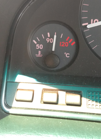

Default Rare to see the temperature gauge move past 90 degrees
Wow, it has been a scorcher here in NSW, Australia for the last day of the year.
I know that the temperature gauge in the Audis are weighted so that they show as 90 degrees so long as the actual engine temp is within design range (86-105?).
It was so hot here today that I have seen the gauge creep to where I have never seen it before.
Coolant level is good and thermostat replaced in September 2018, so I am attributing the movement of the needle to that, as I was going slowly in traffic.
ID:	22648   Click image for larger version

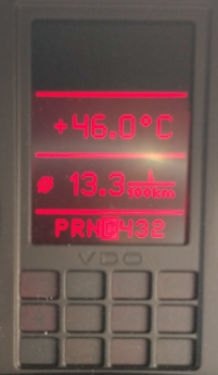

46 degrees Celsius?? Seriously?? I'm not a big fan (every pun intended) of the cold but that is just outrageous!

Well, I suppose I was having a bit of a laugh there, as I honestly don't think the actual temperature got that hot...more like 42 degrees Celsius would be closer I reckon...but still pretty hot, no?
Out of interest, where is the sensor responsible for that readout located?

The outside air temp sensor sits on a panel that runs forward from under the radiator to the front bumper.
You could probably see it behind the lower centre grille (under the number plate) with a torch.
