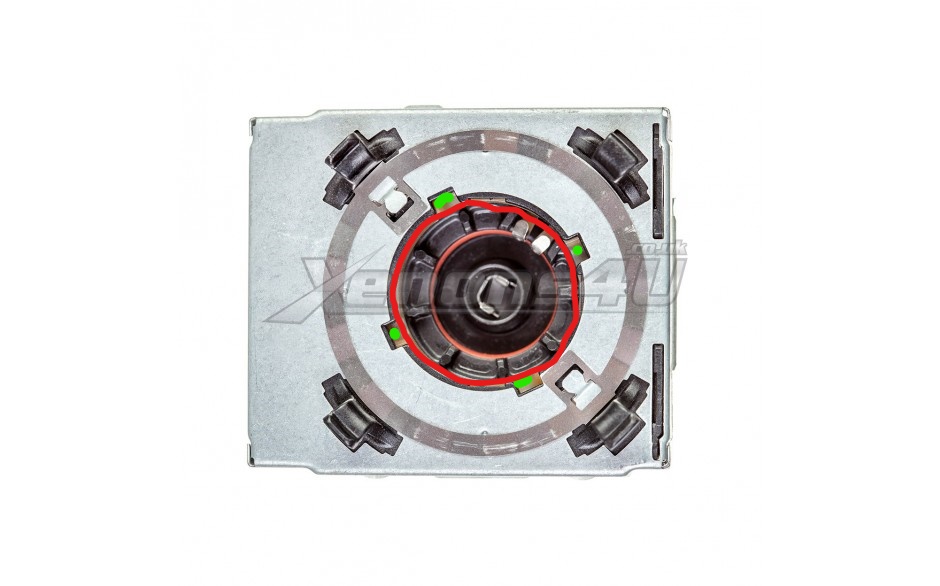

You are not the only one to have had this issue, I felt like putting a hammer to it!
The answer is simple, inside the igniter there is a brown (or white?) ring with notches. This needs to line up with the notches for the bulb. This way the bulb goes in properly and the igniter will turn fully.
It will make sense when you see it, I searched the internet like mad but there wasn't much info on this
Old 25th February 2020, 08:08 PM
homer simpson's Avatar
Join Date: Nov 2013
Posts: 1,142
The green notches should be clear of the plastic ring (red area). This plastic ring is what is stopping the ballast from turning fully as the bulb is not seated correctly.
