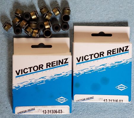

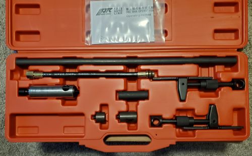

I ended up buying this valve spring compressor kit since the other two that I bought didn't work. The kit has arrived and I haven't used it as of yet.

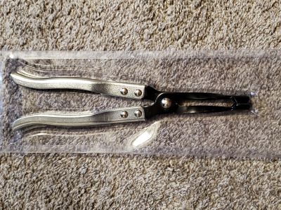

I bought new valve stem seals and valve seal pliers.

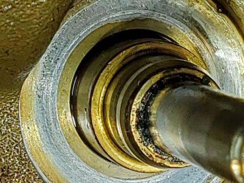

I removed one valve seal and here is a close up picture of the old seal.

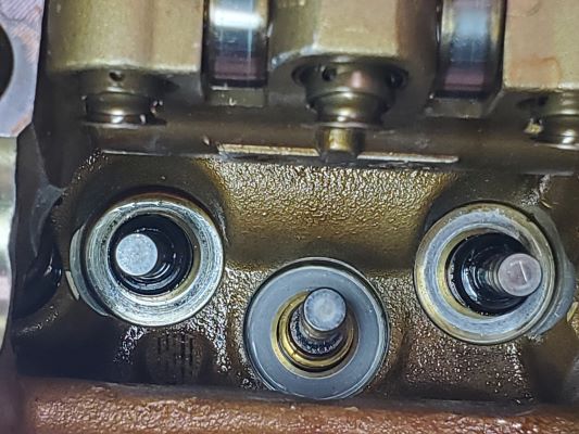

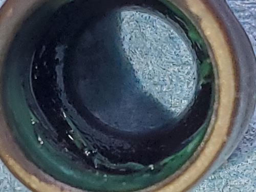

After removing the other two seals, here is a close up picture of the crud on top of the valve guides. What is the best way to clean this off?

Brass wire brush and carb cleaner. Make sure the bristles are actually brass and not plated steel.

Well this is disappointing. I quick did a pre-setup of this new spring compressor kit and I found out there will be no way that I'll be able to use it for the exhaust valves. As you can see in this picture below (I know I have it setup for the intake valves) there will be no room to use this kit for the exhaust valves because of the brake lines to the ABS unit. This is just frustrating! Now it looks like I'm going to have to remove the cylinder heads to do this job which I was trying to avoid.
MJ, do you have any tips on how to remove the cylinder heads with the engine still in the car? I really want to avoid pulling the engine out of the car.
