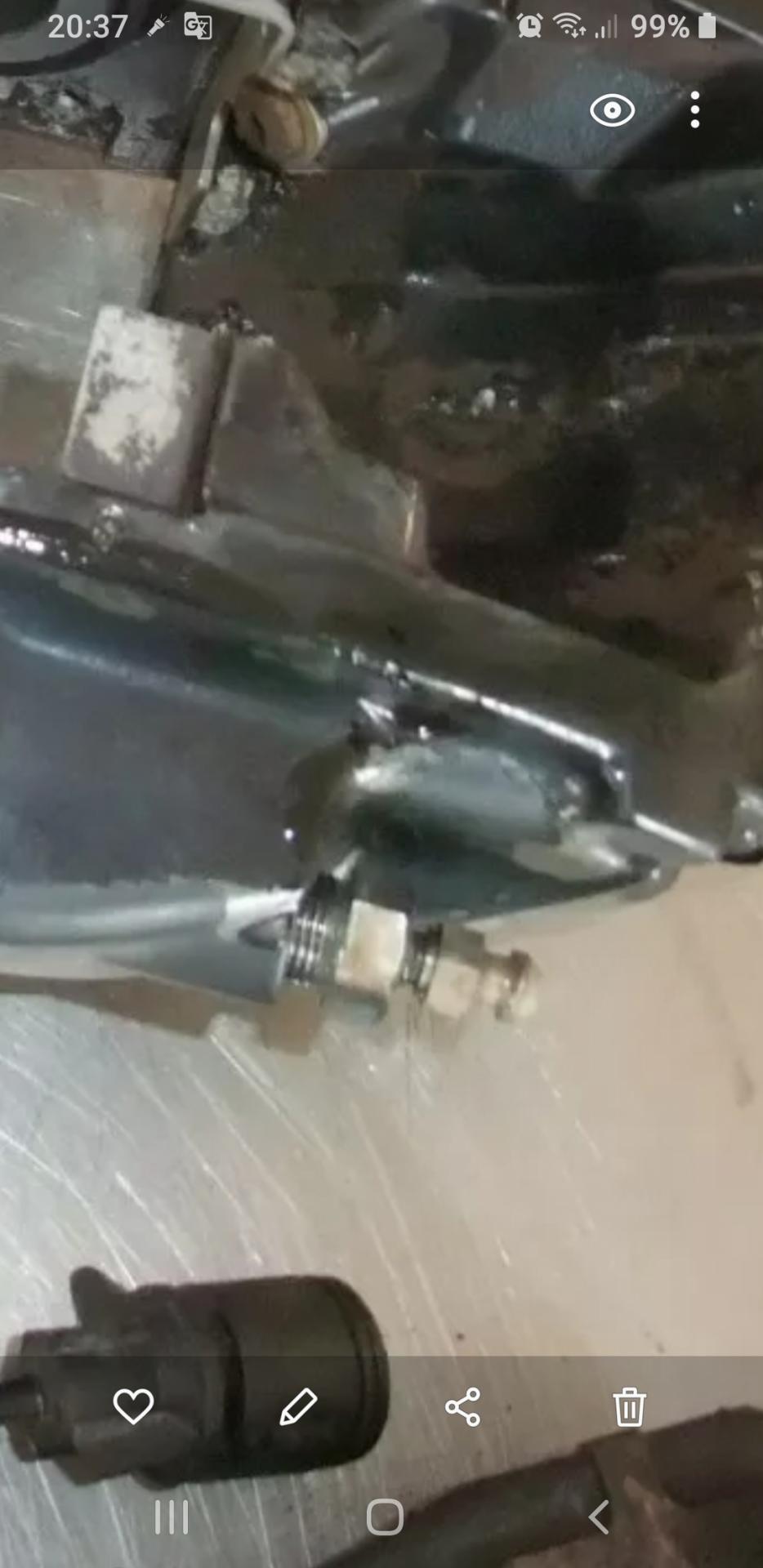

Just found this image of a caliper that's on ebay at the moment. Is this an acceptable repair for the bleed nipple? Looks simple enough.

Yes I would think so. One of my nipples was 'bunged' in the past by some cowboy who didn't want to get it repaired properly, probably stripped the thread. It went to BCS and they put a new larger threaded nipple in. I'll upload a pic if I remember tomorrow
