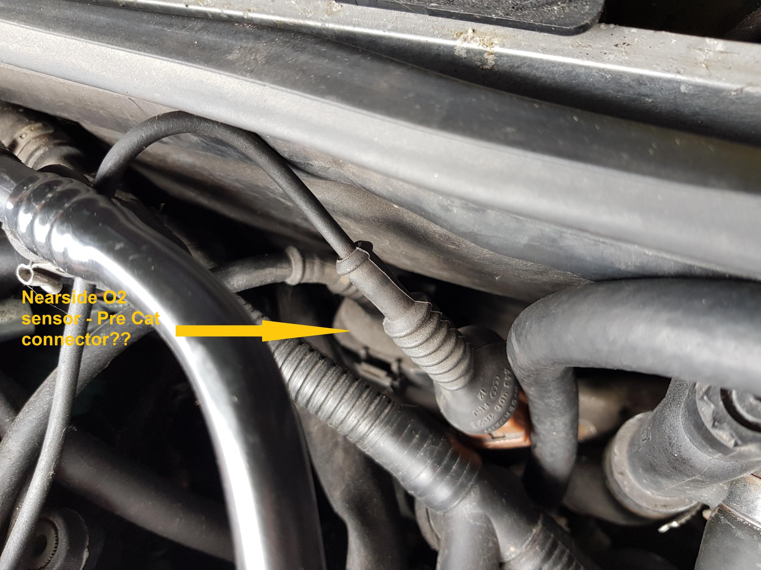

1: On the downpipe I find two O2 sensors (lucky me) and can locate the connector affixed to the bulkhead for the pre-cat sensor, but Im struggling to locate the rear connector. I am looking at the tight tangled mess of pipework in the way and thinking why did I start this Can anyone advise where to spot the rear sensor connector? I am thinking once found to run some string through connected to the cables, as I have no other method of re-routing upon replacement? Otherwise, is it a good idea just to unbolt the sensors from the exhaust, leave them in the car and take said exhaust away?

Old 14th June 2020, 05:00 PM
Join Date: Jul 2011
Location: Gosport
Posts: 429
The connectors for the secondary O2 sensors are underneath the trim panel behind the airbox..
Well I found them, logical place to be i guess (note the cynicism). Ok, before I go any further I managed to detach the connectors (so far so good). The route for the post cat sensor seems doable with 4ft arms and tiny hands but the pre-cat connector against the bulkhead is jammed up with more pipework than I have seen on the QE2. Now before I go 'postal' and start taking apart pipework to get this thing to route back through, am I missing something? (part of my brain I am now thinking)
The postal route would involve cutting the cables to the existing sensors, removing downpipe, source new downpipe and source new sensors. I have had a look online and prices vary for the sensors so advice welcome on this course of action as well.

Old 14th June 2020, 08:54 PM
It would be a shame to cut the wires to good sensors. You may be able to fish it out from underneath?
