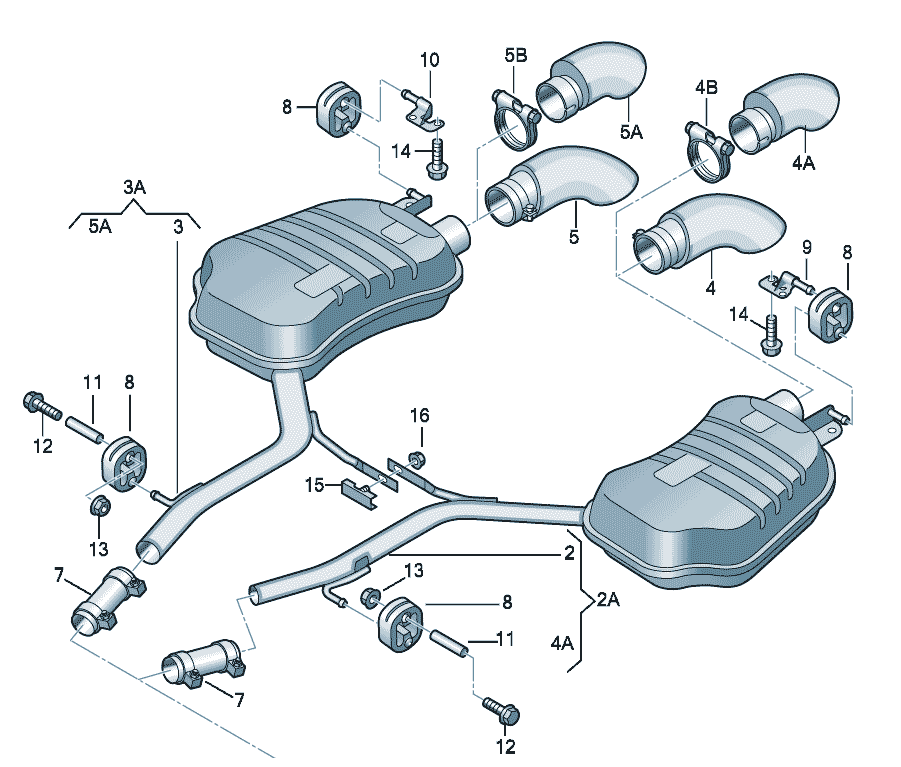

There are two different options for the 3.0 engine, a straight pipe, part number 8K0253683J (£126) and bent pipe, part number 4E0253684S (£165). Both are shown as being clamped on. I would think for those prices you could probably get a pair of tips fitted by an exhaust centre.

Yes, that's my problem - my exhaust is nothing like what's shown on the parts diagram, it's all one piece with no clamps anywhere until you get halfway towards the front of the car. Are there any marks that should be anywhere to determine if my system is OEM?

Posts: 3,843
That's pretty normal from factory it's all one piece. If part of it need to be replaced they cut it off and join with clamps.
Ah OK...that explains what I'm looking at so. I'd been thinking had I a replacement exhaust fitted or something. Thanks.
