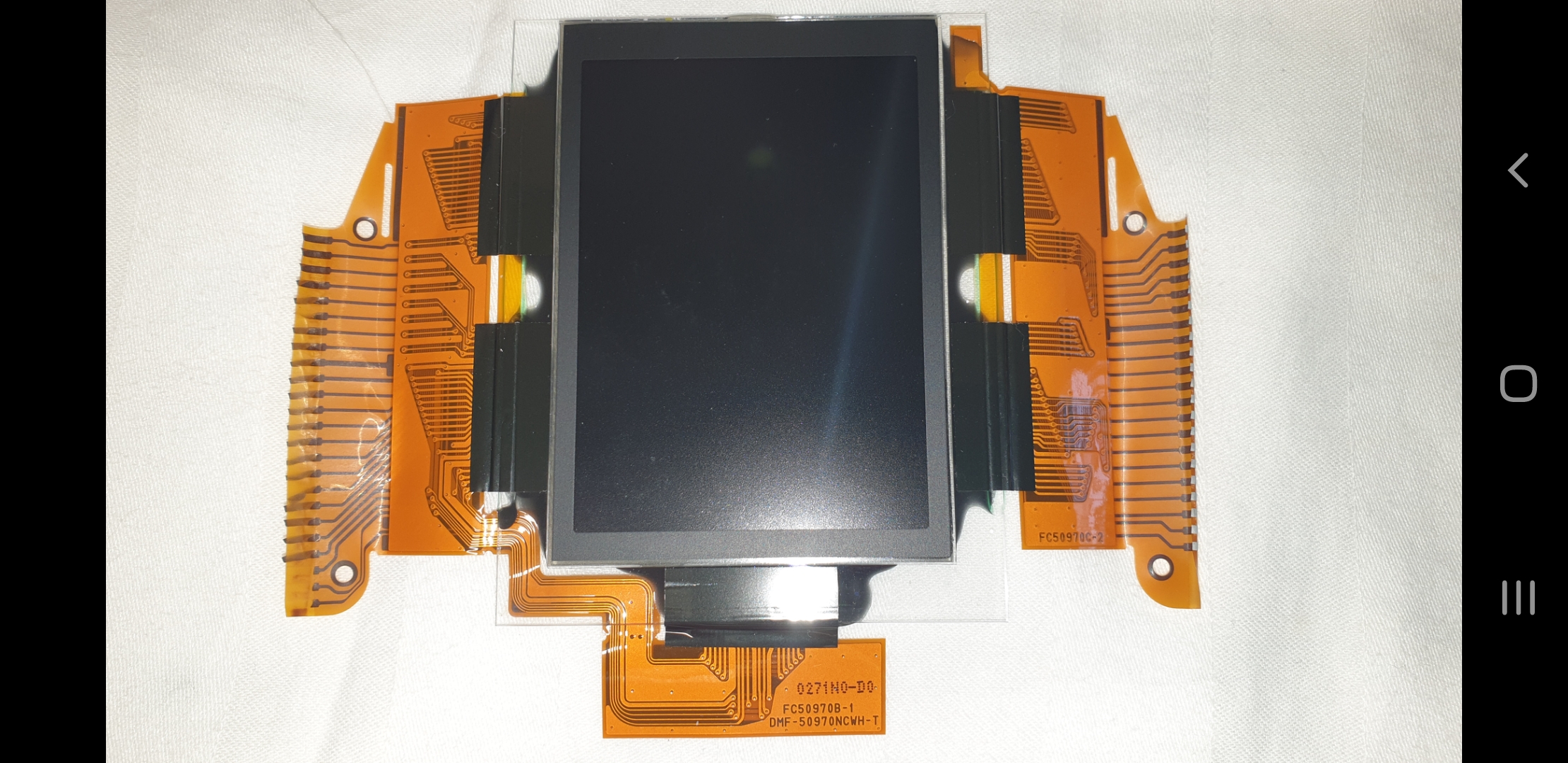

Hello all.
I have sent the below email to Sacer and Totaltronics. I'll let you know if I get a response.
"Hi*
In the attachment is a picture of the screen fitted to the above car (Audi s8 d2 2002) . As with many cars of this age, they start to fail. I can't find anyone who has any of these as a DIY or a complete repair service. Can you help at all.*
Thanks Frank*

Just to be clear..... are we all talking about the same screens here?
I'm talking about the ODO/trip and time/date, but the one in the pic looks like the larger, central semi-colour display?
Patryk at TotalTronics reckoned he could do the smaller ones when I discussed it with him.
Need to chase up Sacer......

Yeah..... Sorry Nick, I am actually talking about the color center display. Misunderstood your thread. I'll jump to the thread that's specific to this display when I get something to update.
