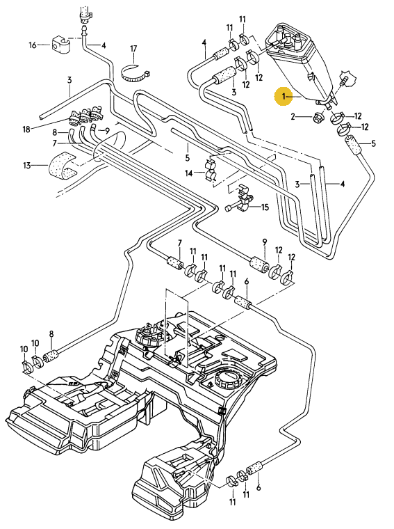

Have you considered the activated charcoal container (1 in image) being blocked?

Its certainly concievable it could be that. What I think is happening is that one or more of the tank vent lines (6-9 in that pic) are unable to vent and so the tank fills to the level of the filler neck leaving a large air pocket in the top of it. Its not clear from the diagrams where those lines go, but I think they go in to the large assembly behind the filler neck first, which then has a single line (4) over to the charcoal container. In theory the only open point is 5 which is right on top of the tank.
I won't mind too much if its the charcoal container which is blocked as thats relatively easy to change. I will be a little grumpy if its the thing behind the filler neck as that has pipes everywhere and many rusty fittings. However, I shall be very pleased if its either of those compared to having to swap the whole tank!
I took all this stuff out of Sergey's car relatively intact so I need to get that off the shelf and see how everything goes together.
Its been pointed nose-down overnight so I'll nip up to the workshop (vigorously!) in a bit and see if I can get an extra couple of gallons in there. If so, that would suggest its a partial blockage somewhere which just can't vent as fast as a petrol pump can put fuel in.
How accessible is the charcoal container? Is it possible to disconnect its combined input from the tank vents (4 in the diagram) and see if it then fills normally (just the last 2 gallons from a can)?
That would narrow it down to the charcoal canister or plumbing.
By the way what is line 3? Is that a vent from somewhere else in the fuel system?
Old 12th November 2020, 05:36 PM
Line 3 goes to the front to the N80 evap valve.
The charcoal can is equally as vexing to get to than the 'expansion chamber' on the other side (which is what Elsawin calls the big lump all the vent pipes feed in to). Arch liner out, then a bunch of hose clamps, although all stainless rather than the sad rusty lumps on the other side. Although, I had the left side arch liner out when I repaired the sill so that's like to come apart more easily than the right side.
It could be disconnected from either side tbh. I might try that before I get out the parts cannon
