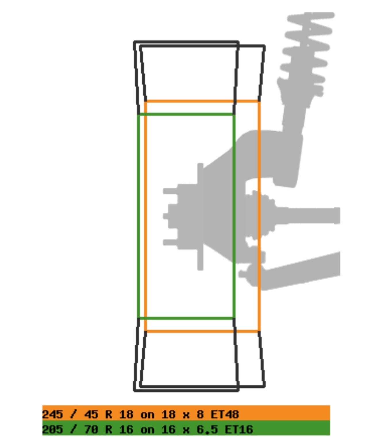

Checked wheel spec on tyre calculator and seems like it should be just fine.
