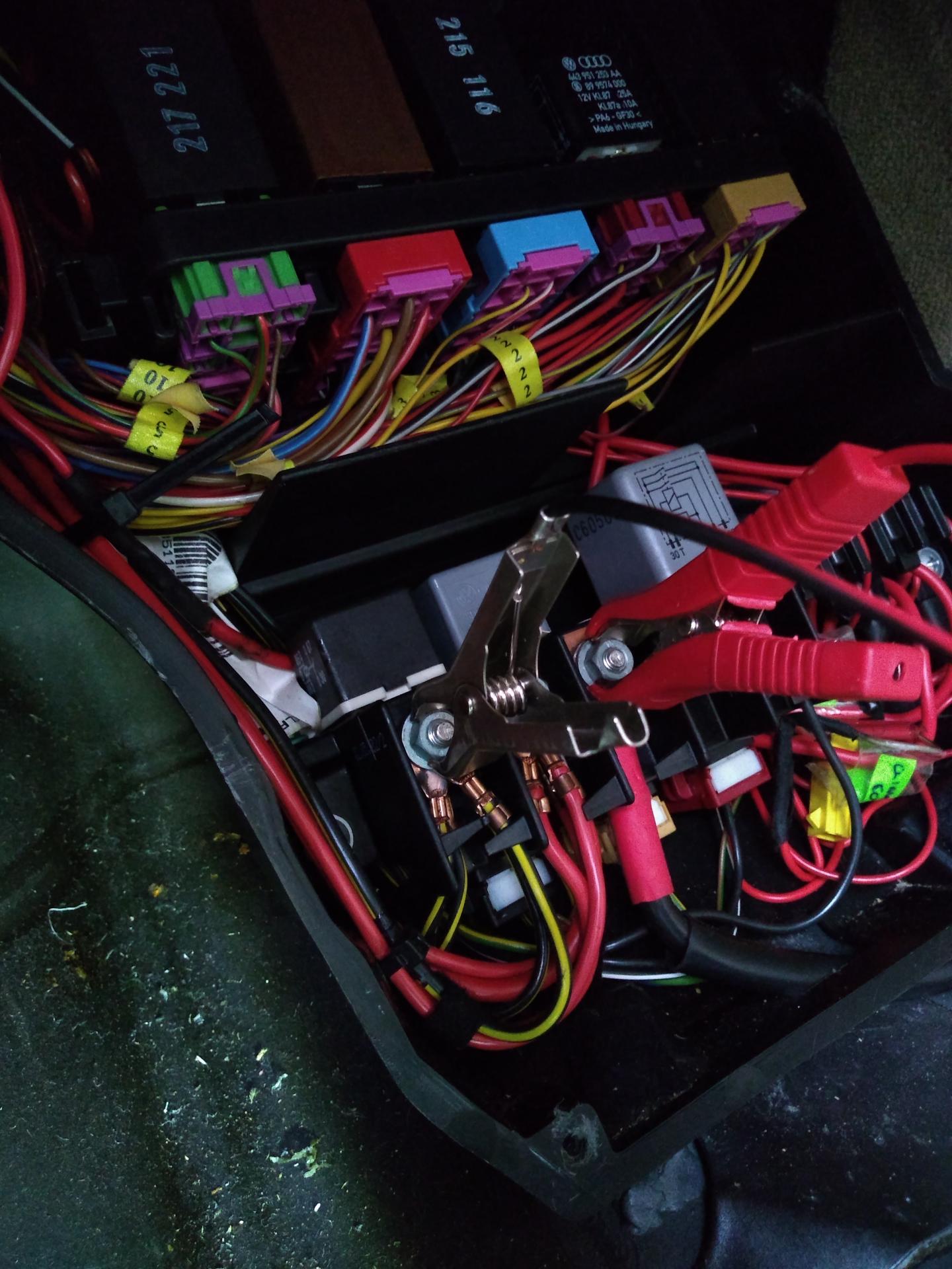

Have opened up the Px footwell electric box and identified (i hope correctly) the +ve and -ve terminals. I would appreciate confirmation of the photo attached .
I have measured voltage across these 2 terminals and there's approx 2.5V. However, on connecting my (cheap Aldi) charger it indicates that battery is faulty and wont attempt to put a charge in. Would it be OK to connect another battery across these terminals?

That black and yellow is switched igniton.
At the base of the box are two bolts covered with fabric tape. I'd suggest peeling the tape off and using one of those as ground.
^ what the doc said.
Charger or Battery makes no odds, either should give you a bit of juice to get the boot open.

Job done! Many thanks for help👍
