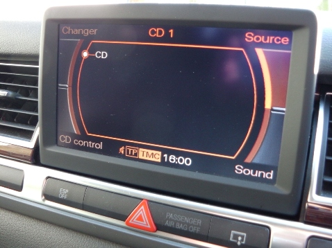

This is the MMI screen with analogue TV fitted.
......and this is what I got with the hybrid.

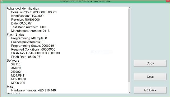

The hybrid shows up in VCDS but not on the MMI screen.
VCDS scans of analogue and hybrid:

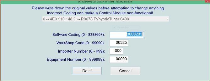

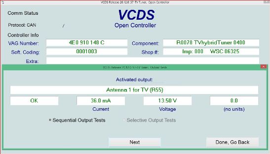

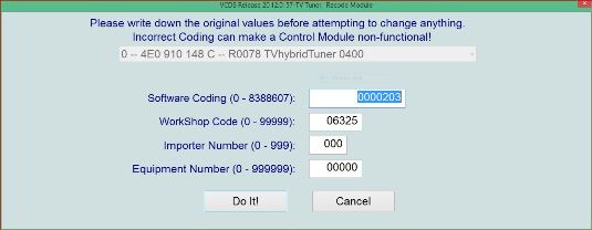

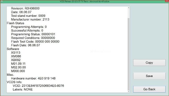

Took some screenshots, but I don't pretend to know what it all means:
In VCDS on the hybrid screen, I clicked on coding (I think?), and a little box came up asking me to confirm coding, then it said 'coding accepted'. Still nothing came up on the MMI screen.
Connected all the plugs back in the analogue tuner and the normal CD, TV AV 1 & 2 came back up on the MMI screen. VCDS also showed the analogue TV back at address 57.

From what I can tell from the pics, you have Rear Seat Entertainment in your car?
If I'm reading the coding for your analogue tuner correctly, it's:
000 - all good
1 = RSE fitted
0 = A6/A8 model coding
03 = UK
At the moment it looks like the hybrid is coded for:
000 - all good
0 = NO RSE fitted
2 = model code, so presumably for A/S5
03 = UK
So basically you need to tell the TV module what the spec of your car is, so that it relays the right information for the MMI to pick up (assuming this module is actually compatible with your car)
It's unlikely to show anything on the MMI until the module is coded correctly
ETA - so in very basic terms, you need to copy that coding string that you use for the analogue tuner, and enter the same into the 'software coding' box, and click 'do it'. The little pop up box should guide you - wherever the ? appears, it's basically giving you a guide to which digit relates to which function from that list - hopefully explained as I've posted above

No rear stuff in there I'm afraid.
So, I put in: 0001003
Is that right Adrian?

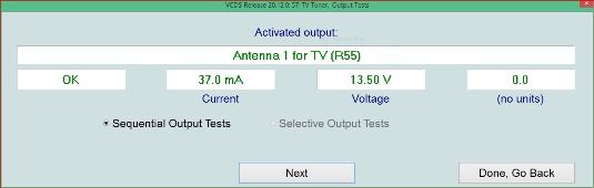

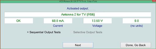

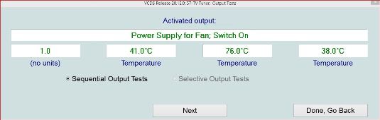

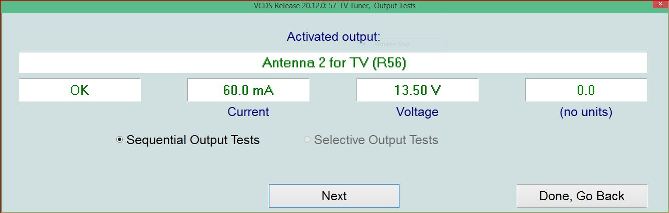

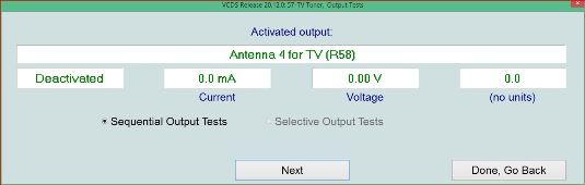

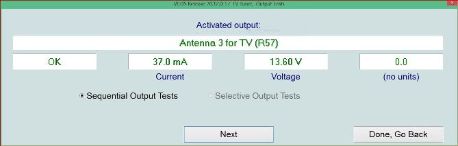

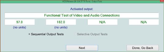

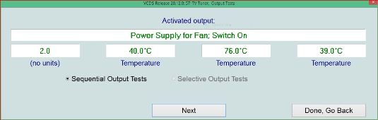

Also, do the antenna outputs look ok?
Number 4 seems a bit iffy.
2004 A8 D3 4E2 3.0ltr Petrol............baby A8

If you don't have RSE then the code would be 0000003.
Did VCDS throw up an error for antenna 4? Just curious since the output test shows it as 'deactivated'.
BTW The part you have; 4E0910148C; is fine. The A8 will accept A,B,C and E.
Ah right, so I put in 0000003, and click 'Do It'.
Got no idea why the 1 for RSE is there, I've never messed with the TV at all.
No error for antenna 4. Is it possible to activate it?

On a brighter note. The number 4 antenna has decided to come out of lockdown.

Based on what IT said, once you've updated the MMI to the 5570 version, it should be a straight swap, with no coding required. However, based on the pop-up prompt from VCDS, the coding should be 0000003 i.e. 000 by default, 0 for NO RSE, 0 for A8 and 03 for UK.
