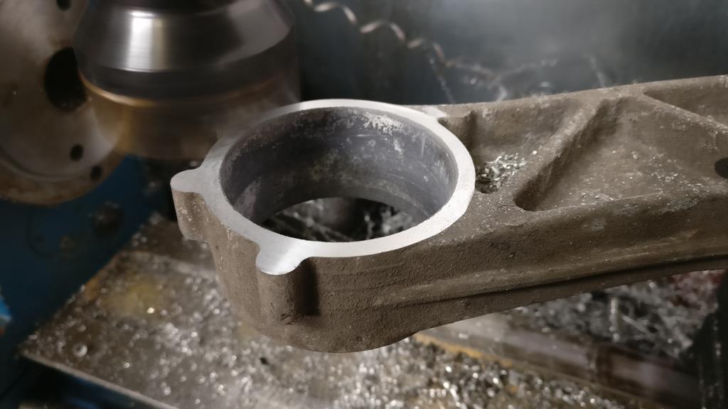

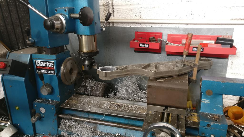

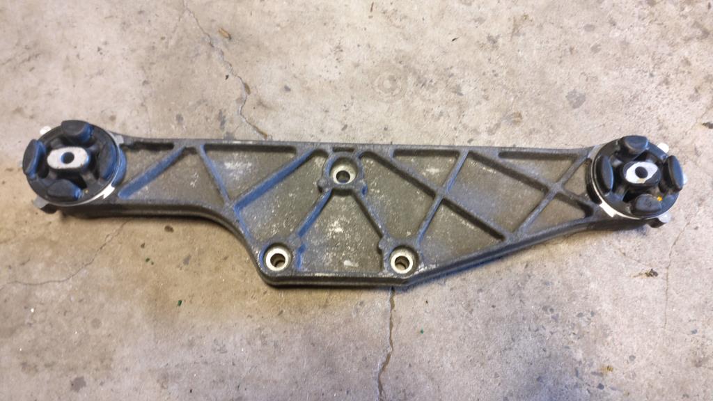

So I did indeed mill down the rear diff mount yoke 2mm off each side makes it the same size as the D3 yoke
D3 mounts now fit perfectly Happy to do these on exchange with or without bushings if anyone else wants one, since its not really a DIY task.

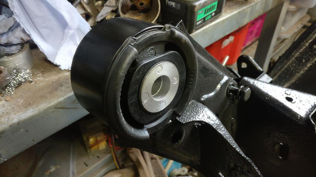

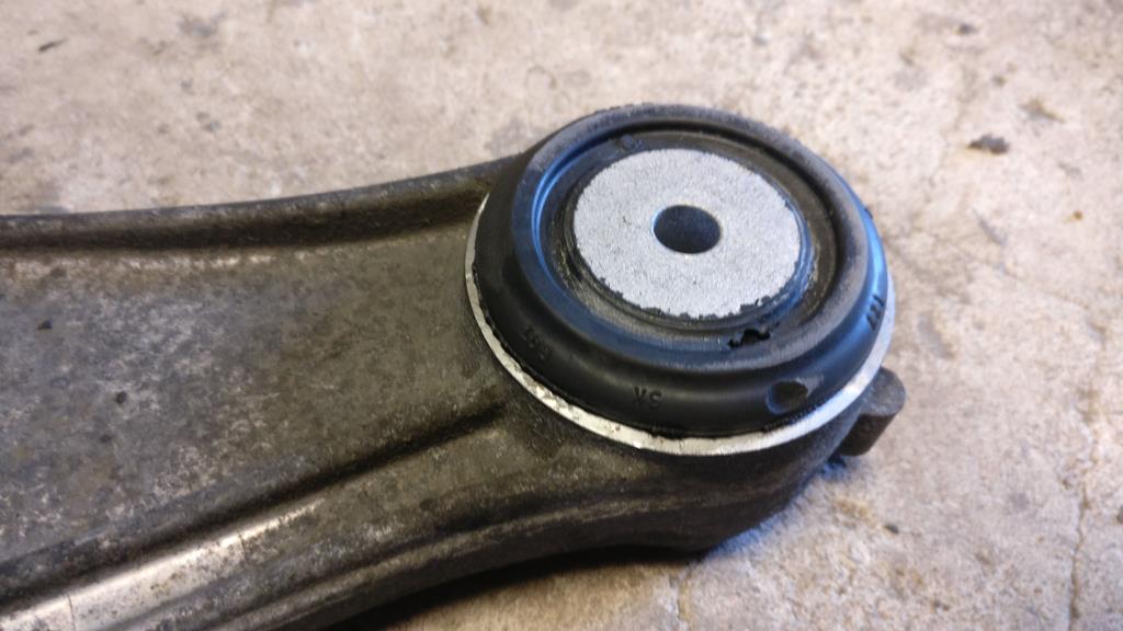

These are Febi, and as usual you can see where the Audi rings have been ground off post-production. Its actually an A6 part rather than unique to the D3 so easily available for £12 each.

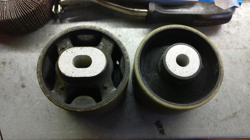

For reference, D3 forward diff bushing on the left, D2 original on the right. This is D3-specific and I couldn't find any aftermarket version, but its only £25 from TPS.
I can't fit this yet as I need to make a new press tool for it.
