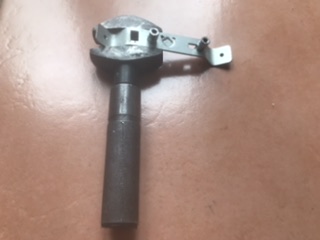

My main stumbling block was actually right at the start. The fuel sensor housing wouldn’t budge. After putting a pipe on my ‘special tool 2012A’ for more leverage a little tab on the cover broke and I was able to unscrew it until the two arrows met. Somehow the tab got jammed and wouldn’t rotate. Looks like only a part of the tab broke which doesn’t prevent the cover closing again.

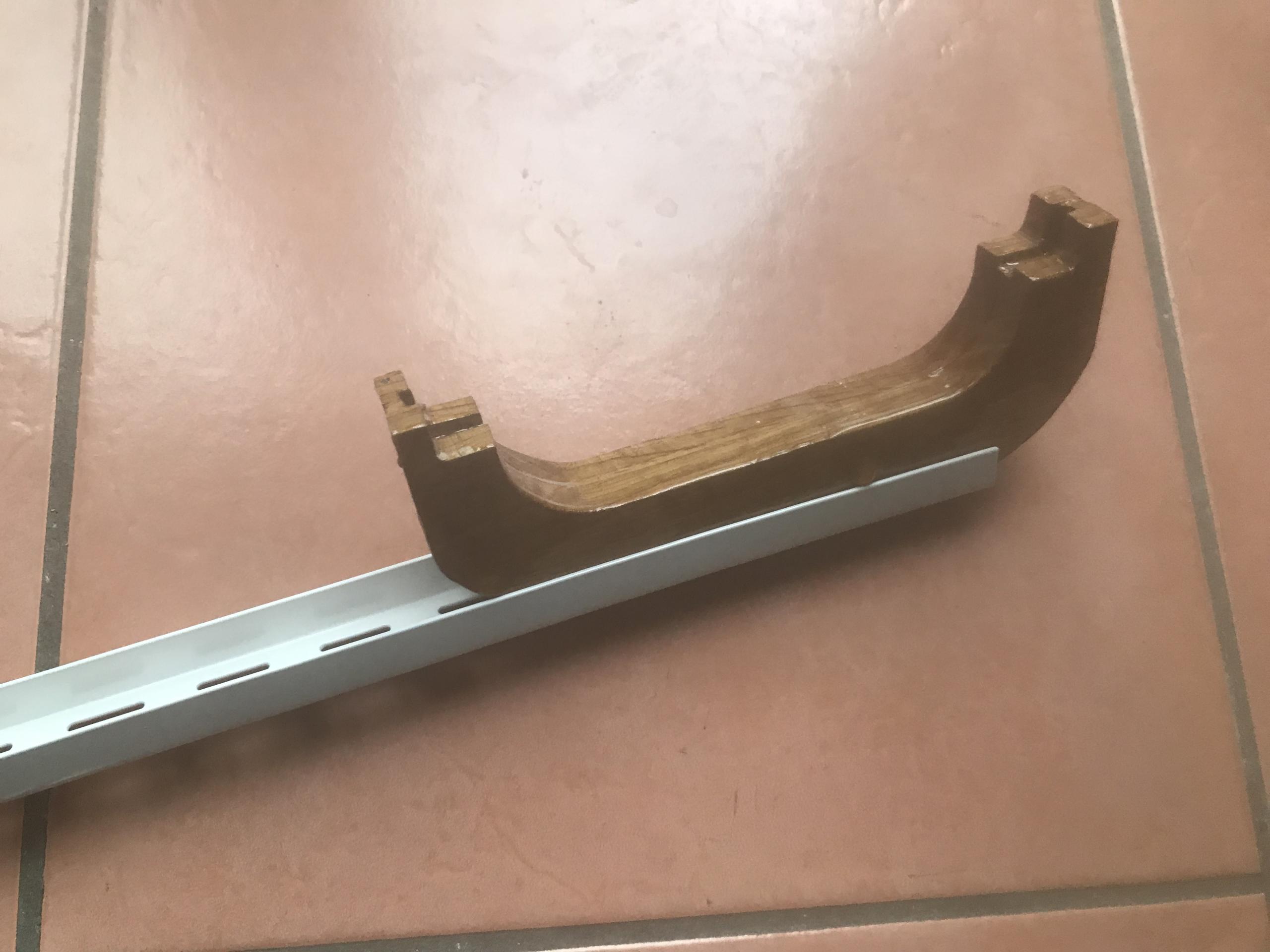

I made my own tools 2012A and 3342. 3342 I made out of two pieces of oak wood joined and coated in resin. Picture below. It worked a treat but one corner of it did break off, which didn't prevent it working.

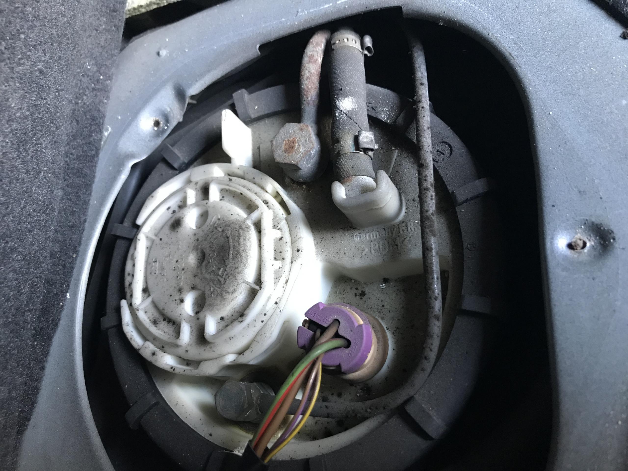

Luckily the long bolt wasn’t corroded and came out without a long handle or breaker bar. There was a moment of dread when it didn’t seem to rise up during unscrewing, but it just takes time and it slowly came out.
Taking out the pump housing wasn’t too bad. I’m not sure how much Audi’s instructions actually help. Turning anticlokwise by 45 degrees twice, etc. But eventually its easy to figure out how it wants to come out.

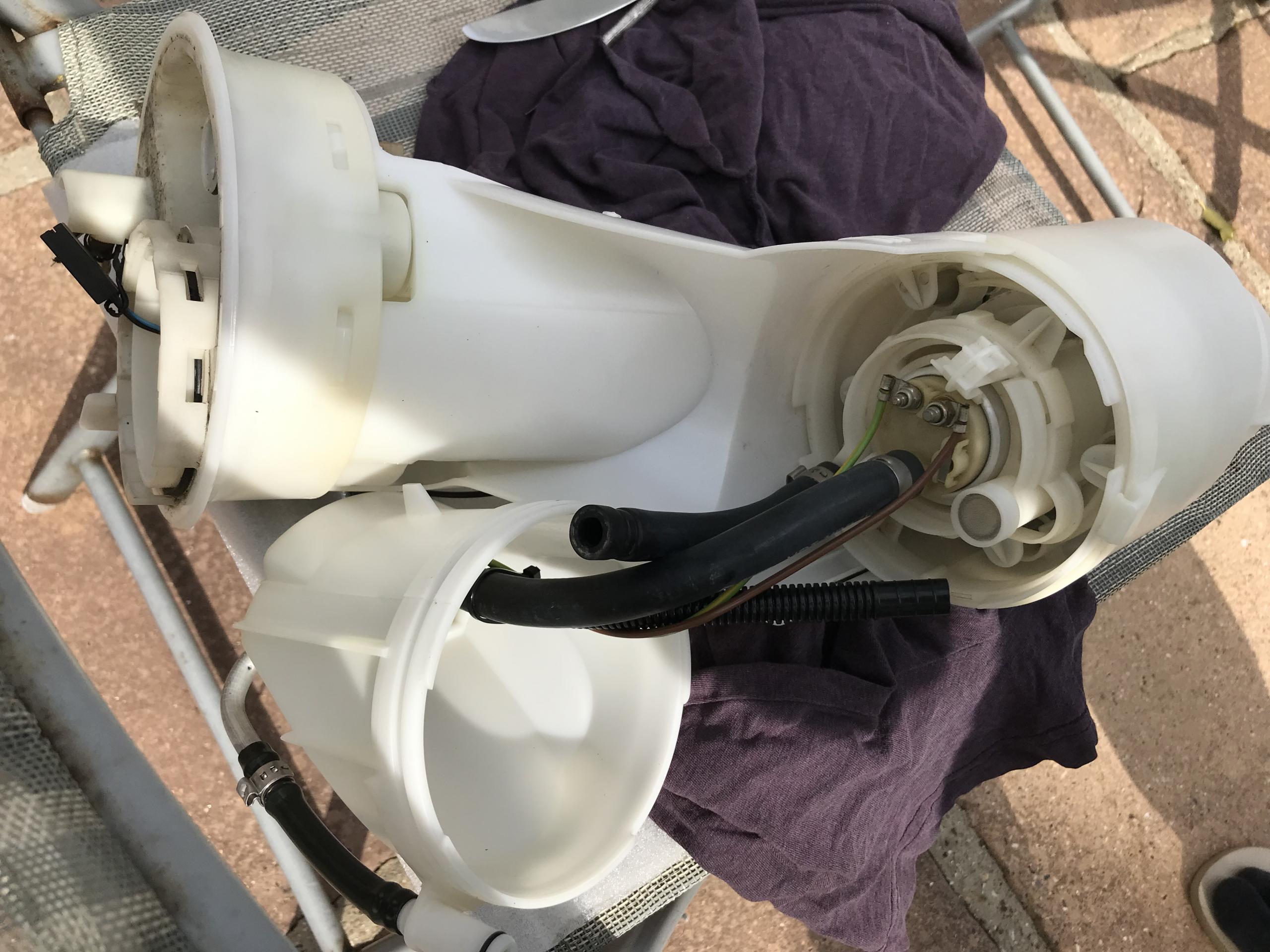

My other fear was the plastic housing tabs. Luckily they weren’t brittle, and didn’t need to be moved with any great force to separate the halves. The trick here I found was to move the two side tabs first. Lift the back of the housing up, then rotate it out of the front hook tab. Someone on youtube prized off the hook tab first with a screwdriver. I think this is very risky as it seems a lot of force is needed.

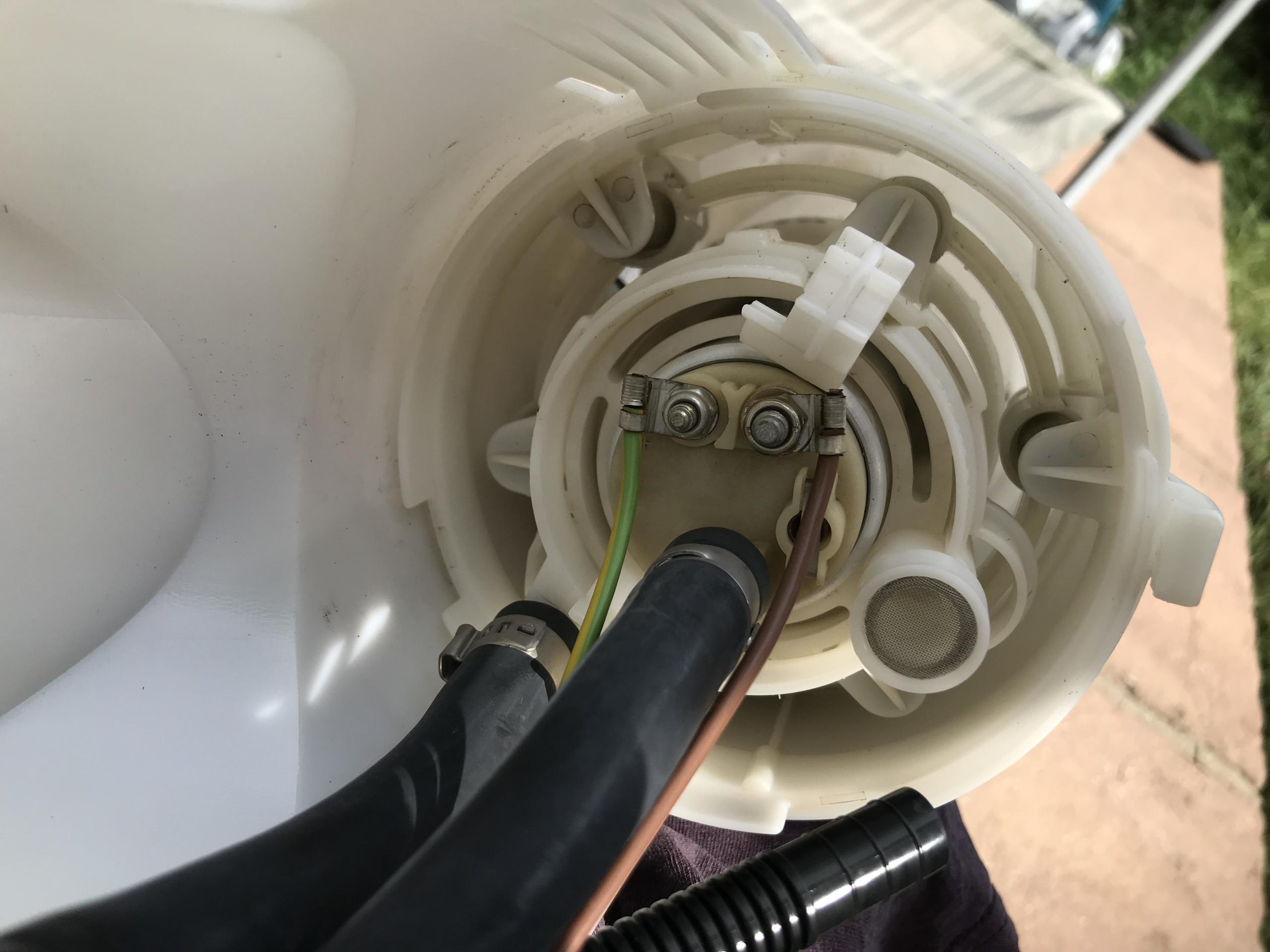

The fuel pump wires are a bit funny, on the pump body the + is where the green/yellow wire goes, the - is where the brown wire goes. Seems counter intuitive since brown is usually +. But I just put the wires back where I found them.

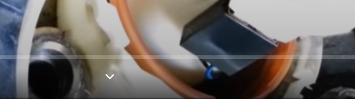

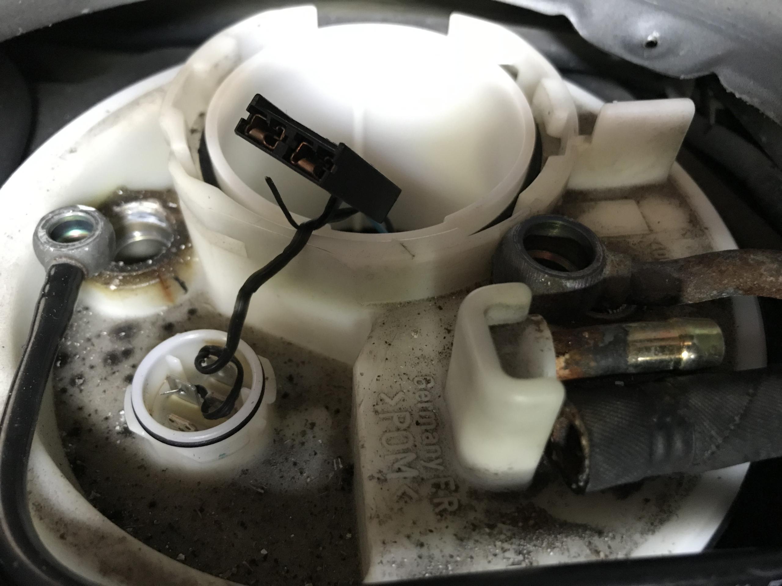

Does the polarity of this connector matter? I think I plugged it in the other way round. The wedged side outwards, smooth flat side inwards.
Although this guy in the video could have it reversed? (his wires are opposite to mine)
Damn should have taken a photo of it before unplugging.
*edit - I think I found the answer. In the same video there's a shot of the fuel gauge being removed. So I need to remove mine again and check the polarity is the same as here. I think mine is the wrong way round.

Its only a resistive element so its not polarised
As you say, the wiring does look odd when comparing with standard electrical wiring, where brown is live (+) and green/yellow is earth (-). The brown wire on Audi cars however are ground wires.
