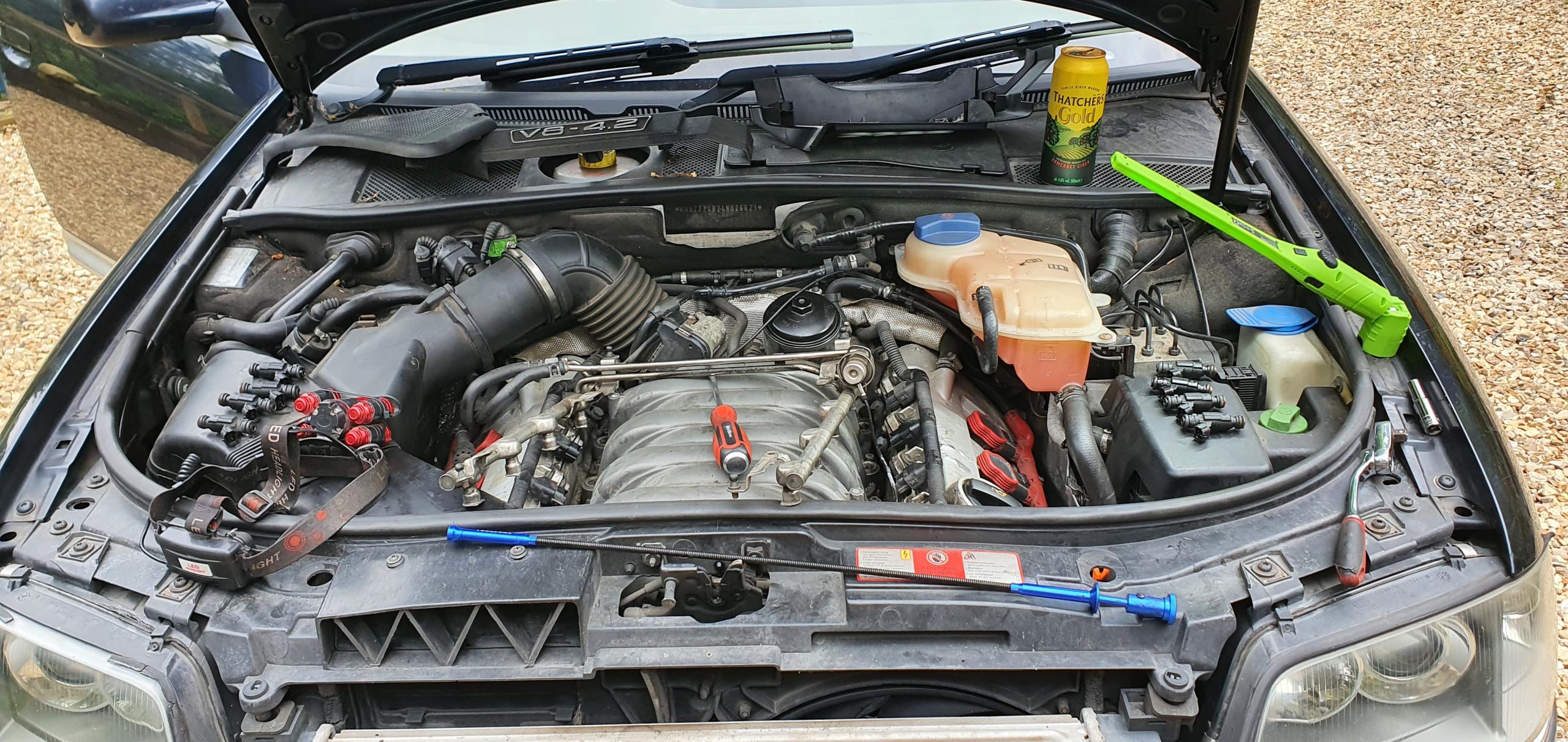

I was getting codes showing the offside bank was running either rich of lean to various degrees and having done a full service and changed the spark plugs, the next thing was a failing injector on that bank. I bought a second hand set of injectors from a D3 and had them cleaned and tested. All were within tolerance so I bought a refurbishment kit from Master Injector on eBay.

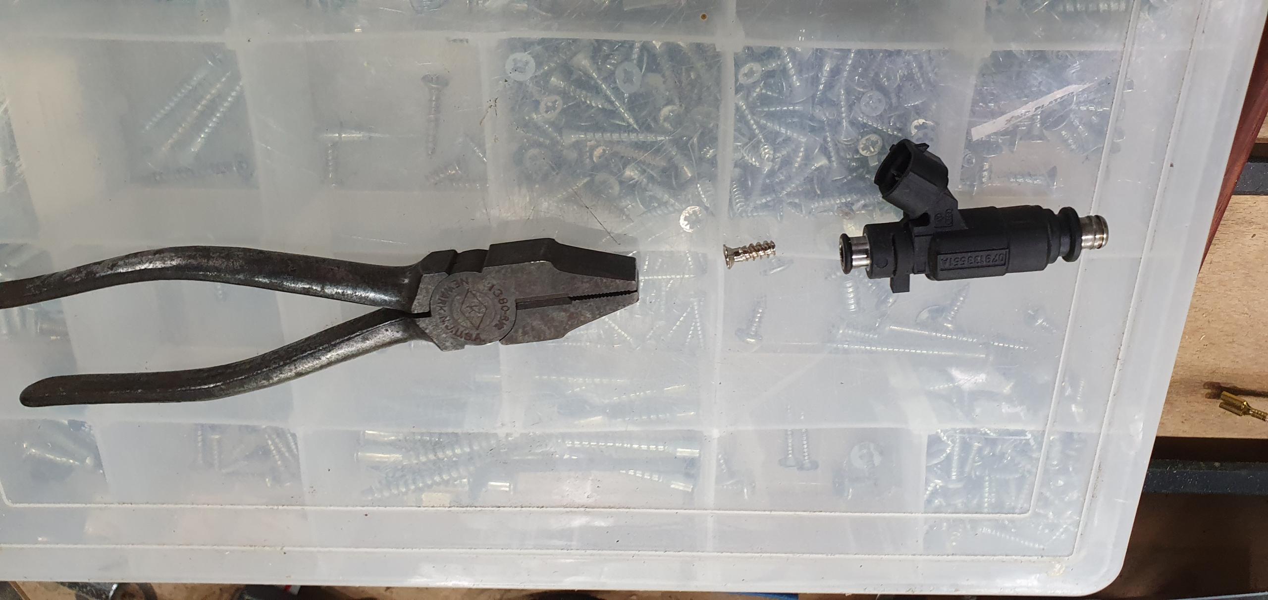

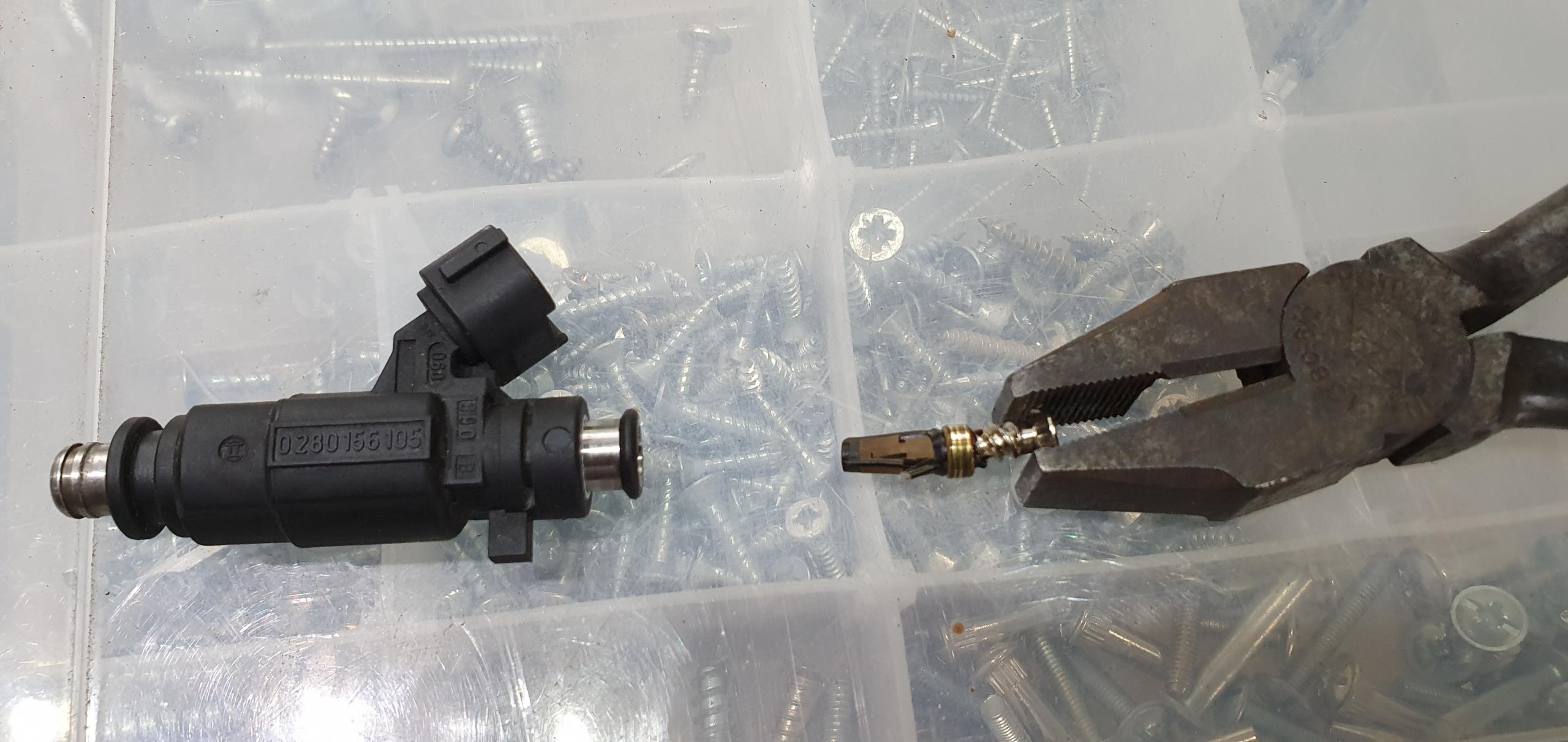

Next remove the old filter. I used a blunt self taping screw and pliers. Screw in to the filter until it just bites and pull the filter out with a bit of force and a wobble action.
Insert the new filter and gently tap it in until it's flush. I use a small wooden mallet.

Then reinstall.
