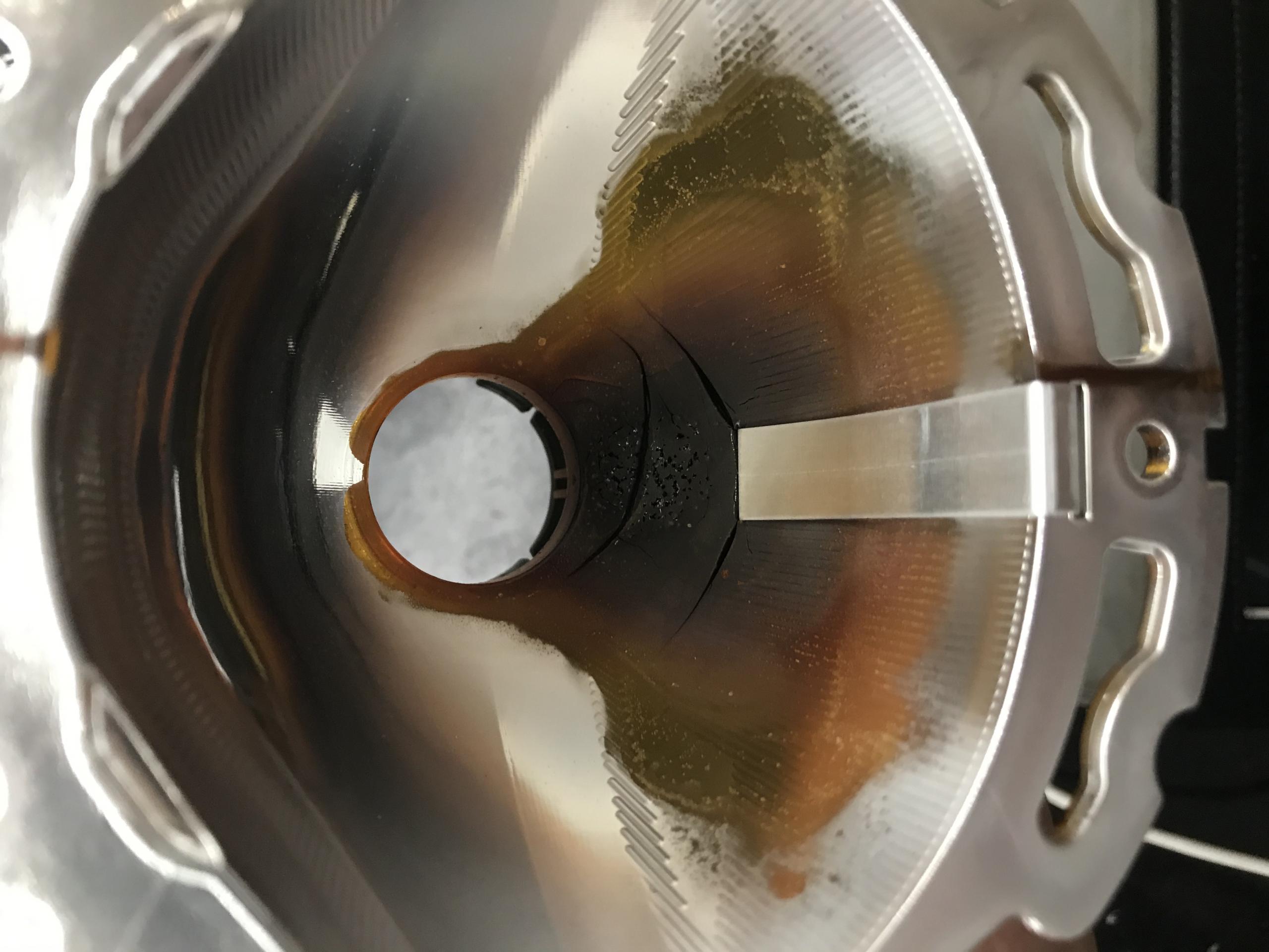

Old 9th November 2021, 06:26 PM
Zip's Avatar
Zip Zip is offline
Posts: 665
Thumbs down
This is one of the reflectors on my S4 Cab…
Dangerous.
Zip

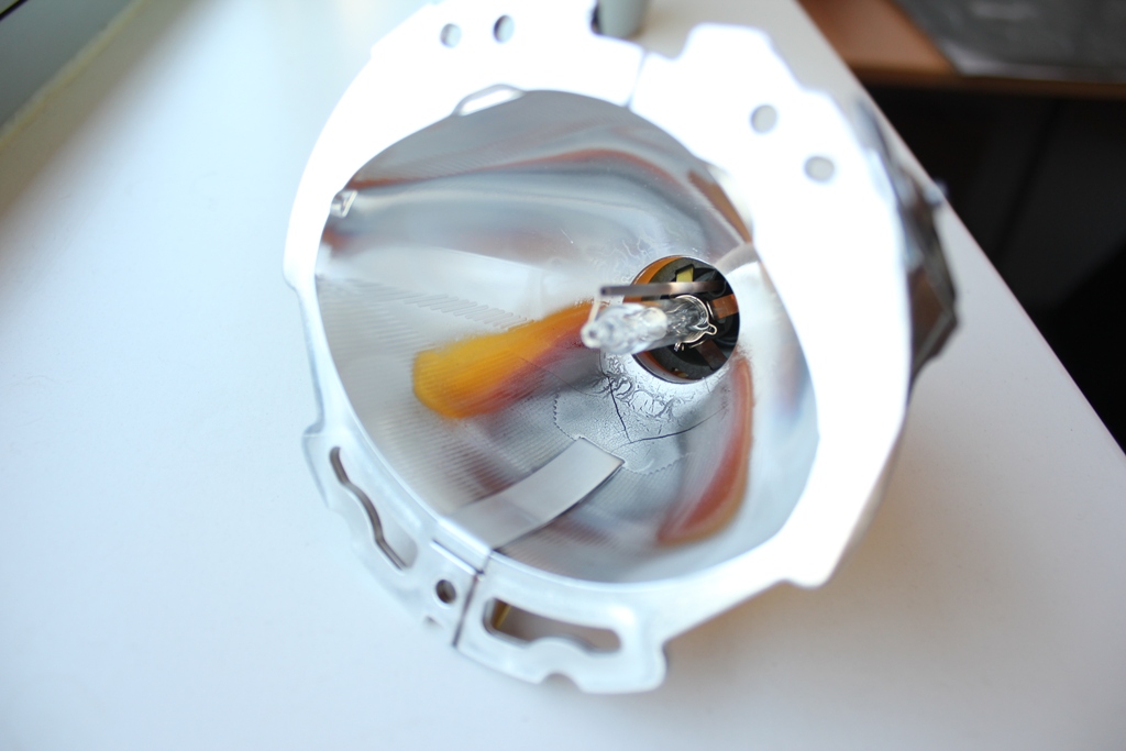

Old 9th November 2021, 07:30 PM
Join Date: Jul 2010
Posts: 1,317
Worse than mine, which were replaced when the car was 8 years old as they were like candles.....
I paid €400 plus shipping to the Netherlands back in 2013 for "new" bi-xenon projectors to be fitted to my headlights (also an S4 cab), but was literally like night and day afterwards!
