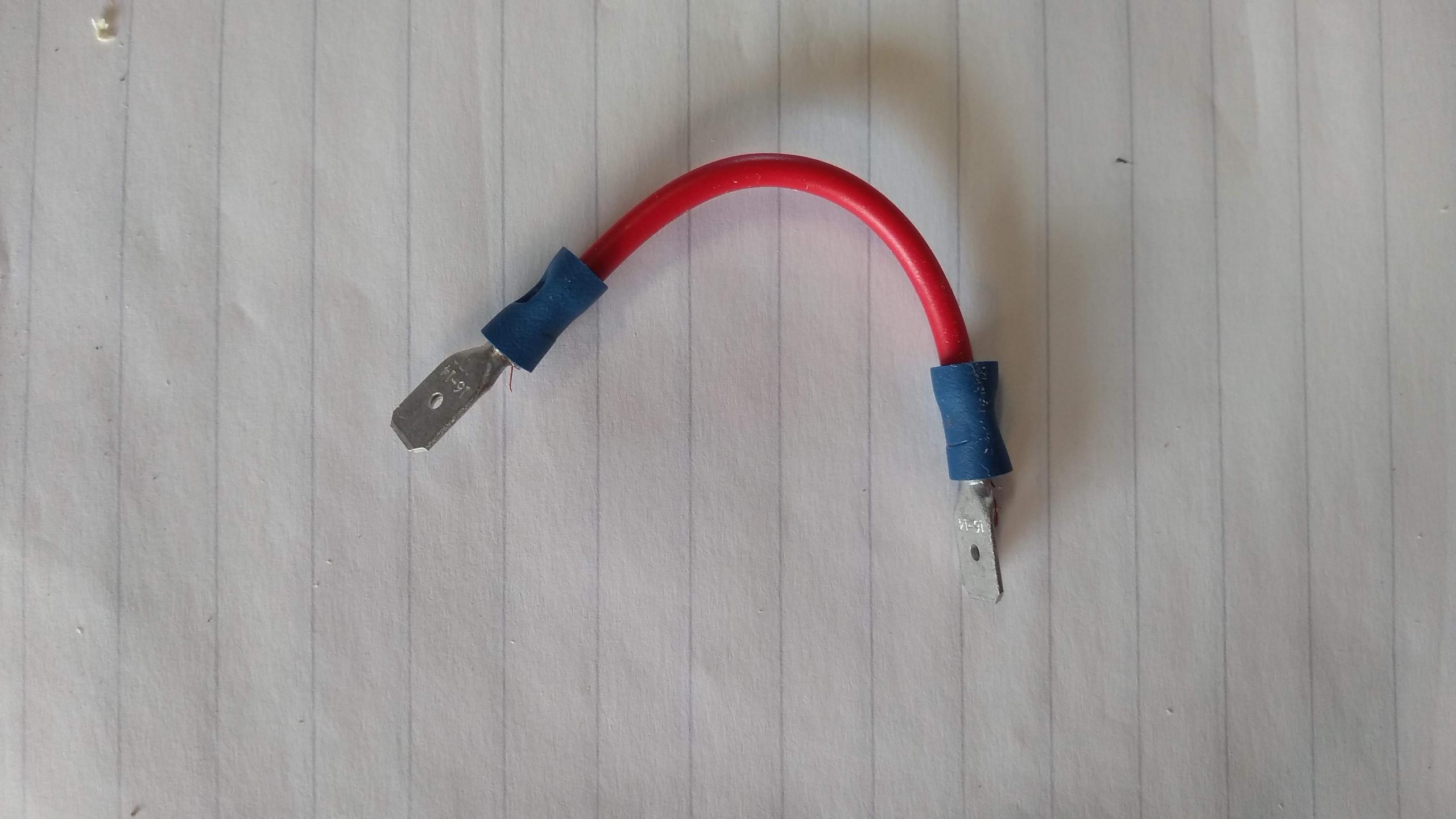

![]() Subsequent investigation a few days later and further discussion with MJ who talked me through the work-round which by-passes the relay which transmits the "I'm in "Park" " signal from the F125 which allows the starter to work. Basically, a short jumper between the terminals of the relay does the trick. The jumper is still in place whilst I figure out the way ahead with the F125,which given the cost of a fitting a new F125, might even be a permanent fixture!! Anyway, many, many thanks to MJ without whom we would be all be a much worse place. (how do you know all this stuff, MJ?? ![]()

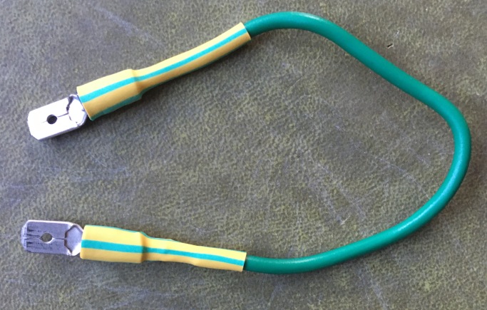

well, my repair was like something conjured up for a Hamlet cigar advert
![]() 1. Stripped out the passenger footwell carpet 2. Unscrewed the (aftermarket) access panel - apparently this one is not one of Sean's, but not OEM either, so not sure what Mark did here 3. Located the relay, gave it a wiggle 4. Just to check, tried to start car, and it started, no issues, weird - wish I'd tried this before wiggling the relay so will never know if the wiggle did a trick 5. Regardless, took the relay out, gave the pins a clean and burnish 6. With relay out, checked will not start - did not start 7. Attached a bypass wire to check the bypass would work - engine starts ![]() 8. Removed the bypass and refit the relay - check engine starts ![]() 9. All seems good so refit the relay holder, access cover and carpets. 10. Start car and reverse a litle up the drive. 11. Turn off car, then restart - does not start, WTF ![]() 12. Freewheel the car back to the starting spot on the drive. 13. Take out the carpet again, take out the cover, remove the relay and throw it in the boot 14. Reattach the bypass wire and test - all good 15. Reverse up the drive, turn off, restart - all good, bypass seems to be working 16. Back to working position on drive, refit cover carpet etc 17. Start car- all good, drive into garage, turn off 18. One more restart for good luck, all working ![]() So, I am hoping that the bypass does the trick for the medium term, but clearly I need to get the F125 replaced, and it's not a job I intend to DIY. Fingers crossed she starts up when I go the gym tonight. Net result, I now have the bypass fix in place and it is working, for now at least, and I now have a broken rear tow hook cover as it was so old and brittle, the clasp broke trying to get it off to get it winched onto the AA man's flatbed ![]() |
