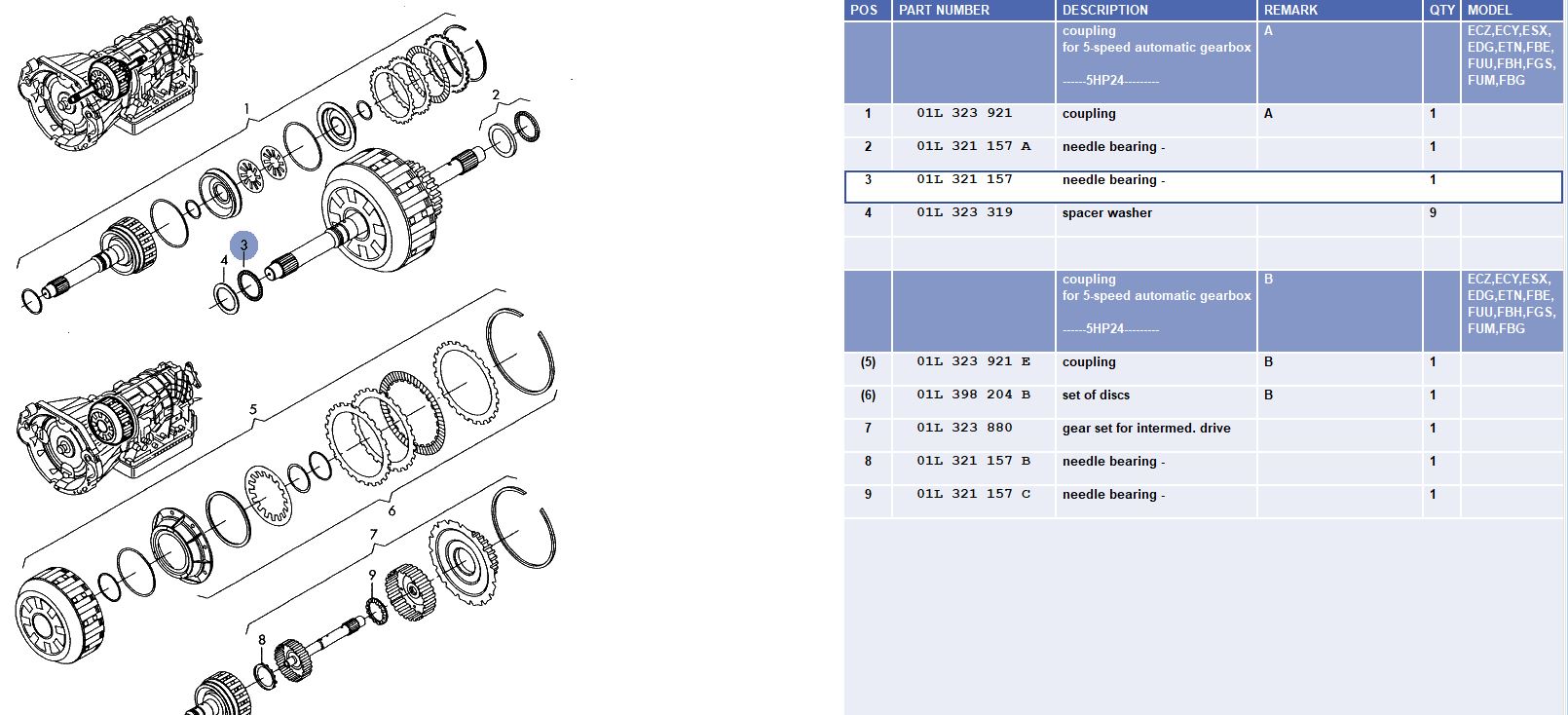

Hello I have now bought the used transmission and also the transgo valve upgrade and also an upgraded A clutch basket. This first roller bearing you mentioned which bearing exactly is this? Do you have a PN or some source for it? I’m thinking I will just go ahead and buy one since when I start disassembling the gearbox I don’t want to get stuck having to wait for shipping incase something requires replacement.

this one:
There's an upgraded part from ZF compared to what was originally fitted. If you can find the ZF parts catalogue for the 5HP24a (its on the web somewhere) you can find the ZF number for this instead of the Audi one.
