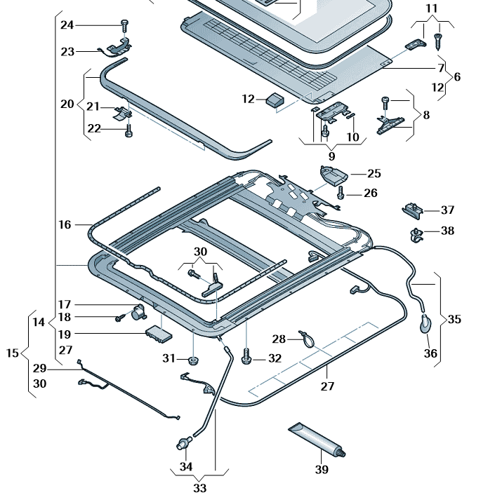

Looking at replacement roofs the D4 one looks very similar - can anyone confirm I can use that ok on the D3?
Old 19th February 2023, 05:21 PM
Posts: 3,233
They do appear very similar, but there are some very slight differences. Size is probably the same, but no way to confirm it other than a side by side comparison. For reference, on the D3, there are two versions available, 4E5877049, which is a normal sunroof, and 4E5877049A, which is a solar sunroof, so there appears to be a difference there as well.

Name:	A8 D3 Sunroof 4E5877049.png
ID:	29272   Click image for larger version
Name:	A8 D4 Sunroof 4H0877049A.png
