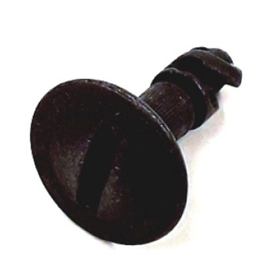

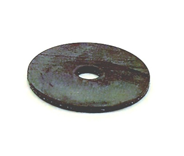

The last time I had the front undertrays off on a D3, there were nine grip pins (3B0805121) and nine rubber washers (4A0805137). From memory, the grip pins screw into metal fixings. Perhaps someone with a D3 can confirm before you buy them.
Name:	A8 D3 Grip Pin.png

Name:	A8 D3 Rubber Washer.png

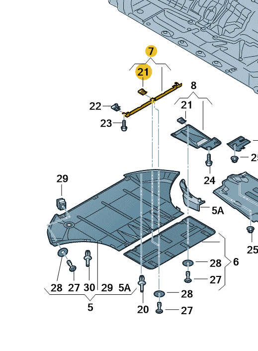

There is a metal bar that helps support where the two undertrays meet. #7 in the attached image. That is where the metal clips that AlHeart mentioned go.
