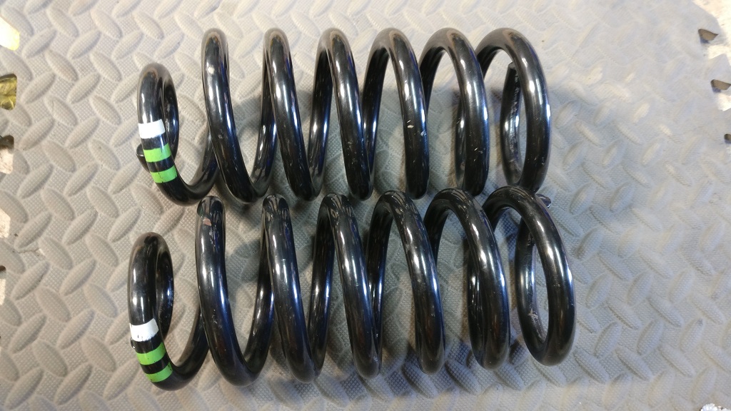

4D0511115AN
2 green paint marks and 1 white.
Old 4th June 2023, 11:03 AM
Kinda like these which I have in the workshop...
Or still available from Tradition via Prestige if you want new ones.
