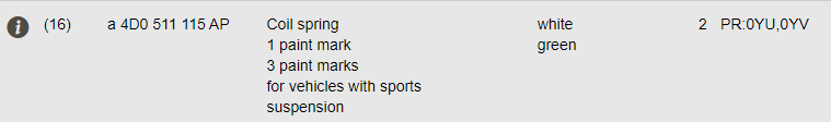

For the sports suspension with a 0YU or 0YV PR code we're looking at the 4D0511115AP as mentioned above with the 1 white, 3 green paint marks (always worth checking the colour and number of marks on the car I guess if you don't mind getting on your hands and knees).
The BE suffix is not noted for the sports suspension
But as mentioned, I'd always defer to someone like MJ who works with these things rather than trust my own judgement.

Spankers is right, the part number ending in AP is the right for your car
