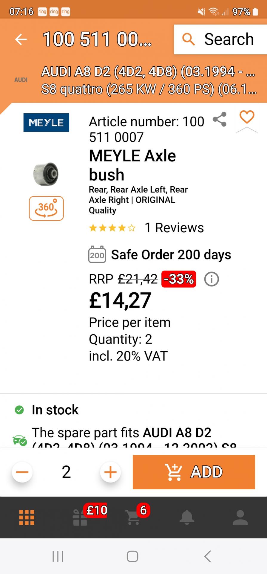

Unfortunately if you want to keep this car running long term then you are going to need to do a lot of research. The whole "no longer available" issue is really problematic. Not just in the suspension but in every area. Whatever problems you have next (and you will), you'll be all over the Internet looking for parts. That said I found these within 30min of looking this morning.
I'm not saying that they are 100% right, you will need to do more research but they may be some of what you need. Or at least they may make do.
It took me 6 months to find all the parts I needed to do my rear end rebuild.
If I were you I'd think very carefully about going down the road of owning and running a D2 S8. Time, money, research and patience are now essential parts of ownership.
Take a look at the pictures.
